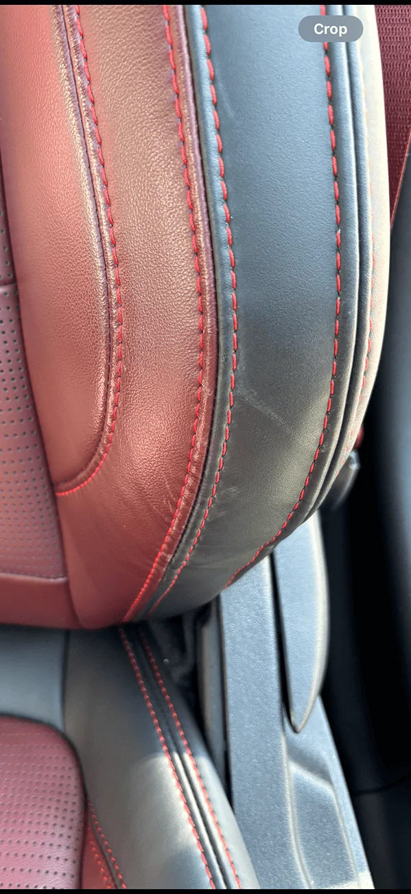

One thing that might come into play is how you enter the car.
I stick my hand in and guide myself down.
If you stick a leg in and drop on the seat, for sure you'll rub/scrape all the way down.
Might be doing it without even thinking, but it's a low car so that would be something to consider.
If it was simply what you're wearing, it would show up on both sides. This, to me, looks like entry method.

After three months of ownership, I'm VERY disappointed in @Ford Motor Company 's poor choice of 'leather'. On another social media platform, the complaints are quite frequent. I wear khaki's and jeans daily for work, gym shots on the weekends (nothing at all that is abrasive) - there is no way the "wear and tear" should be this abysmal on the driver's seat. I can't fathom how bad this will be in three years. Anyone else having this issue?
Are you a concealed carry left hander? Those look like some pretty abusive wear marks with what looks like a rip on the upper right. Not normal wear and tear from entering/ exiting a vehicle in only three months time. Are you wider than the seat and fall into it, because they look like downward wear marks instead of what you'd see if you were sliding in/out of the seat.

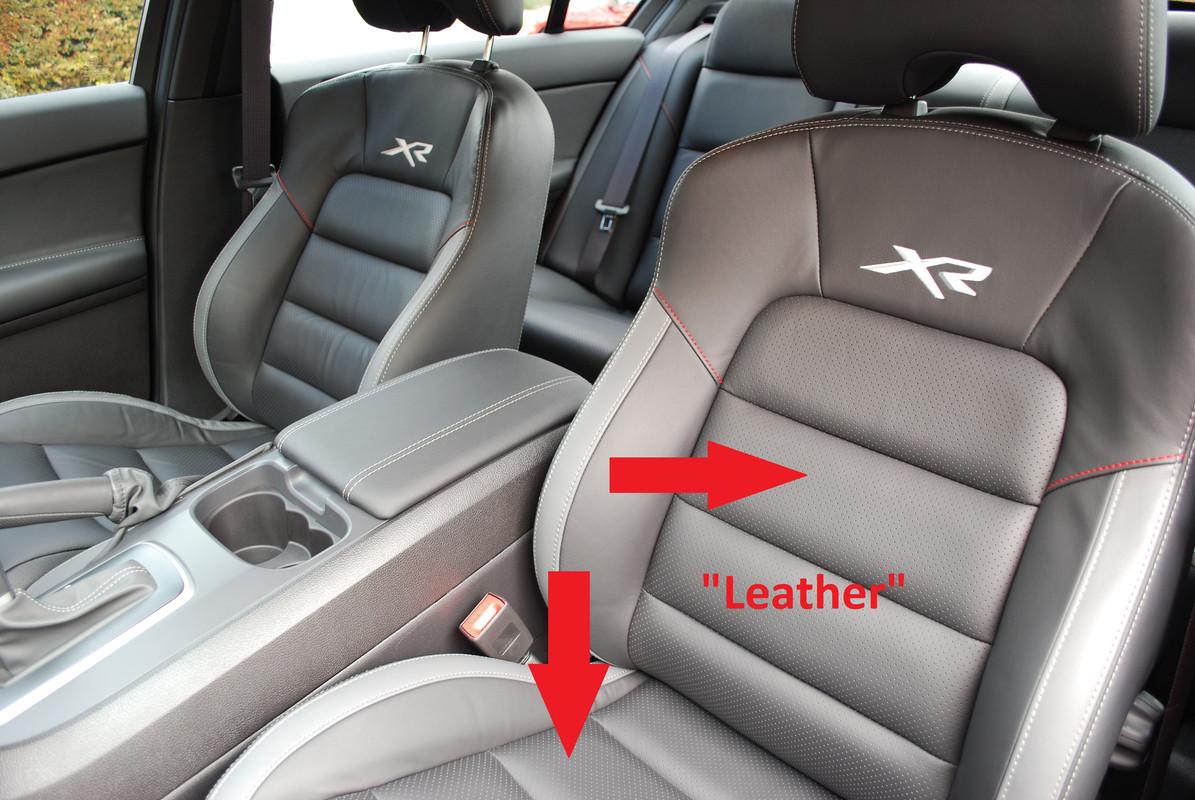

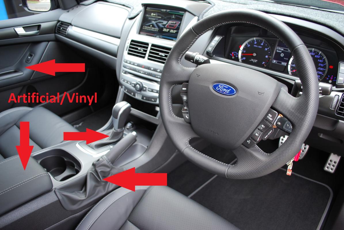

This is very much an abrasion issue.
A couple of notes after reading through this thread -

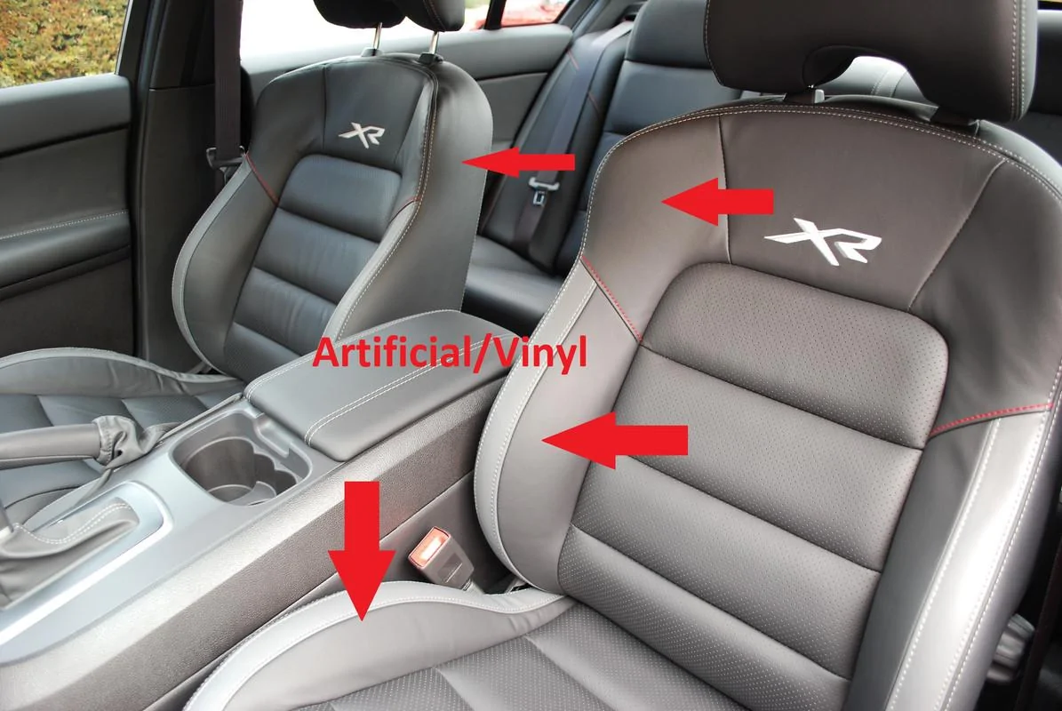

- As others have mentioned, the actual "leather" part of the seats is the perforated sections. The rest is vinyl. This is not unique to Ford, every car company does it, even Jaguar.
- Not a Mustang, but the concept is the same, these pictures show what is leather and what is vinyl.
S650 Mustang Leather Seats art-Ificial101
S650 Mustang Leather Seats art-Ificial102
S650 Mustang Leather Seats leather101

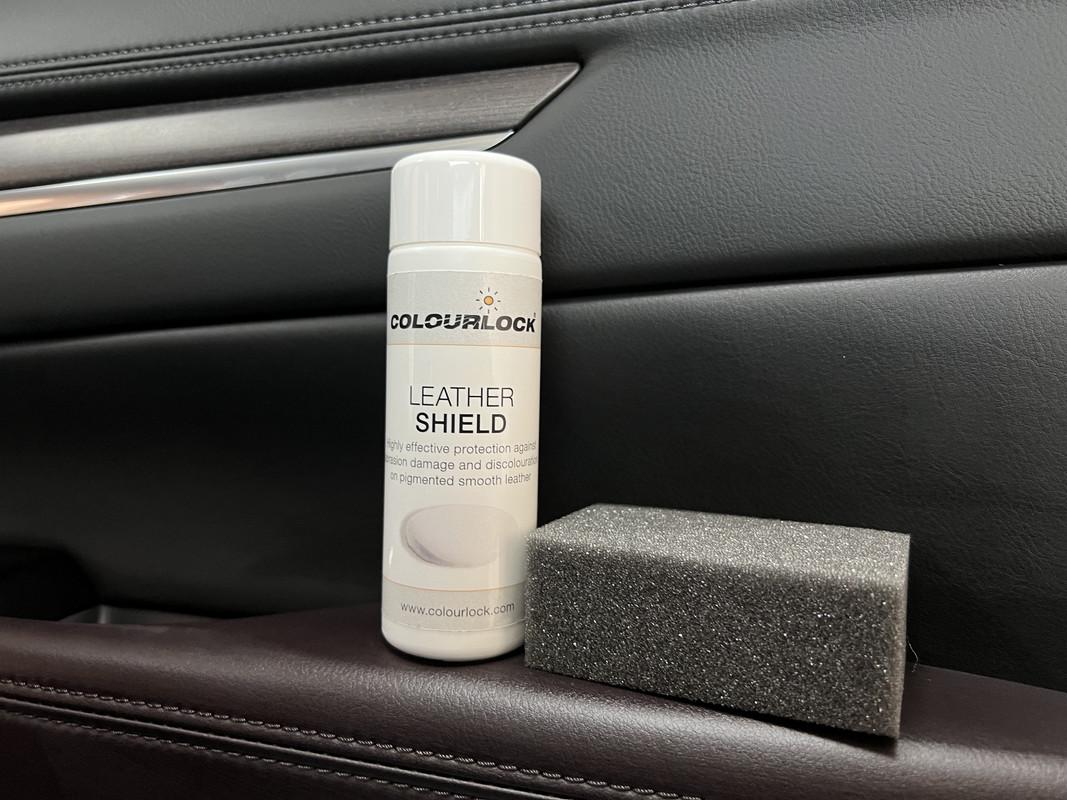

- To repair this issue is actually pretty simple, you just need to be patient. I'd look into ColourLock Leather Fresh, which is a product the re-applies the dye on those damaged sections. Plenty of videos on Youtube of this being used.
Ford - Leather Fresh Dye | black | 150 ml | 11008-us-FO-004 (colourlock.com)
- ColourLock also make a product that protects against abrasion during the first three years of the cars life. Leather Shield is super easy to apply and helps limit dye transfer and abrasion. Apply every 3-6 months depending on vehicle use. It also doesn't leave a hideous oil slick behind compared to a lot of "leather conditioners", clean and protected leather should never be shiny.
Leather Shield | 150 ml | 11012-us (colourlock.com)
S650 Mustang Leather Seats IMG-4205
All good points.
  • Conceal carry on my right, so that's not it. That side of the seat is perfectly fine.
  • The part at the top right that looks like a rip is actually a thread coming un-stitched.
  • I'm about 6 foot and 220, so I'm not small...but not wider than the seat.
  • I have the option enabled that puts the seat all the way back to make it easier to enter/exit the car.
  • I wear jeans (no rivets), khakis, or gym type shorts - none of those should be damaging this material.
I'm headed to the dealer this morning, so we'll see what happens...
