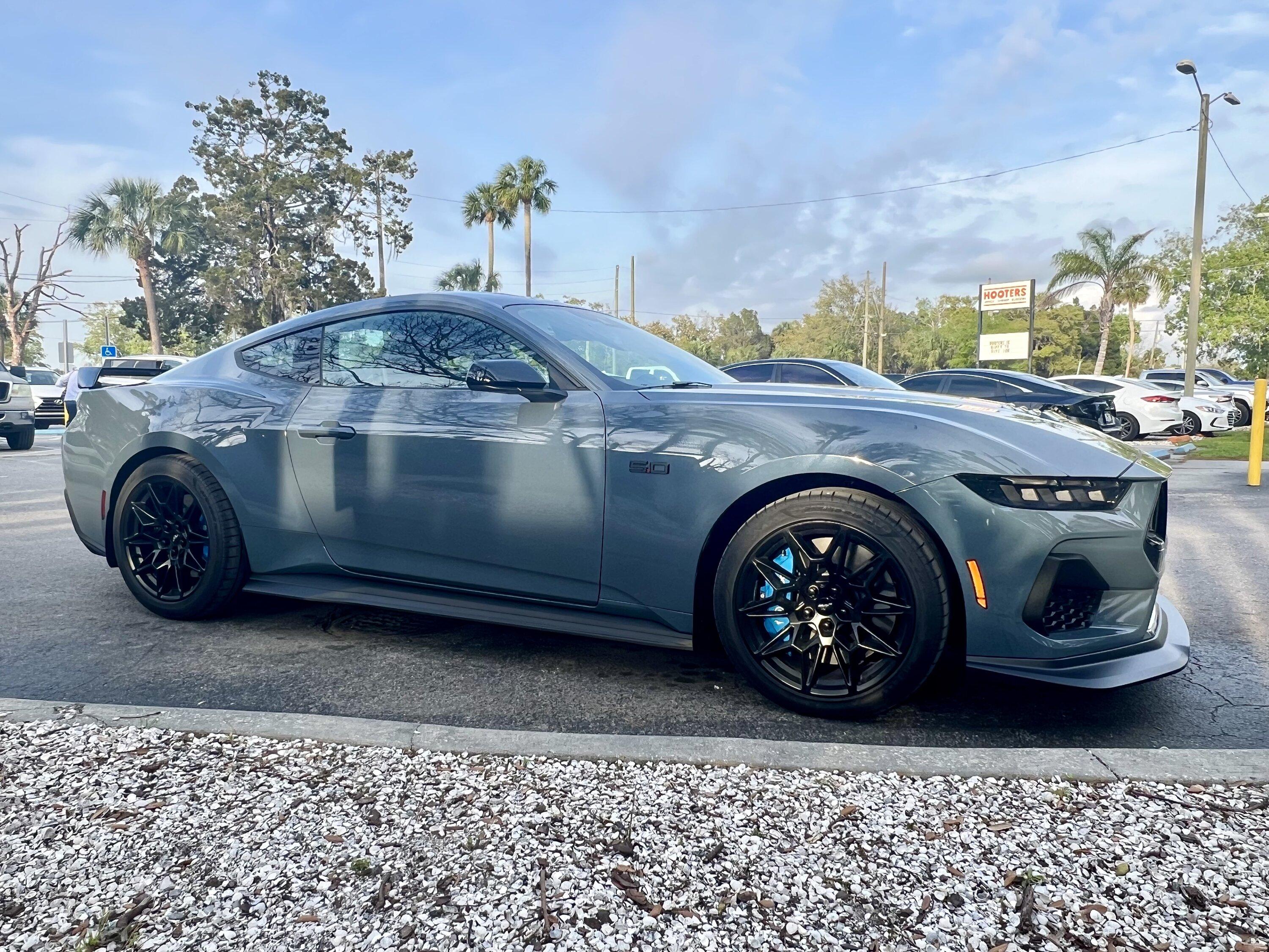

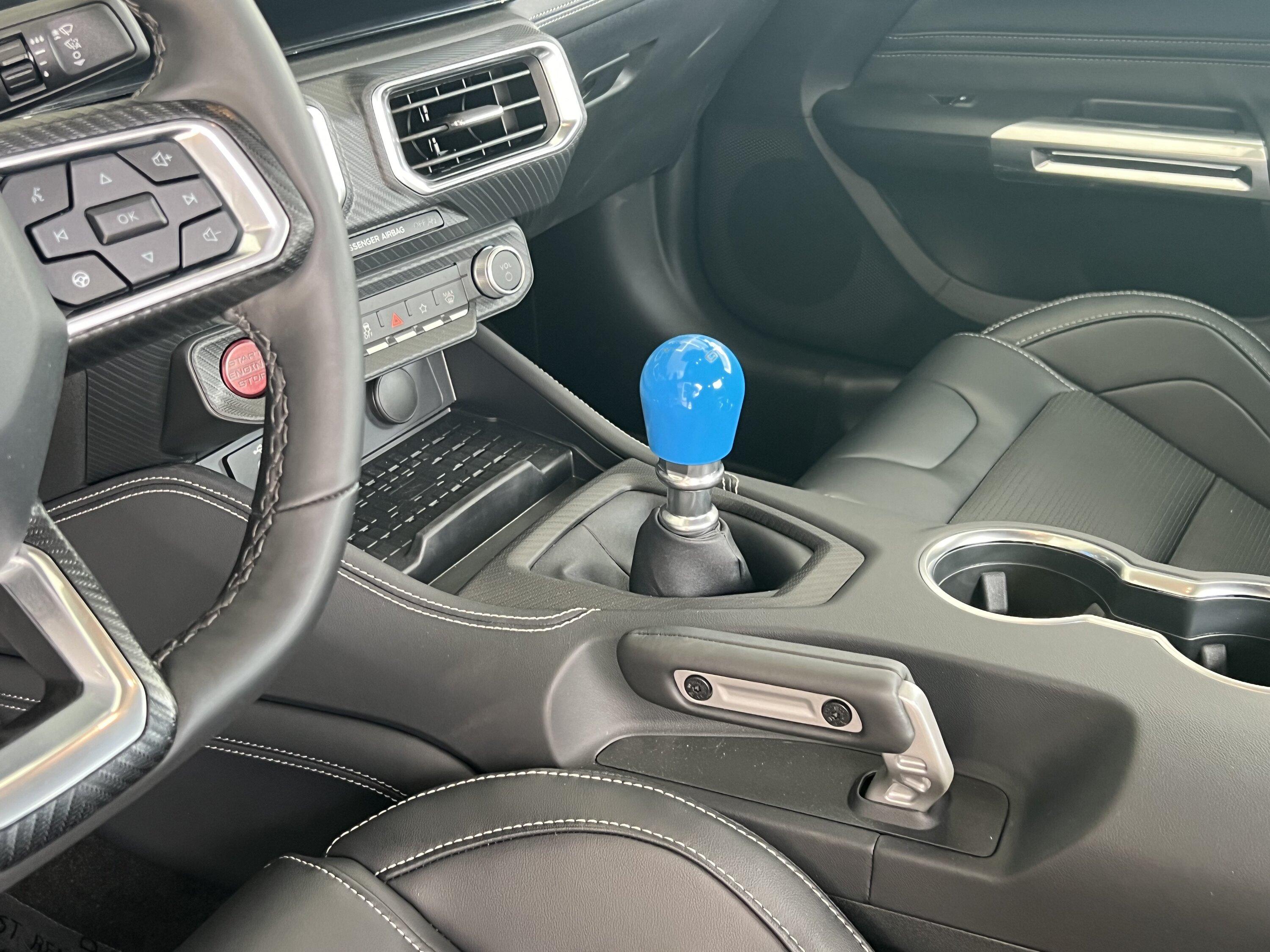

Mods done today…Steeda jacking rails, UPR catch can, Billetworkz weighted shift knob, OCD plug screen protector, 25mm spacers on wheels. Will use spacers until wheels come in. Then they will be for sale for someone else.

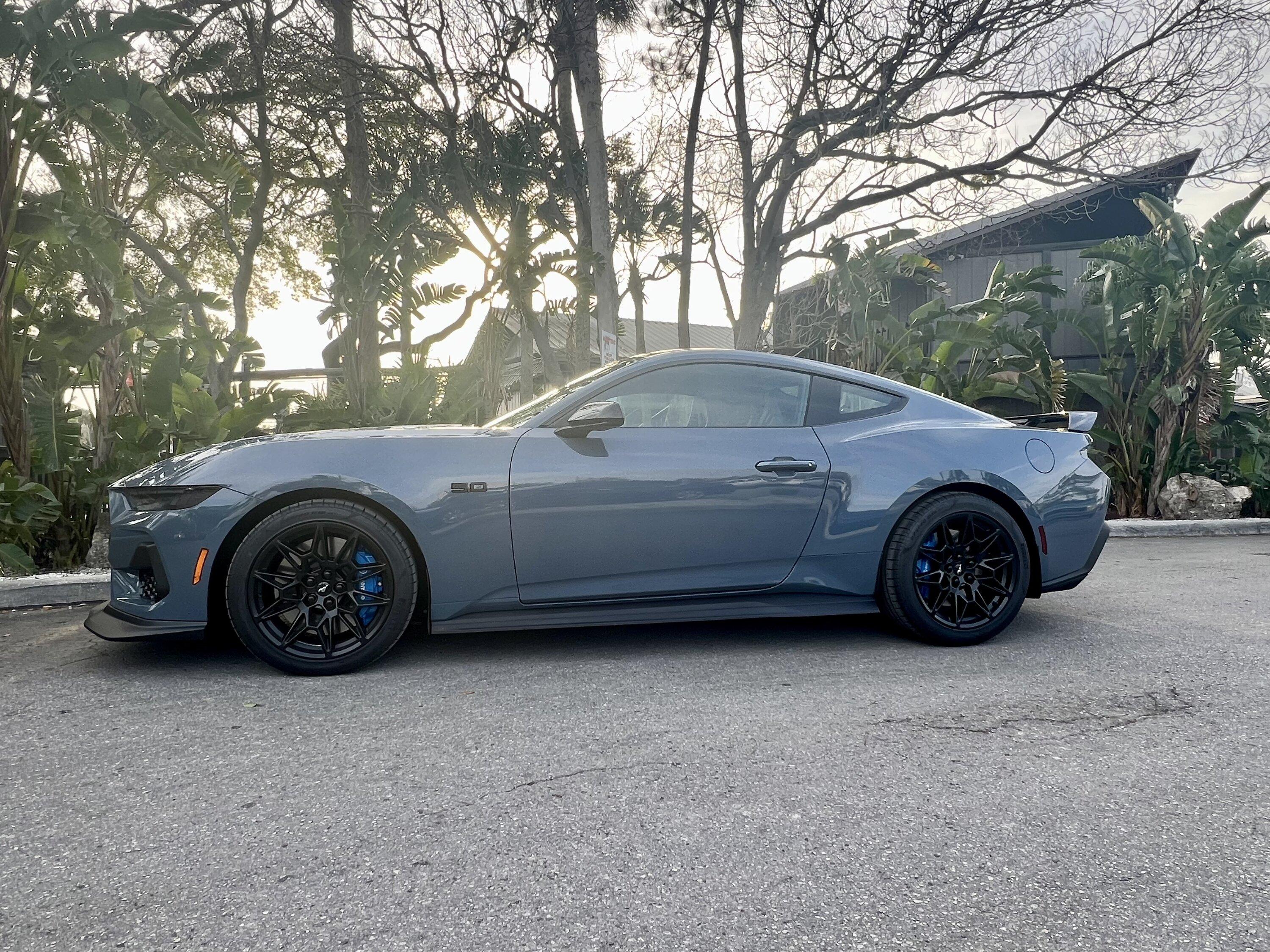

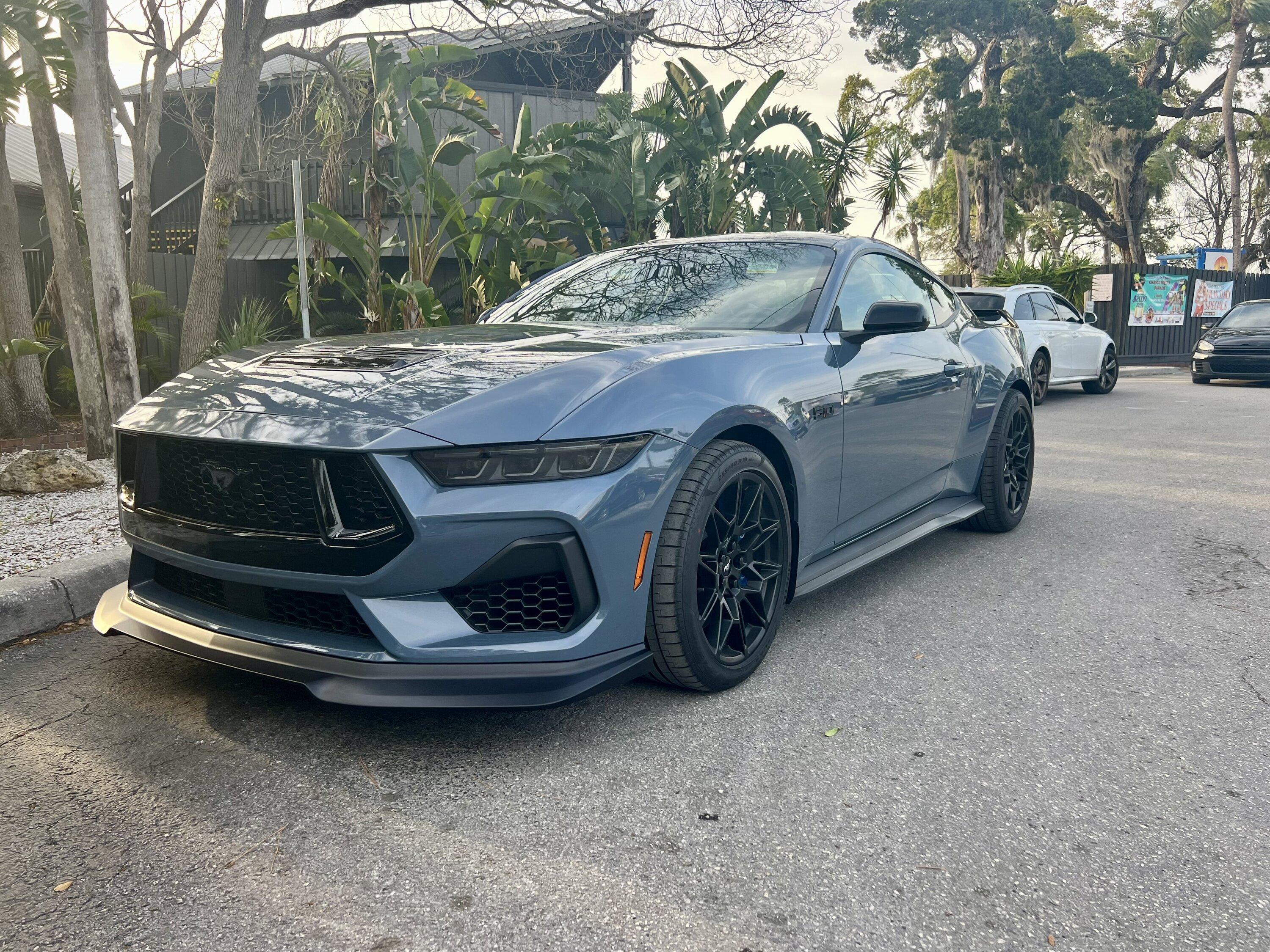

Todays mods. RTR chin splitter with under tray extension, side rocker splitters and rear quarter splitters. Not the greatest pics. Will get better ones when I have time. @RTR Vehicles

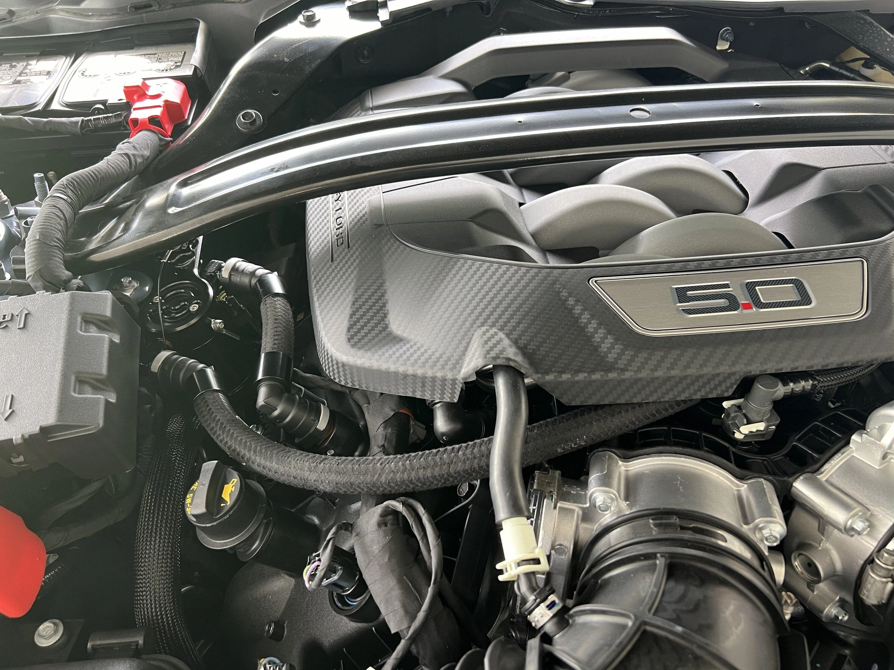

From the photo, it looks like you installed only the "dirty" side catch can. You don't think the "Clean" side is necessary?
Where did you buy it? UPR prices are up there. Lethal Performance seems a lot less.

Bought from Lethal. Dont need the driver side really so with the price I decided not to get it for now.

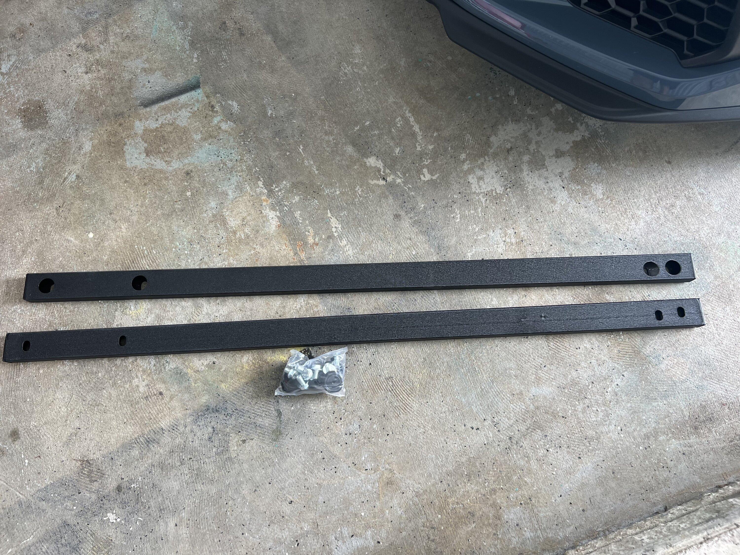

Jacking Rails: How much material did you have to cut out on the "belly pan" to install the jacking rails?
Which Lethal part number did you use? 555-5205?
I got the jacking rails straight from Steeda. Not much. There are youtube vids on install.

OK. Full Length. The Steeda video doesn't address the S650 belly pan parts that need to be cut. CJPonyParts video DOES address this, but only for the "Low Profile" jacking rails.
What did you have to cut out?

I used the same ones, you put it in place and mark it, I'd say about 1.5" wide and 3" long, it was very minimal.
That’s what the CJ video suggested. The Steeda instructions say to remove the panels and then cut.

I trimmed mine in place with a utility knife with no problem, just held the bar up and secured it with one of the rear bolts while I marked the pan. Not sure why they'd want you to remove the pan.
