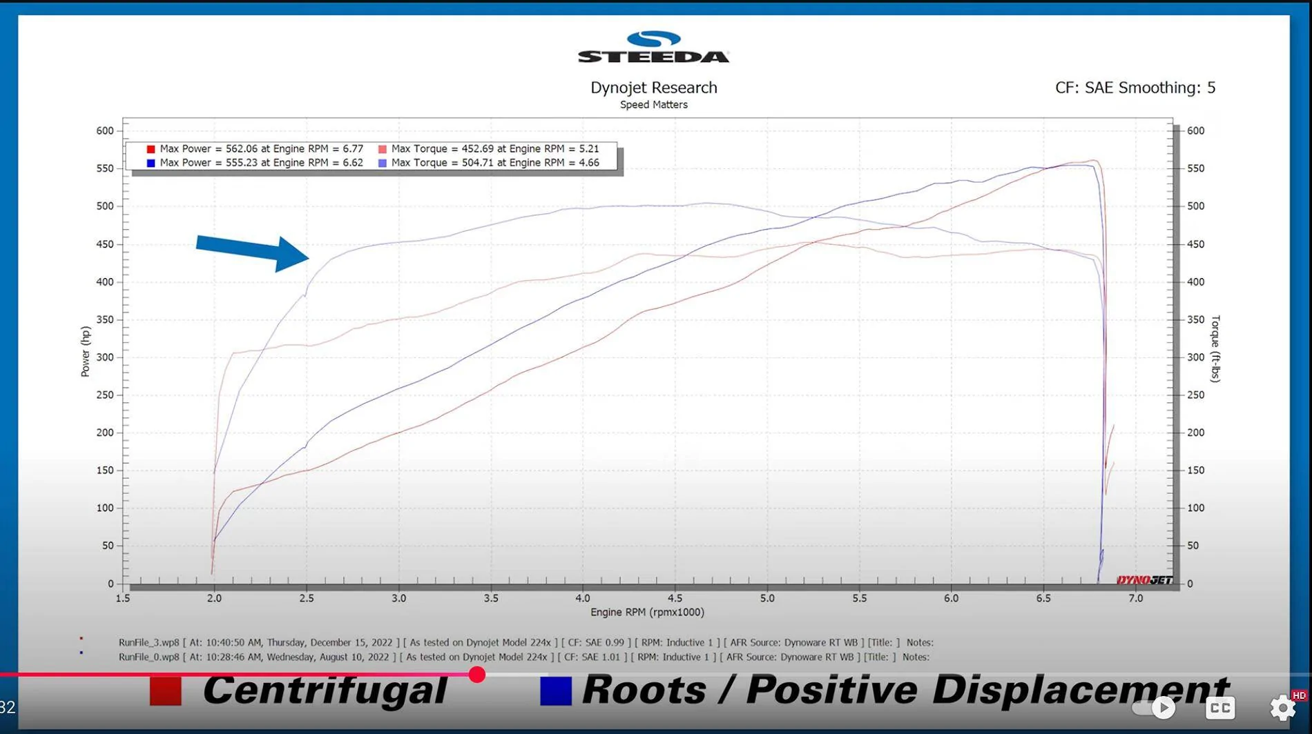

I've heard that the gains from a procharger are better under high rpm. Does that mean when you rev out, say 1st 2nd 3rd gear you would see a big increase when you are above 5k rpm?
Centrifugals build boost with RPM. They make almost none at lower RPMs. TVS/Roots/Twinscrew will make almost max boost at any RPM.
5k and up you're fine but you will feel the difference down low.
S650 Mustang Helion Turbo, Supercharger (Roush, Whipple, VMP), ProCharger stats, price, vids, etc Screenshot 2025-07-23 at 11.47.03 AM
Wow - it does not surpass the Roots blower anywhere until after 6500-6600 rpm
"5k and up you're fine," well, yeah, fine, I suppose, but the graph shows a 100 horsepower loss at 5000 rpm!
And depending on your application this can be a better setup. If you don’t want to break traction with a sudden burst of boost, but would rather build power liberally, Centris are the way to go
LOL, my first car had a redline of 5,500.
My Pontiacs were 5200.
I have built engines where the redline moved up, a small block Chevy to 7,000, but it broke, so maybe that was too much . . .
It is still wild to me that this engine runs at such high rpm.
I hear what you are saying. I never know whether that hypothetical is true, though.
Maybe with the very close ratios of the 10A it does not matter much? I don't know.
