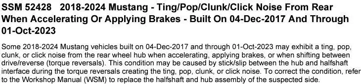

Could it be if you park on a hill and set your emergency brake?
When you release your emergency break and then put it in reverse, it has to catch up.
If i’m on a hill, I put it in park. I let it roll back a little bit. Then I set the emergency break with no pressure on the transmission.
