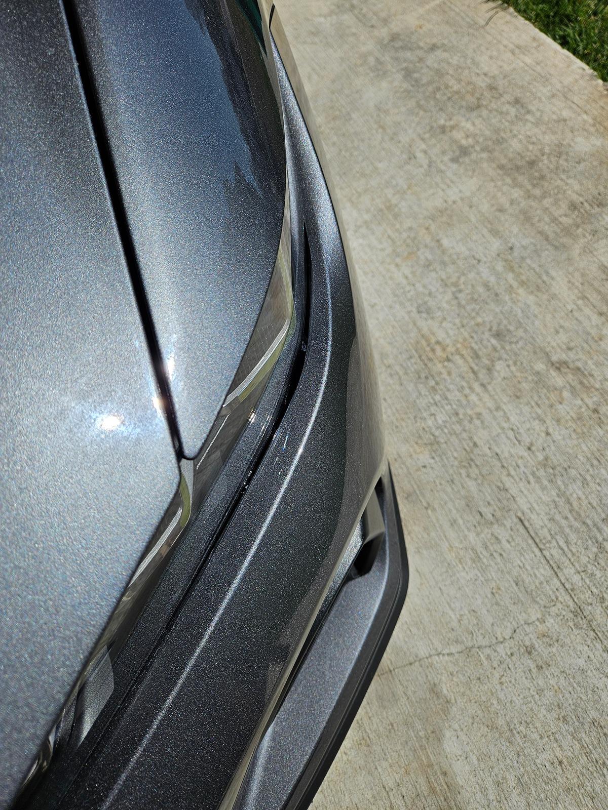

Okay, my dealer told me that's just how it comes but I just had to open my hood, remove the 8 plastic push pins holding the plastic plate by the latch that says "mustang", you're going to see 8 bolts holding the top of the bumper in place, loosen those 8 bolts and adjust the top of the bumper enough to reduce the gap by the headlight. I have the before and after. I think some bumpers come a little too big from factory but you can make it look better.
Just tried this and it pushed the front bumper cover far enough forward where the hood seal had a big gap..closed the gap between the headlight and bumper though, lol! I’m just gonna let them change the cover I suppose. Perhaps there are some that got manufactured out of spec.

So took a trip to the dealer today and they have a full time body shop that looked at if for me. Basically they say it's a poor fit and unfortunately 'normal' and the sales guy showed me the 3 Mustangs he had on the lot and all had the gap. Some were much worse than mine. They offered to replace the bumper but it would have to be painted so I declined. I'm going to try the method Turbodre1 performed and see what happens. The rest of the bumper is 100% perfect so I'm a little hesitant to touch it..

Im in the same boat. I tried the method above and the only way to fix the gap is to pull the bumper out and that increases the gap between the front of the hood and hood seal. My driver side rocker plastic panel doesn't fit correctly either, big gap in the front. Going to have the body shop just fix it all even if they have to paint a new bumper.

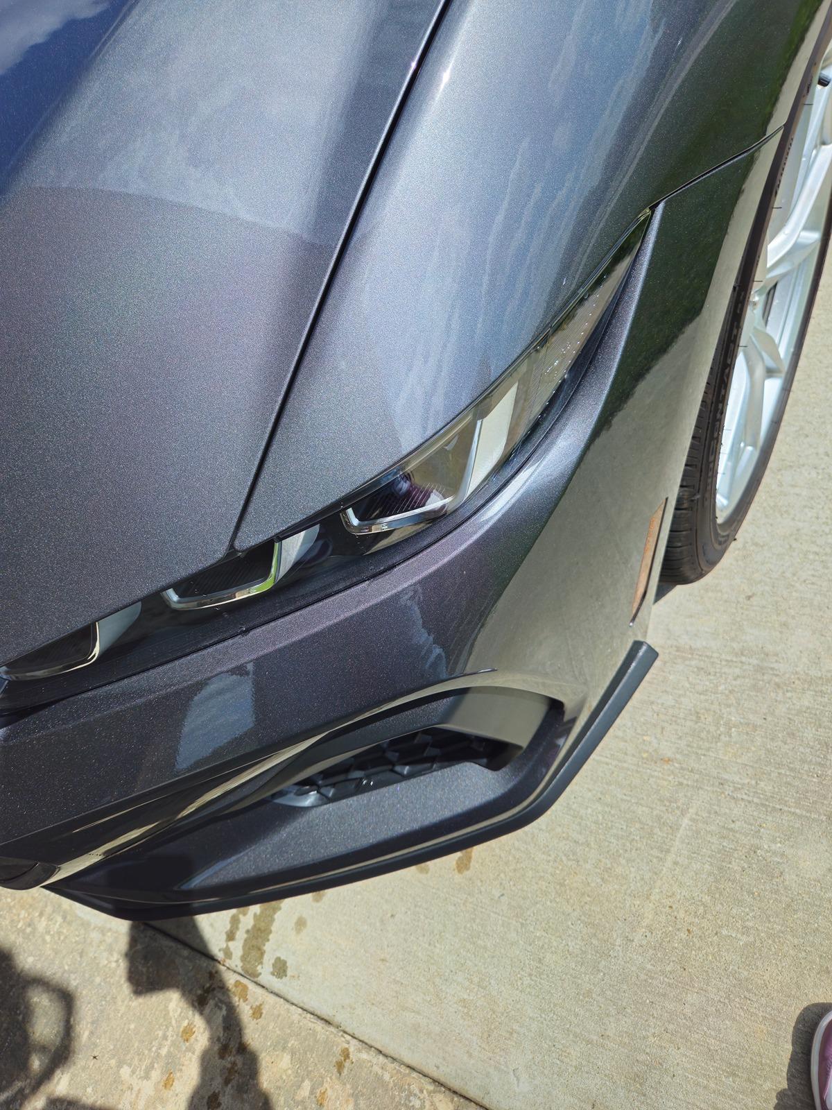

Here's a before and after with my front hood seal. It did increase but not noticeably much. Honestly before i looked like it was a little too small of a gap for the hood 😅
Not bad at all!! Ive done a ton of digging this week and it looks like the main issue with these gaps is the headlight alignment. Ive got another appt at Ford soon for them to finally get it squared away.
