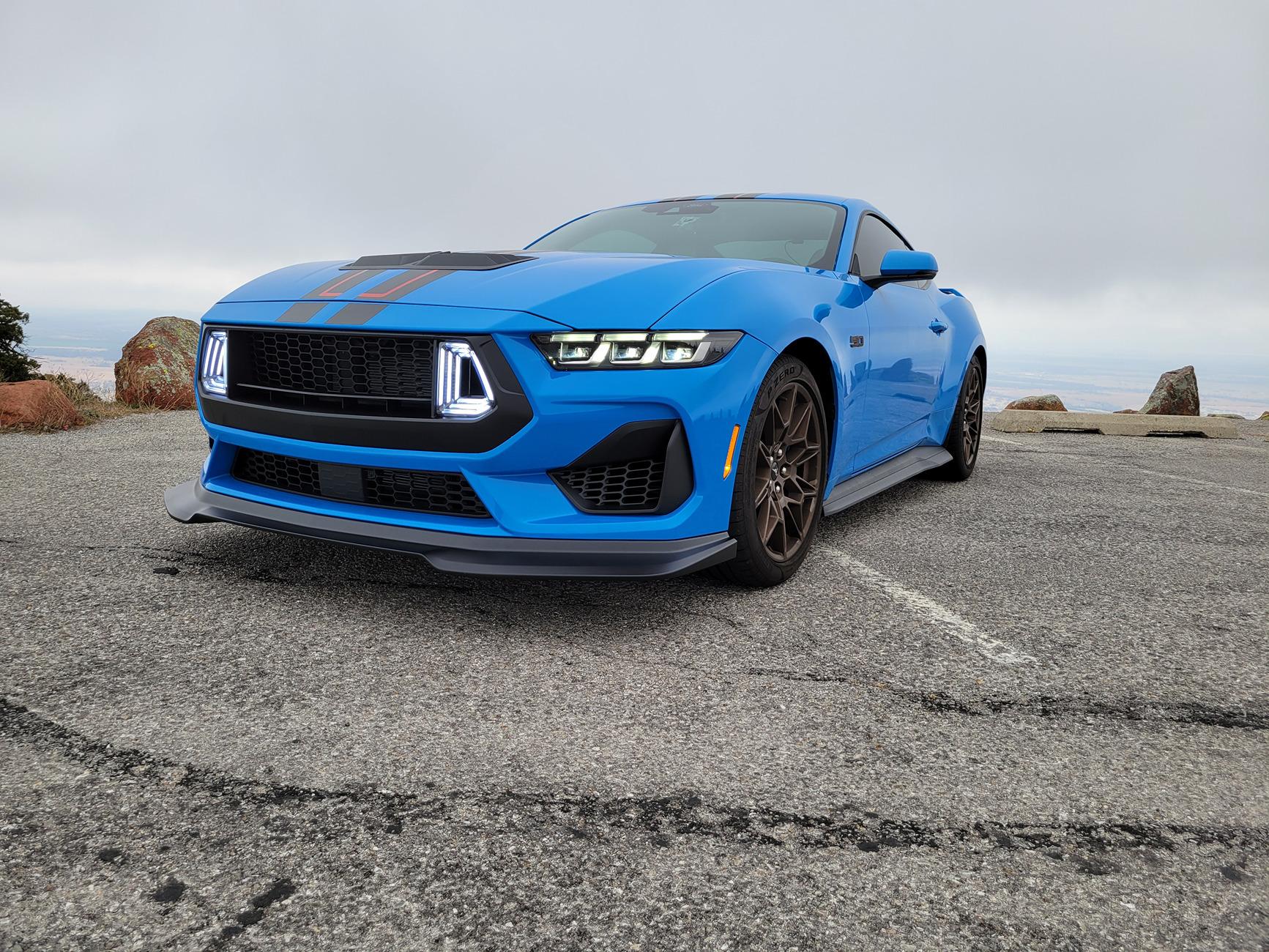

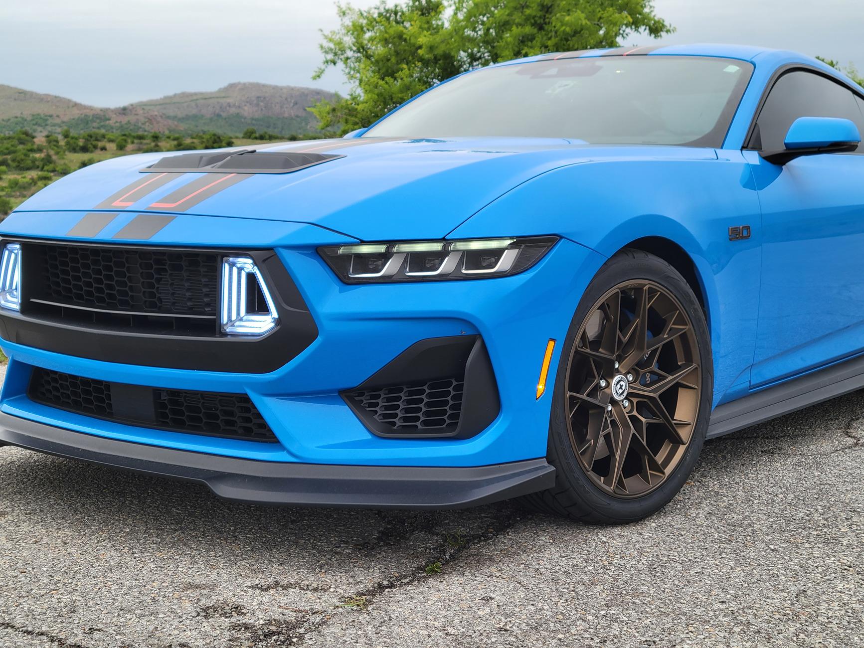

Depends on what you wrap it with. Cars going to ride higher but can be mitigated with smaller side walls. Smaller side walls contribute to rougher rides but can be mitigated by getting bigger side walls.
This is my stock vs 20" setup.
Stock: (19"s with 255/275)
S650 Mustang Do 20" inch rims make ride much rougher or noisier 20231220_131139
Now (20"s with 285/315)
S650 Mustang Do 20" inch rims make ride much rougher or noisier 20240420_191146

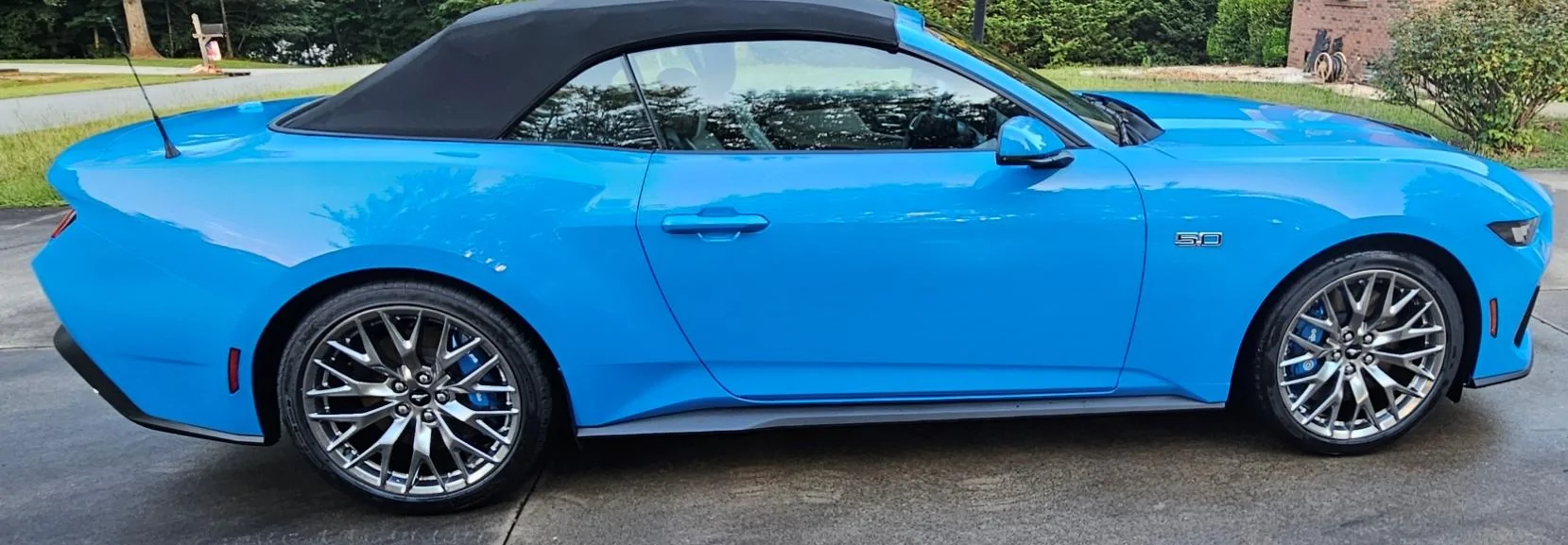

I have the 20x9s on my Vert, I love them. I personally think it handles better than the 19" that I drove and you get better tires. No issue with noise or roughness IMHO

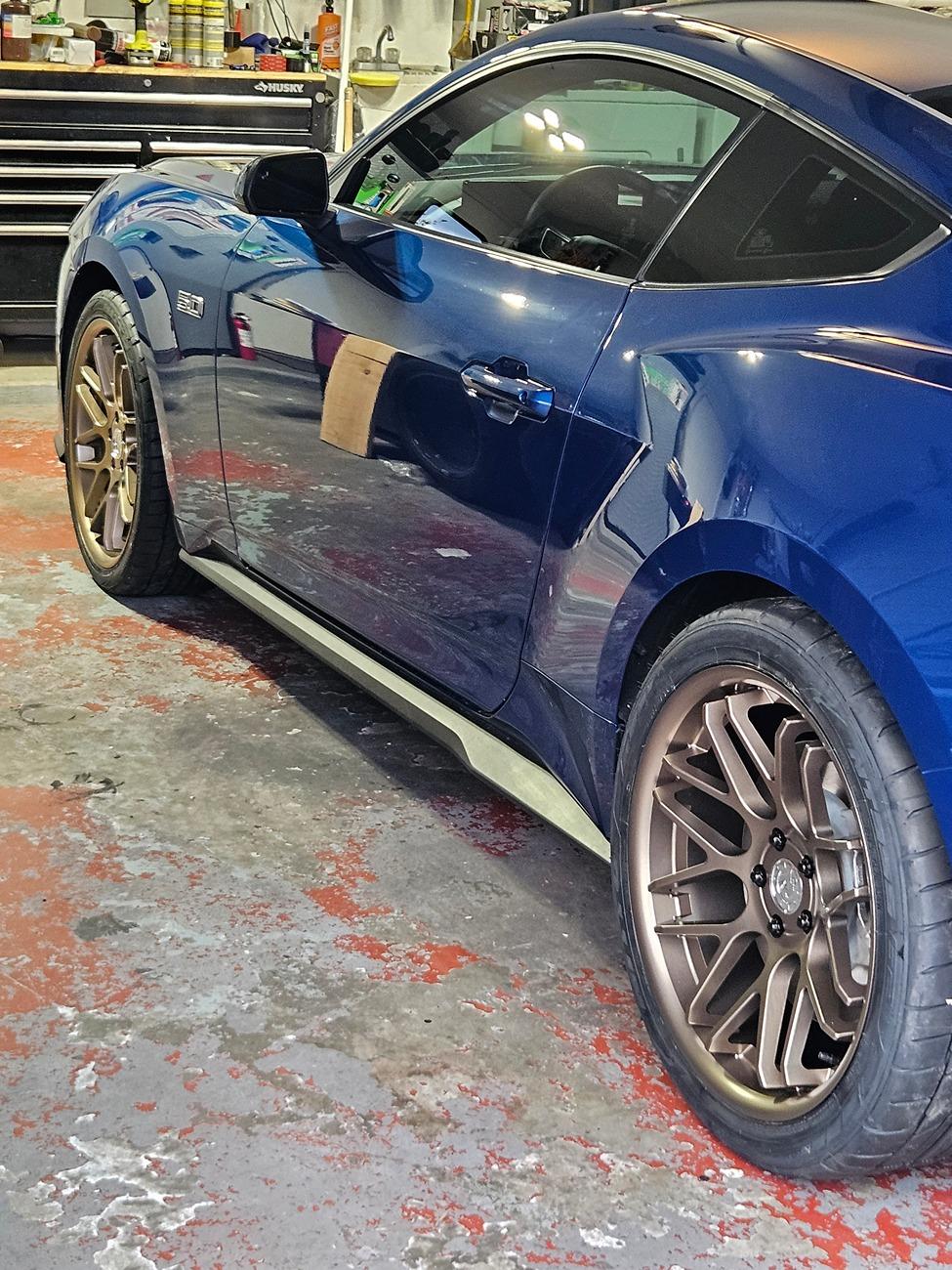

I’m running a staggered 20” setup on mine: Front 20X9 ET25–Rear 20X10.5 ET38 w/ NITTO NT555 G2’s, Front 255/35-Rear 285/35. Tire pressure for the street is: Front 42PSI—Rear 32PSI. Super quiet and handles like a slot car. Definitely feel things (like pebbles) more acutely. 😂

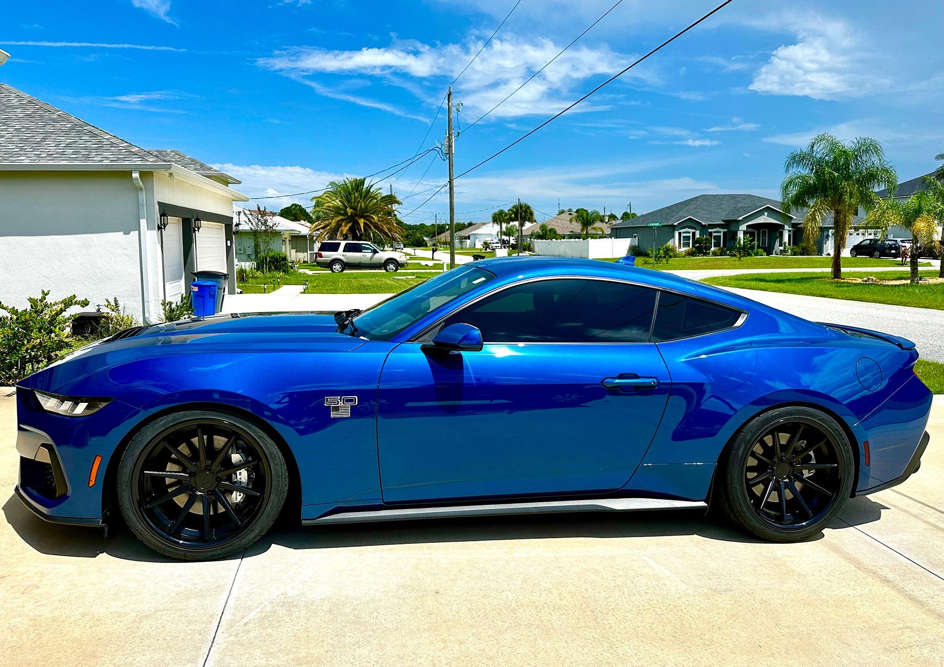

I had a 19 gt with 20x10 squared running rovos capetown wheels on cheapo lionhart lh 5's 20 275 35 came on the wheel. Rode really rough and felt everything x10 from the stock wheels ride. On my 24 gt I went with dc8 20x 8.5 front with 255 35 20 and 20x 10 285 30 20 rear and nitto nt555 g2's ride is really good. You don't want to under or over buy a set of wheels if you just doing spirited driving dropping mad cash on velgen or similar ultralight weight wheels with sport cup 2' or better for a daily or just weekend driver is kinda silly. If your tracking on weekends maybe.
