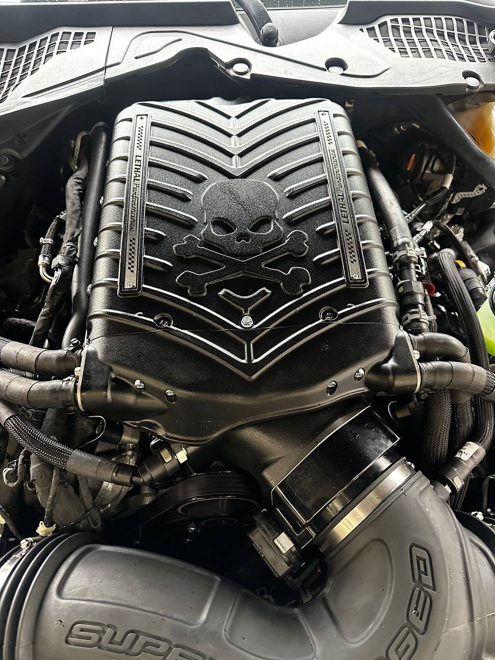

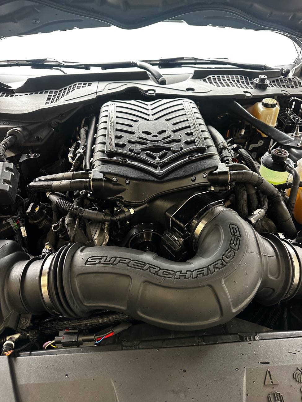

I have a 24 DH premium and two months after buying it got the Whipple /Lethal Performance Stage 2 supercharger installed. Although I have not had it on a dyno it's said it puts out 875hp at the crank. I've hear of some people posting they get 800 RWHP from the same setup. I don't know. But whatever it is it's enough for me. It smokes the tires from 1st to 4th if you get on it hard. Only other mod was an X-pipe and a few carbon add-ons like the track pack wing and a carbon /LED stearing wheel and a few others. The only issue I have had unfortunately is I'm now getting a po430 code. Which means the catalyst below threshold efficiency bank 2. Meaning the catalytic converter is bad likely due to overheating because it's supercharger. Which sucks. I'm taking it to the dealership Saturday and will see if they can warranty it but not getting my hopes up as they didn't install it. If all else fails I will be ordering the Kooks long tube headers with the green cats. Living in Socal though means I have to send them to an out of California address which isn't a problem as I have friends in Arizona and my son in Texas and will drive there to pick it up. This is my first ever mustang and first ever supercharged car. And if you as me had I known a supercharger would cause the catalytic converters to go bad would I still have supercharged it. I'd have to say hell ya I would. The Dark Horse is insanely better with a Whipple supercharger. .

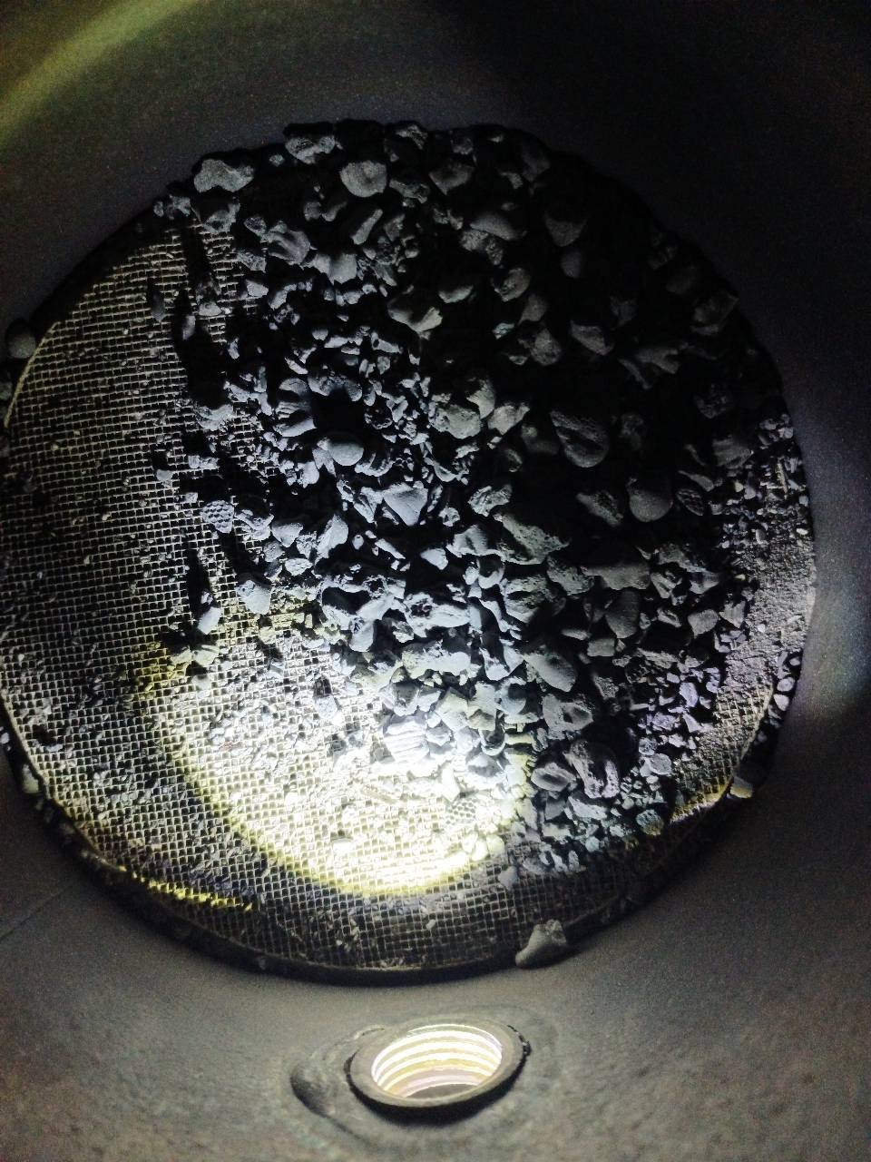

The increased heat in the exhaust from the supercharger can destroy the cats, if they get clogged up you can build up a ton of pressure and damage your pistons. So you are essentially risking your entire engine by running the factory cats or low-quality aftermarket cats.

They melt and clog, pressure increases in the engine and if it pushed through the ring can but together and boom, pop a ringland
I’d rather have no cats and no warranty than run cats and risk needing a new bottom end with a warranty

Wanted to update regarding this, I ended up taking apart the exhaust pipes and since I have a boroscope camera decided to look at the cats and surprisingly they looked new, there was no broken parts or anything melted or like any of the pictures I’ve seen others post, so I’m hoping it’s just a O2 sensors but I’ll know for sure when I get it to the dealer in the next week or so
