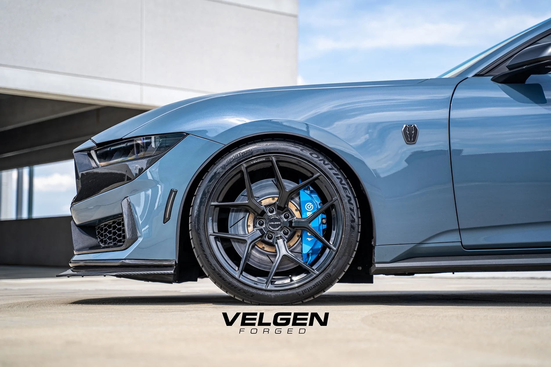

Hey All - Just seeing this thread! That is my car that Velgen has pictured; thanks for the kind words. Happy to address a few questions. Let me know if I can provide any additional insight!

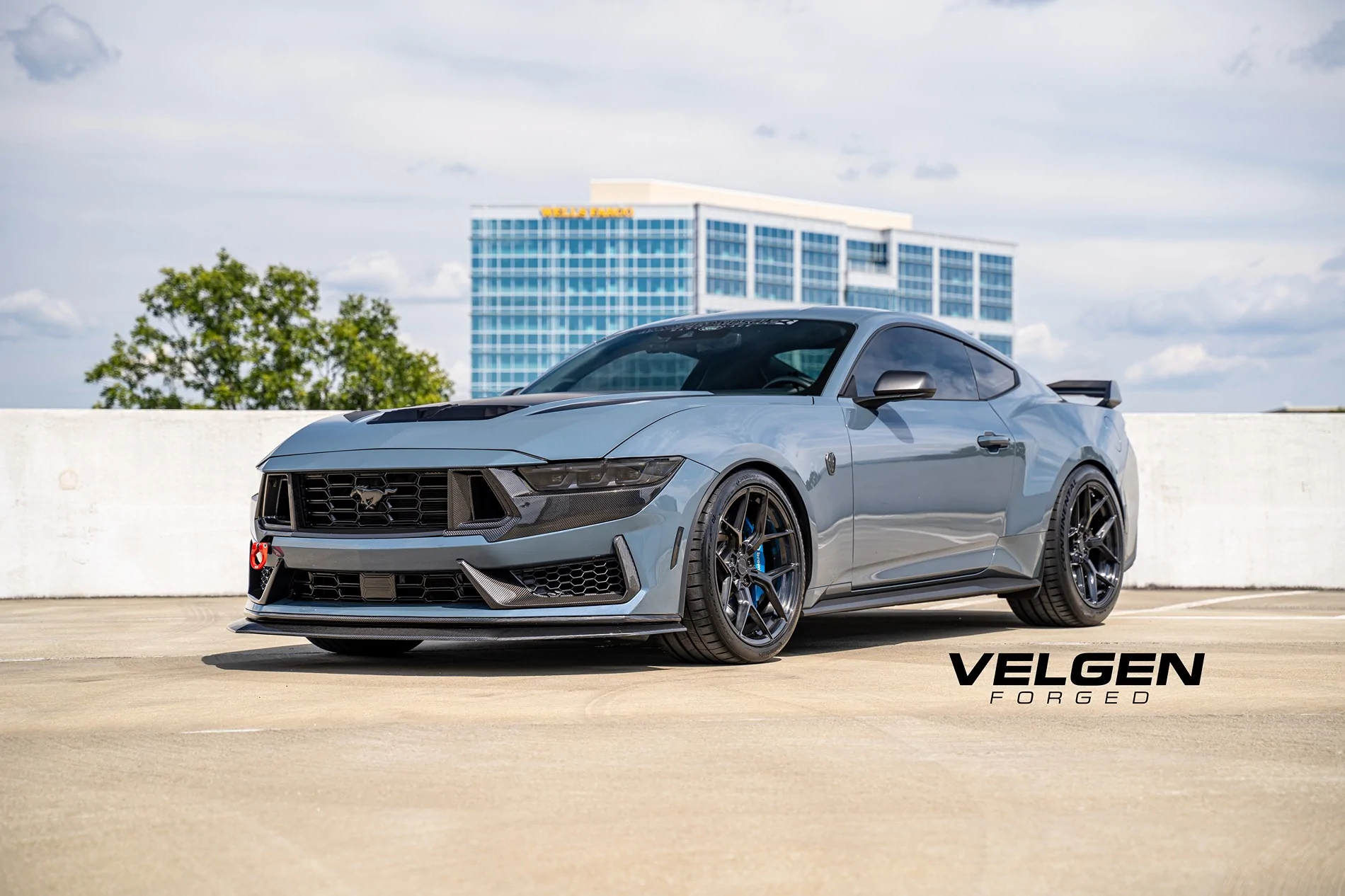

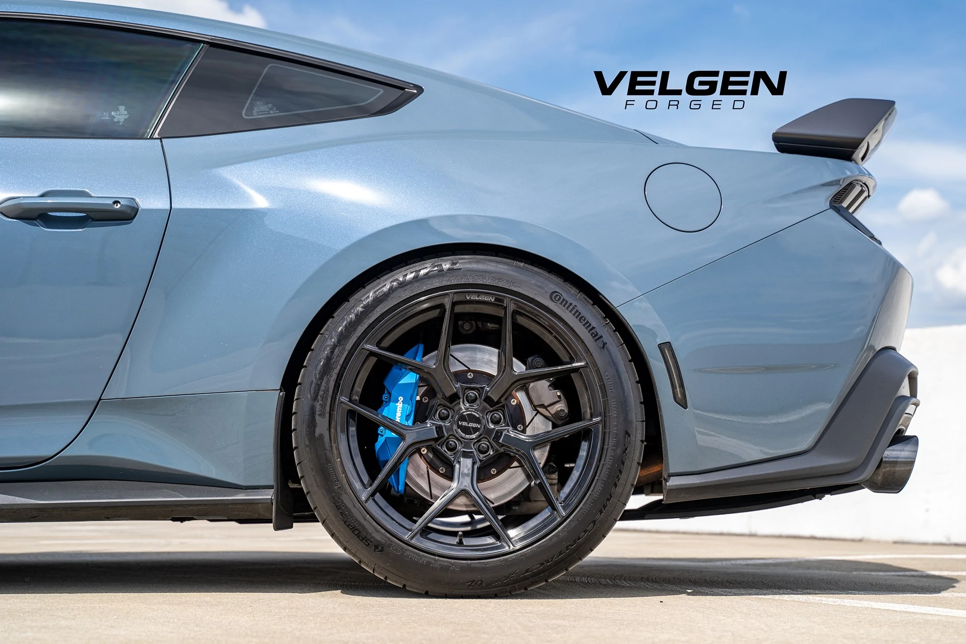

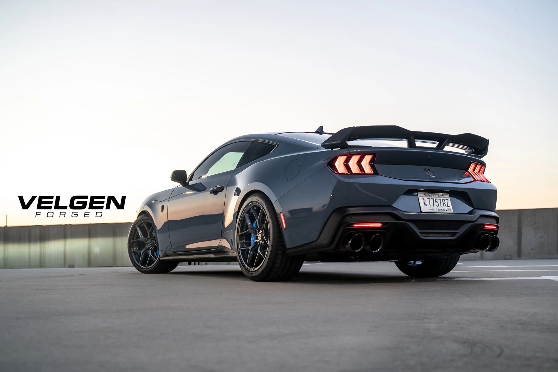

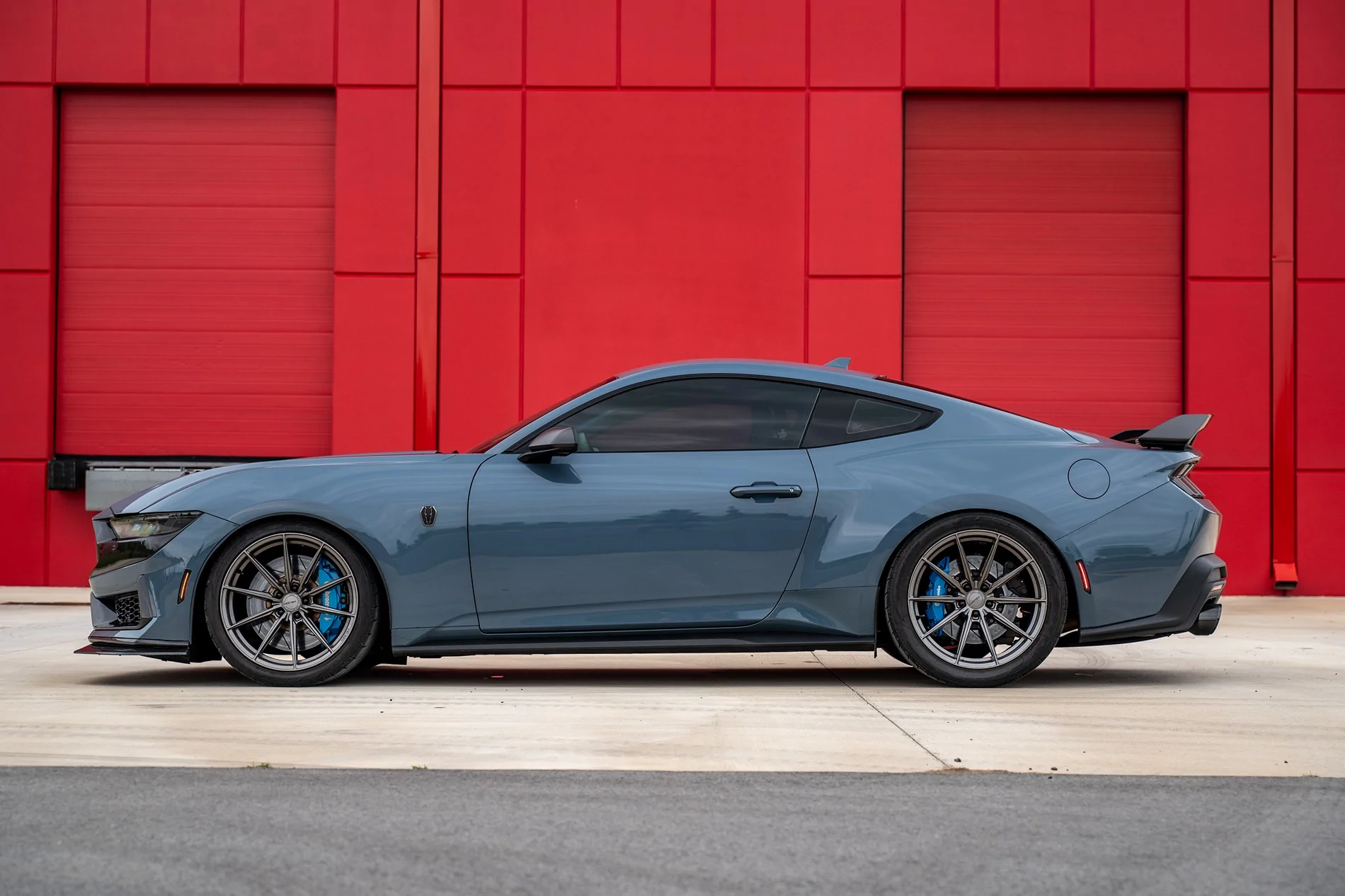

Car is stock suspension in these photos. Since I was at Mustang Week for these shoots, I do have a couple items in the trunk. However, the 315/35ZR20s are deceptively tall. The factory Handling Pack 315/30ZR19 tires are only 26.4" tall where the 315/35ZR20s are 28.7" tall. That fills in a TON of gap.
Trunk is dead empty in this photo.
I will also note that factory springs on this car are the Handling Pack springs, which are currently the lowest factory springs the S650 Mustang has. Compared to a base GT for example, a bone stock Dark Horse Handling Pack will sit quite a bit lower than the base GT, wheel/tire size difference aside.
I would not recommend running this aggressive of an offset on a car any lower than this unless you plan to run a lot more camber up front. Current alignment is -1.9 deg F / -1.5 deg R with no rubbing as it sits, but we're pretty maxed out. If you do plan to lower your car but want these wheels, that's the best part about forged - you can get the same style and create a custom offset for your needs.
I was previously lowered on Steeda Dual Rates and running Velgen's standard VF10 20x10 F / 20x11R setup and the fitment was great with that combo.

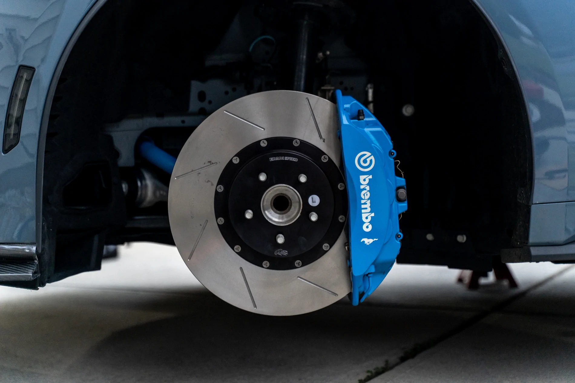

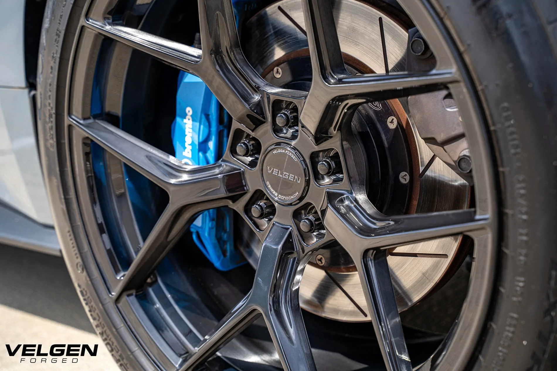

As for the brakes, they're Baer Eradispeed+ Slotted Rotors (Front/Rear) all the way around. I do track the car and generate quite a bit of heat with the G-LOC pads, so you can see I've burnt some of the coating off the hats up front; other than that they've been a solid add to the car.
Fresh Install Pic
