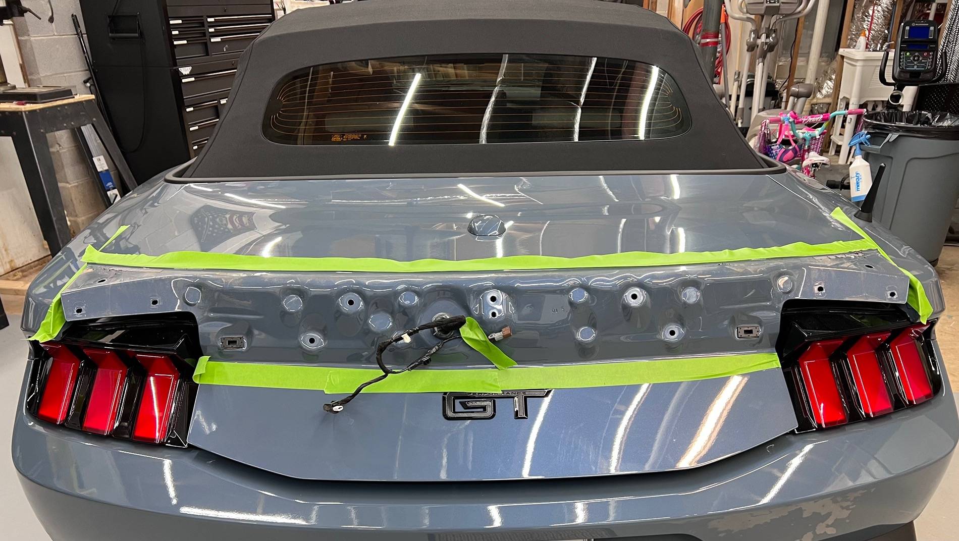

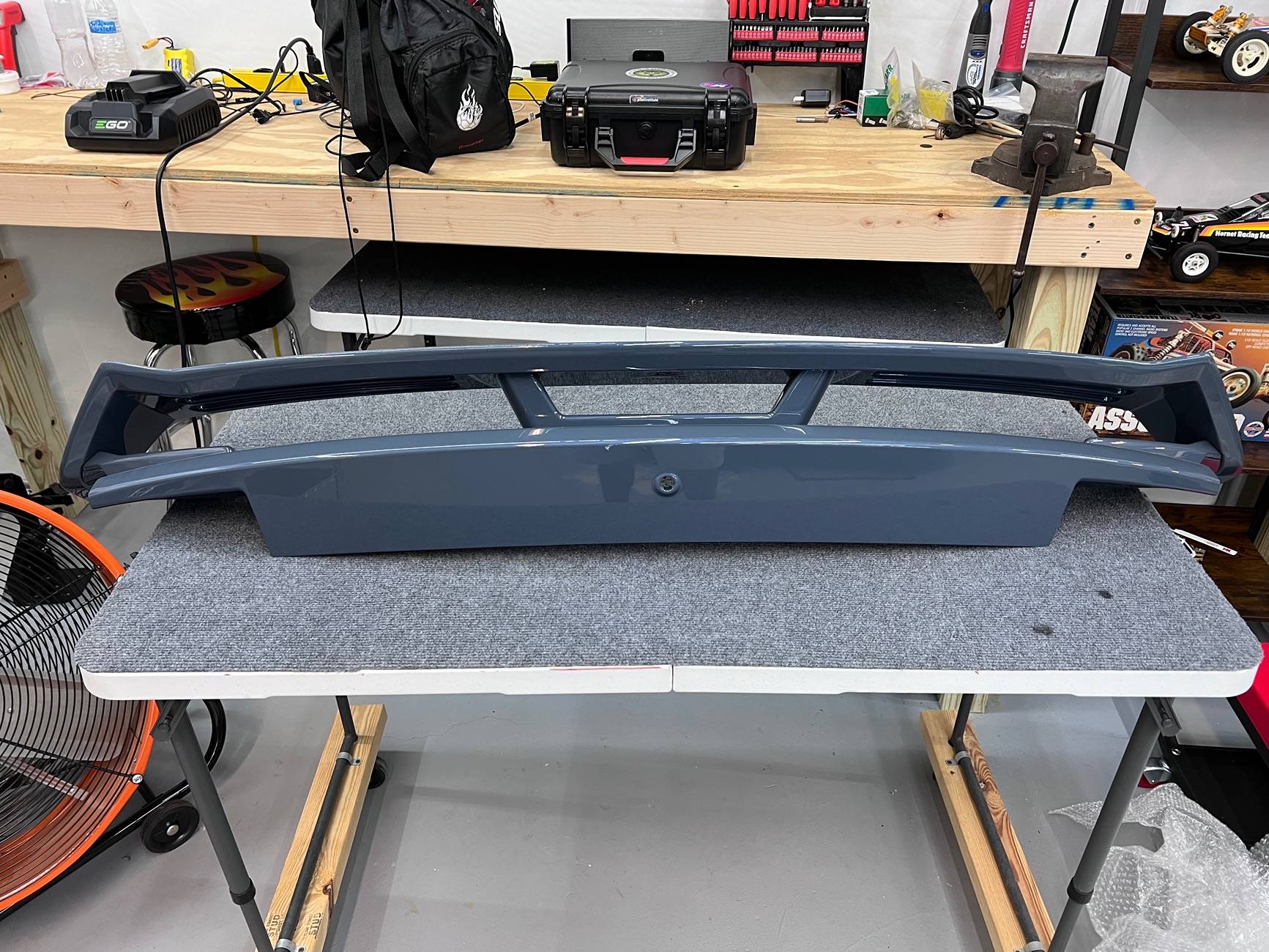

Well I have been waiting for a nice spoiler to be released for the S650 convertible and I kept seeing those PP spoilers on EBay that were takeoffs and included the spoiler module. One finally came up for sale in Vapor Blue last week and I bought it. I removed my factory module with the lip spoiler and removed all the leftover adhesive. Once I had the surface clean and prepped with new double sided tape, I started to fit the EBay spoiler. I struggled with alignment issues with the bolt holes and discovered there is a slight difference in geometry between the coupe and convertibles trunk lids. I could only get some of the bolts to line up and others were off by 3/8”. It was disappointing but I will just have to wait for a spoiler that is made specifically to fit the convertibles. So if any of you were wondering if one of those EBay takeoff spoilers will fit your vert, unfortunately it’s a no go.

Yeah I removed my blade spoiler with the spoiler module and tried mounting the PP spoiler with the module it’s mounted to and the bolts wouldn’t line up properly to my trunk lid. Seems the only way to work around this is to find a spoiler delete module for a vert and remove the PP spoiler I have and mount it to the spoiler delete module. I believe if I remove my blade spoiler, the holes will not line up to the PP spoiler.

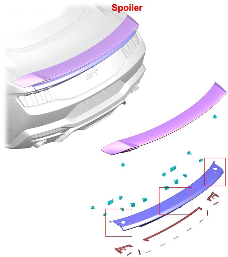

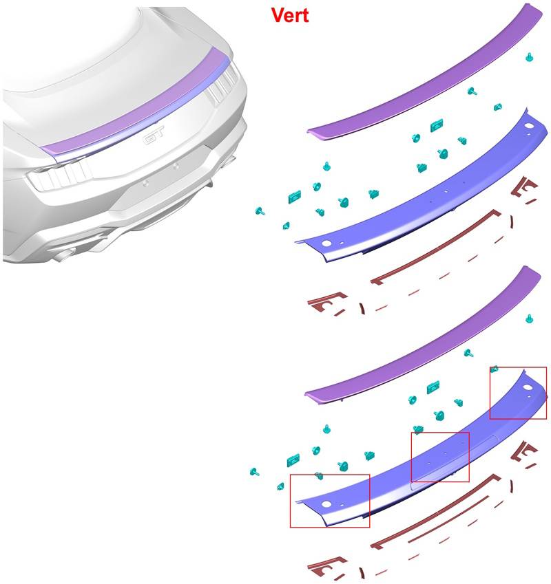

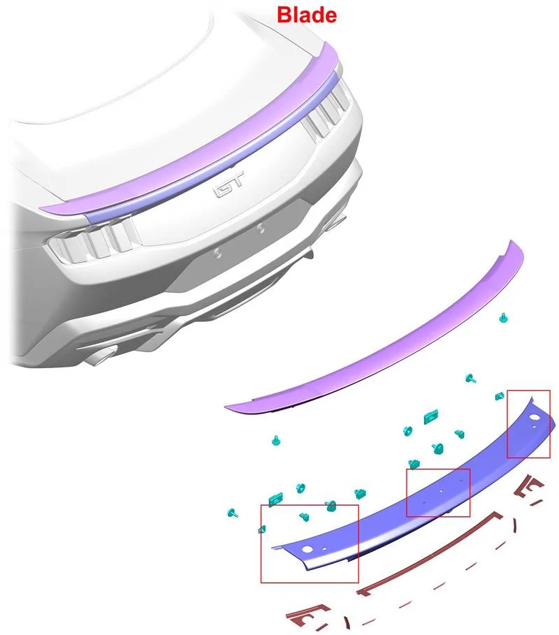

My thought was the bolt pattern for the "spoiler only" might fit your original module since all OEM spoilers (blade and raised) have identical bolt/pin pattern.

Backdraft would not know, just for reference here are the schematics from Ford on all 3 spoiler types, Vert Lip, Blade and Raised. Note Bolt patterns on lid plate are identical (blue)
