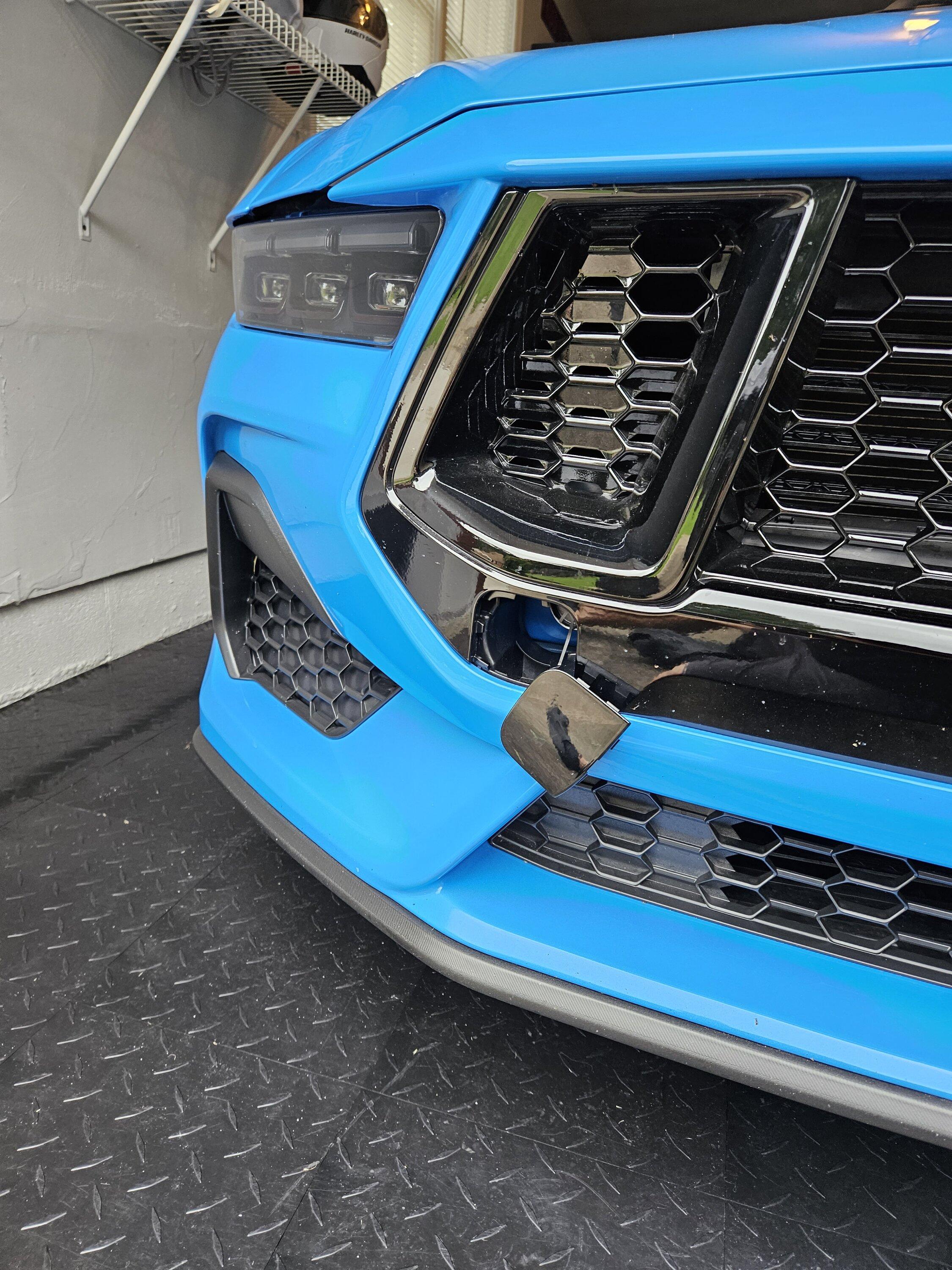

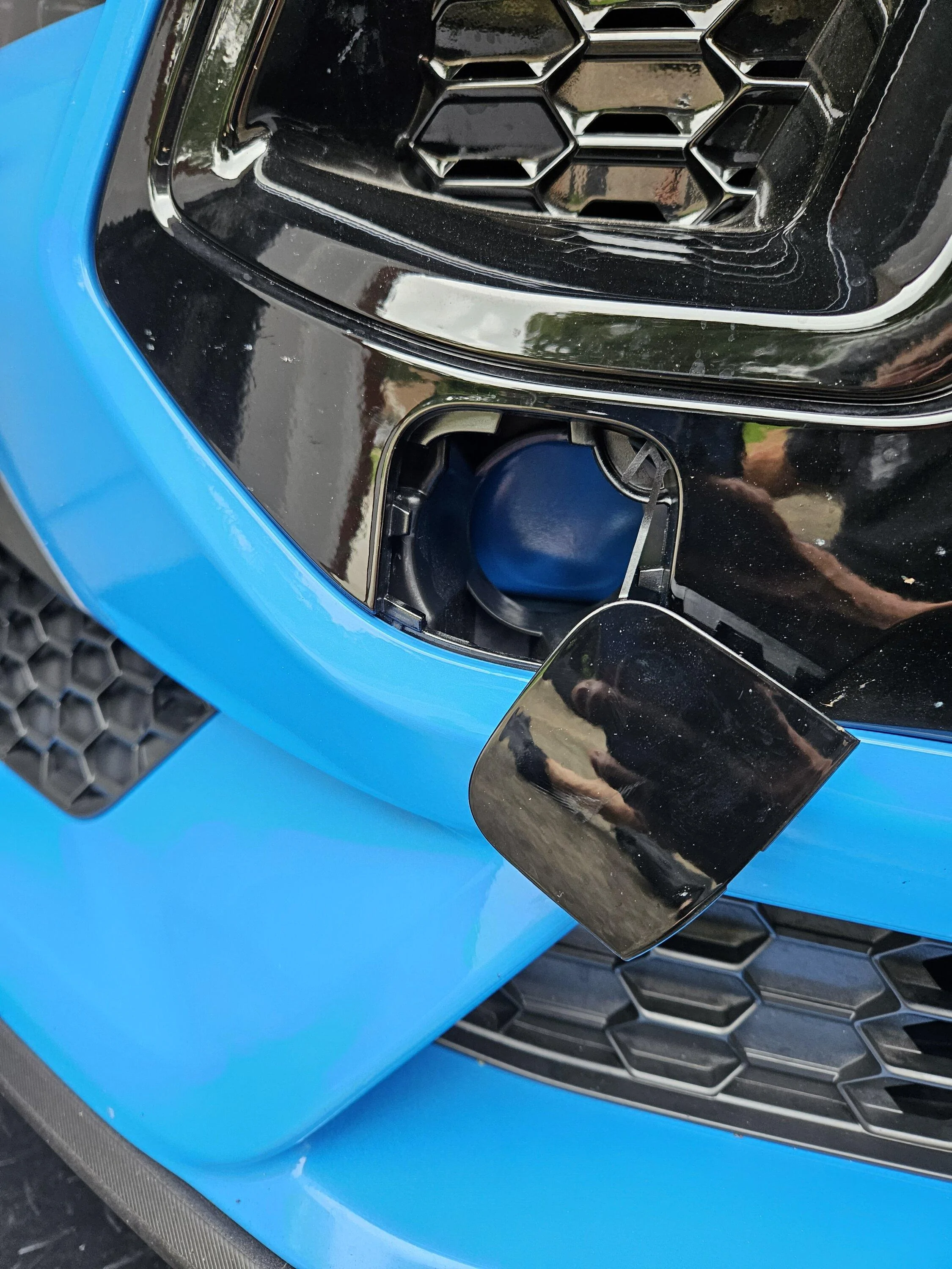

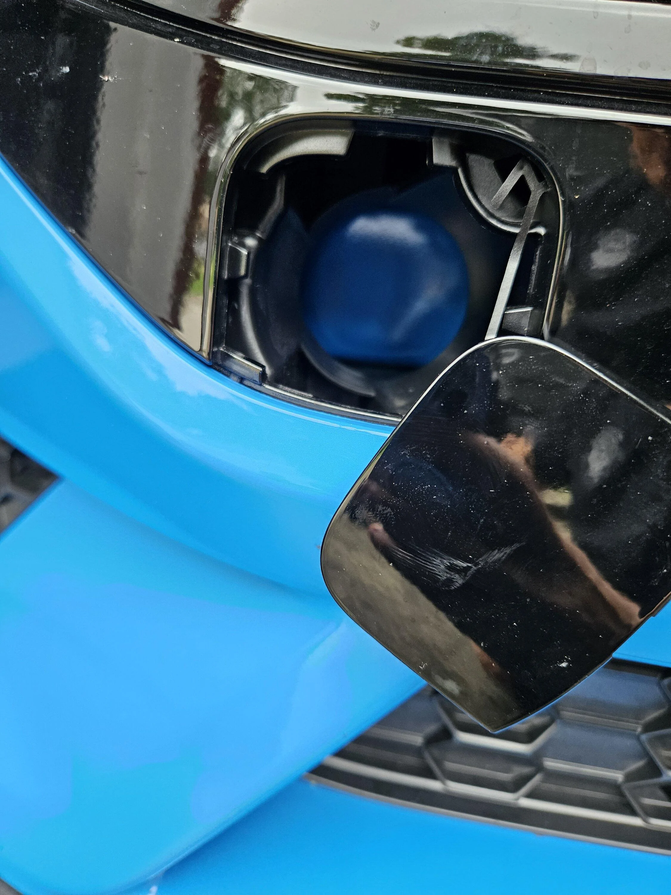

There is no tow hook receptacle (or something) behind the tow hook plate?!

Sorry for pulling up an old thread; however, want to validate that I have a tow hook capable receptacle. I am very nervous about prying off that cover. Anyone have experience with how to not screw up the paint prying off that cover? I have a DH with AP, but no HP so didn't get the actual hooks, but curious as to whether the hardware to insert one is back there.

There is no receptacle for towing. Just an empty square. You can use a plastic trim removal tool to remove the cover. Does not make sense to me, why there is not a tow hook receptable on our cars, you would think this would be standard if there are not adequate tow points. Happy New Year!

performance package and dark horse actually get a tow hook mount behind the panel. But yes a plastic trim tool works for me. I made my own front plate mount behind the panel since i don’t have a tow mount being a Base non PP car.

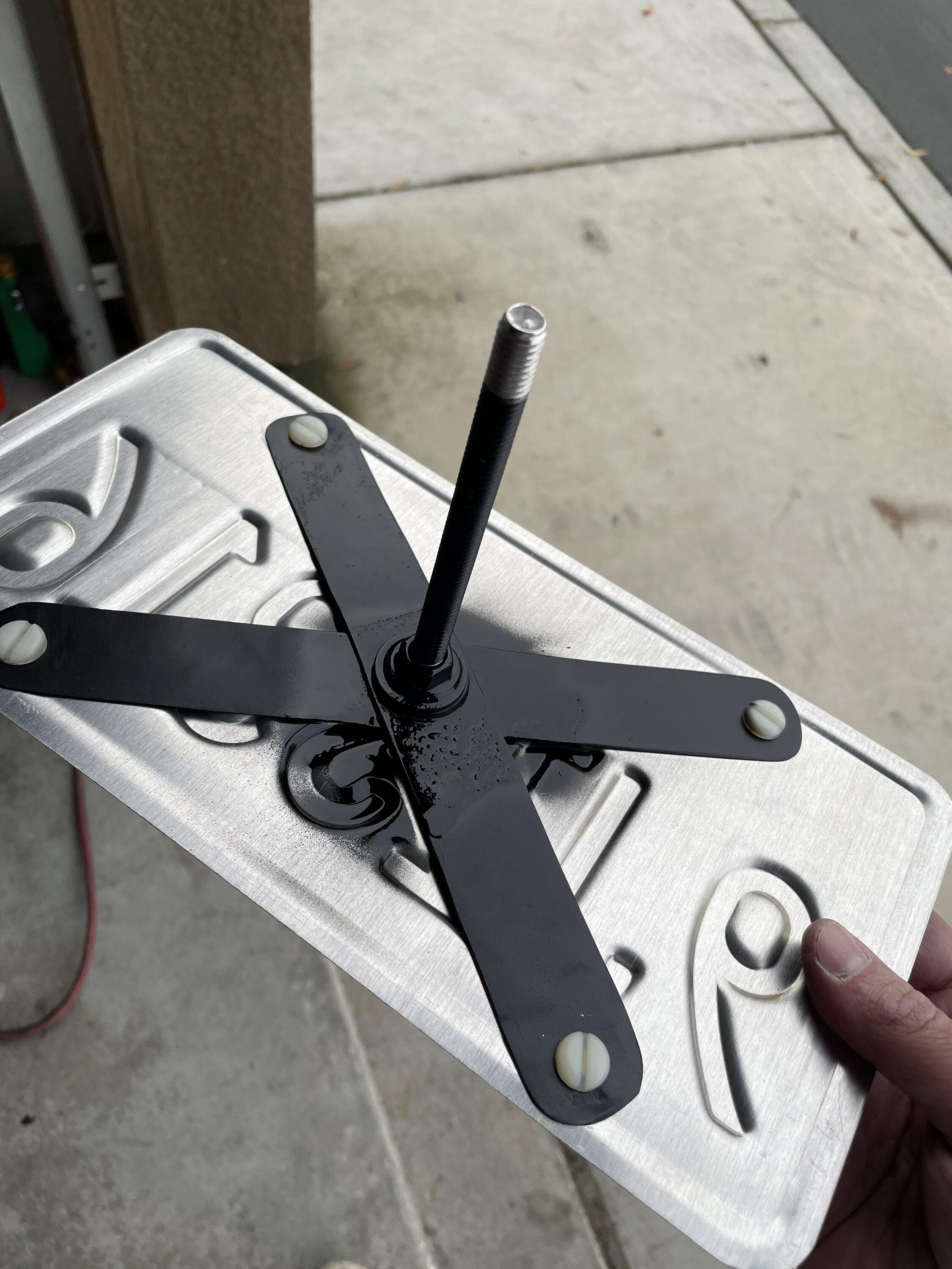

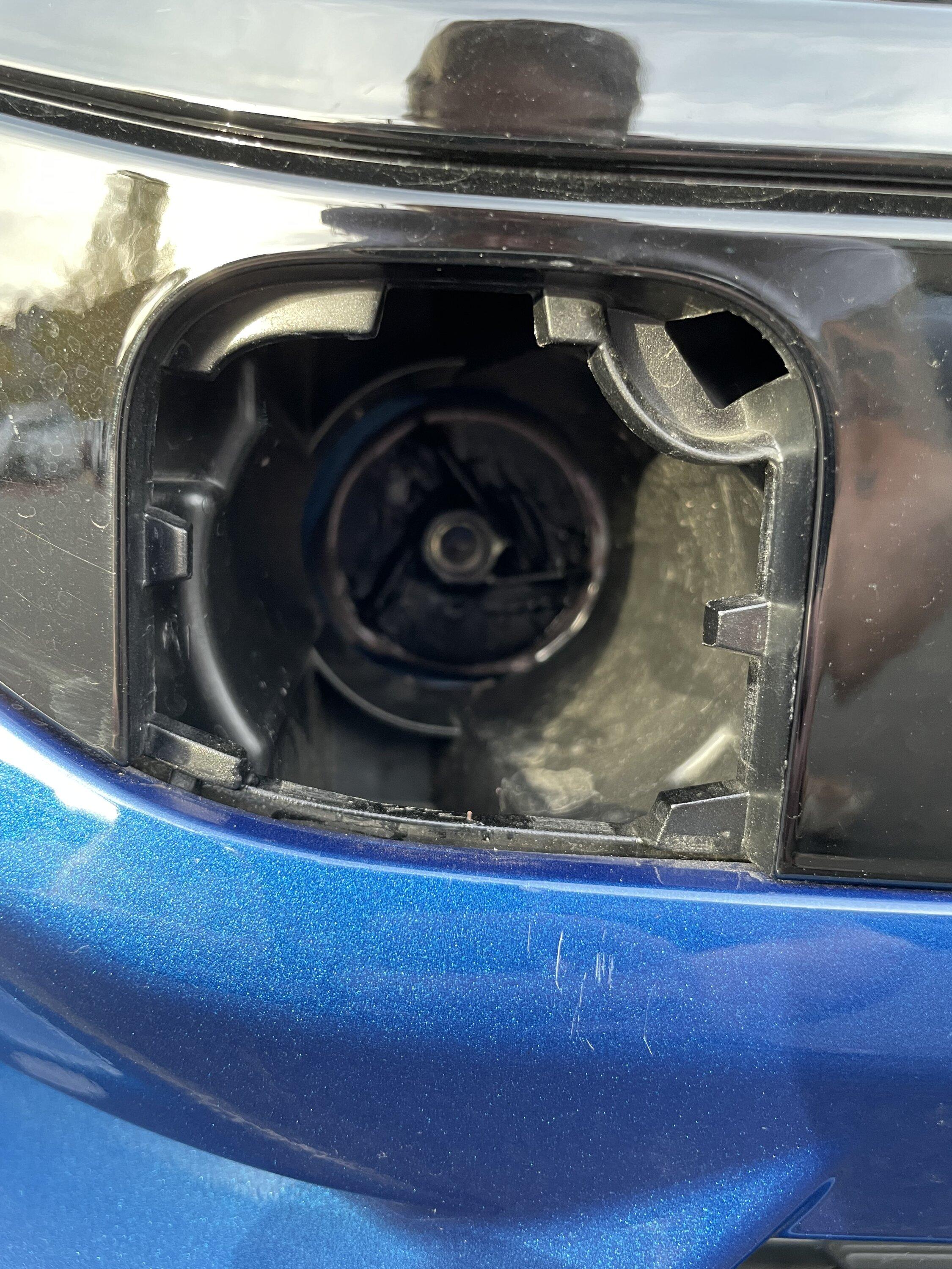

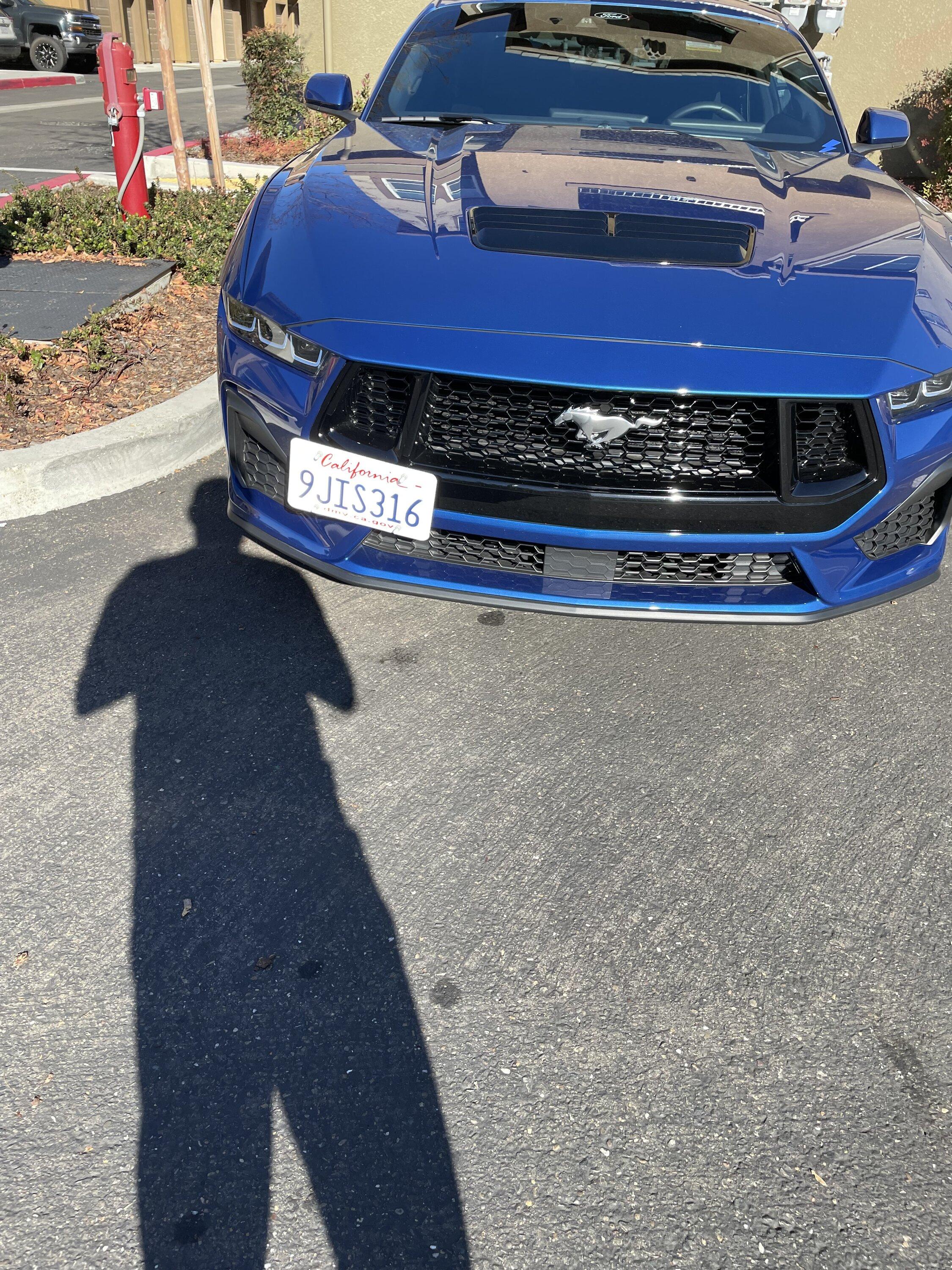

here is what i did for a mount. Home Depot sheet steel. Made a round piece and used steel weld epoxy to mount two nuts to the round piece and 3 support braces to the nuts for extra rigidity. I cut two strips and rounded the edges and drilled a whole to fit over the square edge of a 5” carriage bolt. Used some washers and a nut to hold the strips in a x shape at the proper spot to mount my plate too. I shaved down the head of the carriage bolt to sit nicer against the plate. Sprayed it all black and didn’t care too much about the look as you can’t see it once mounted. I used nylon screws for the plate as it was cheaper than stainless anyways. the plate. I sanded the bumper support beam behind the little square panel to ensure proper adhesion as it has a think layer of paint. Then put a healthy serving of steel weld epoxy on the unpainted back side of the circle piece and then screwed it into the carriage bolt so i could actually reach it in to place it. Held it down for a few minutes then rigged a jack stand to keep the bolt held at the height i wanted and left it for an hour checking it didn’t move periodically.
