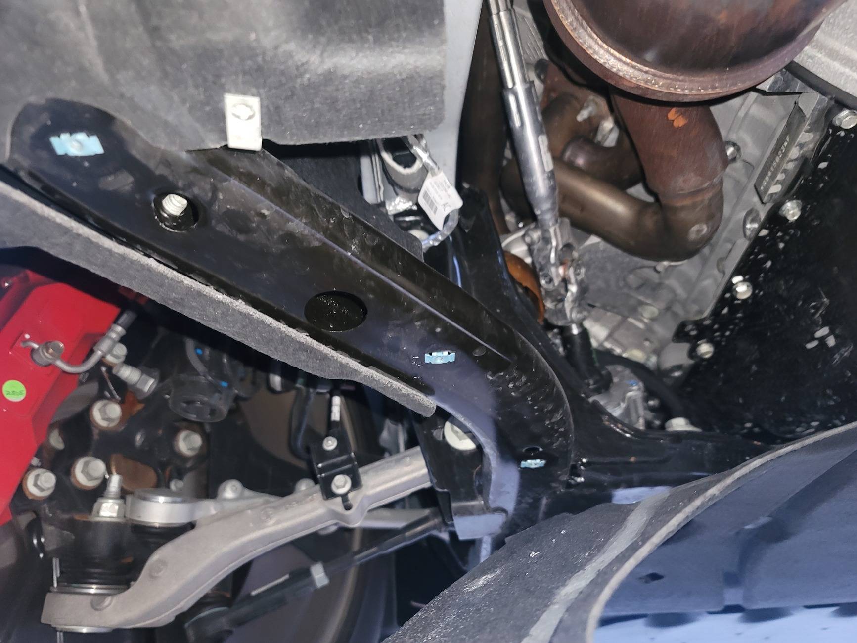

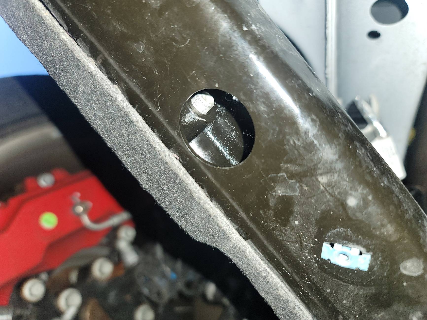

Has anyone installed a BMR K Member Brace on a 2024 yet? Whole attempting to install there appears to be a bracket attached to the side of the K Member leg with large threaded inserts blocking the crush sleeve from going into the hole in the K Member.
Has anyone ran into this?

What did you find out? From your pic to me it looks like a no go.. I removed mine from my ā€˜19 for my ā€˜24…

I bought some steel tubing and cut it to the same length as the crush sleeve that came with the kit. It was thick enough tubing to do what was needed but thin enough to allow it to slide past the threaded thing inside that k member leg.
