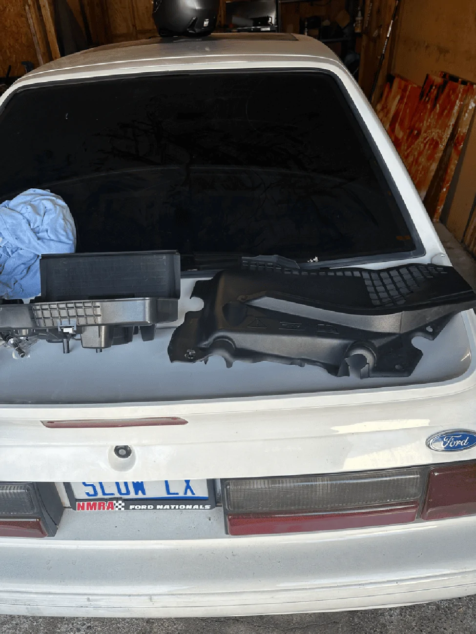

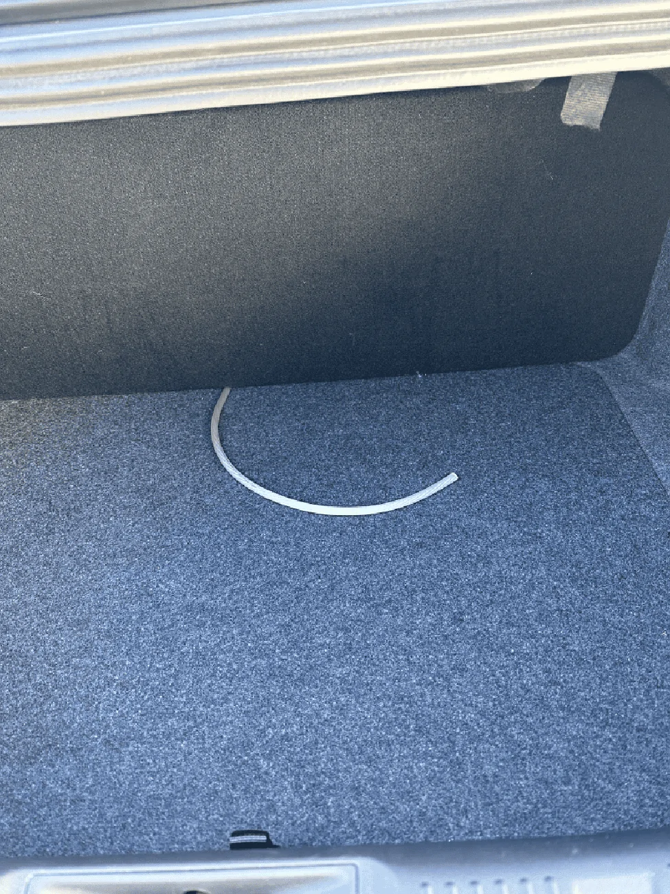

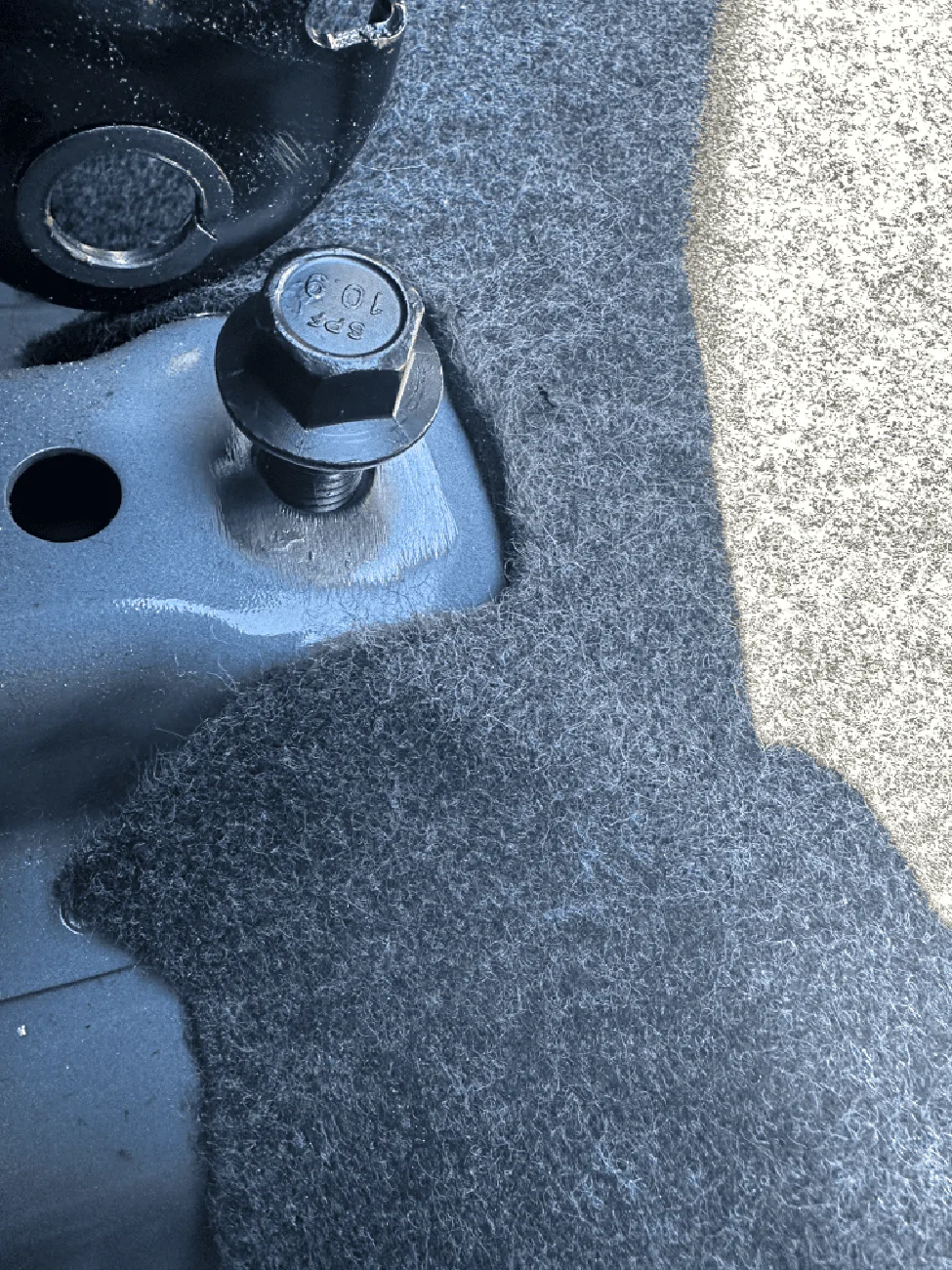

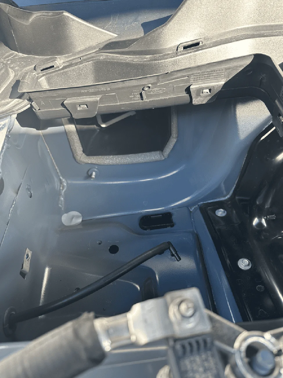

Slowly started tinkering today, still waiting on sub, amp and box.

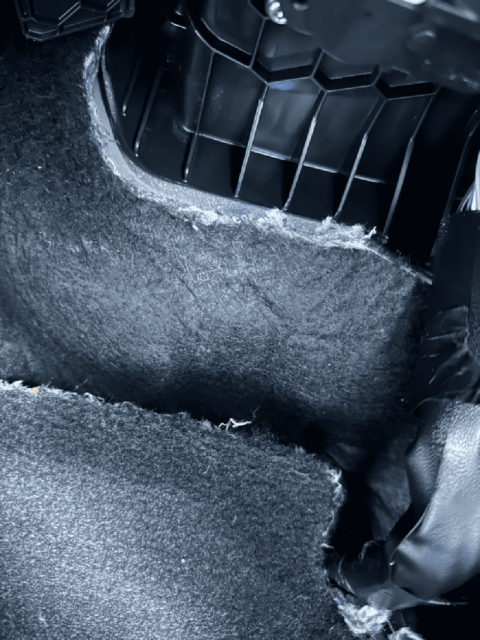

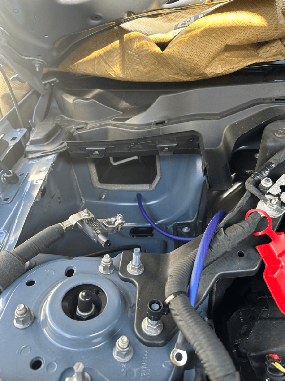

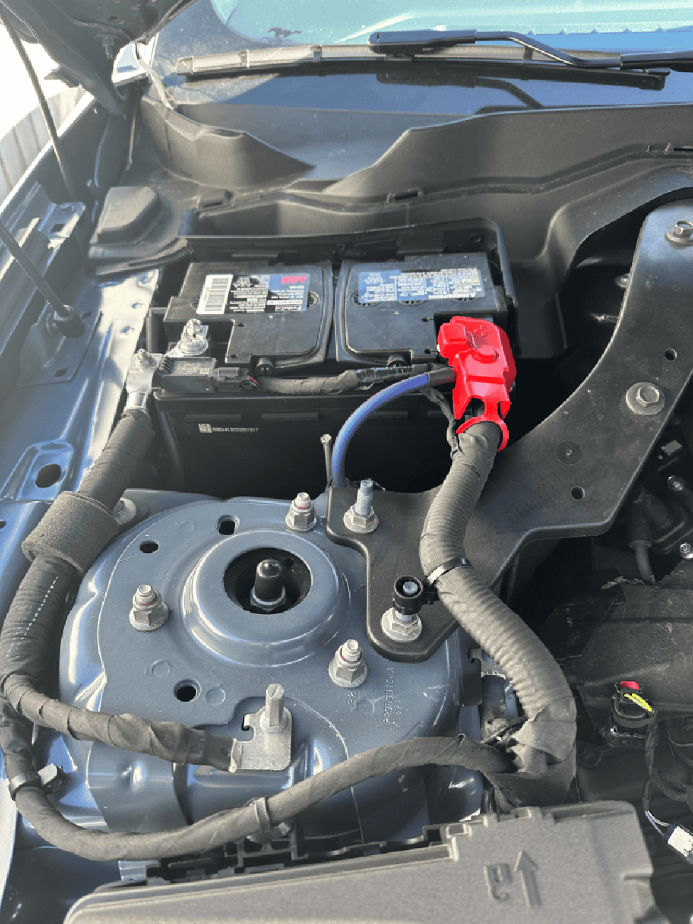

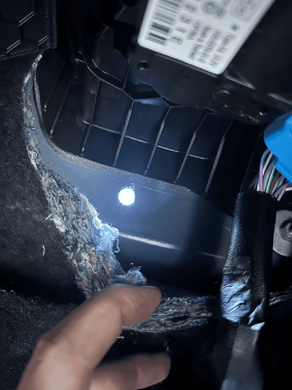

1. I removed the battery, cover and box.
2. Carefully drilled a hole, there is room but there is a wire harness in the area so you can’t be reckless.
snapped some pics from both sides, using 4 gauge wire and a grommet.
back to work, I’ll update as I make more progress ✌

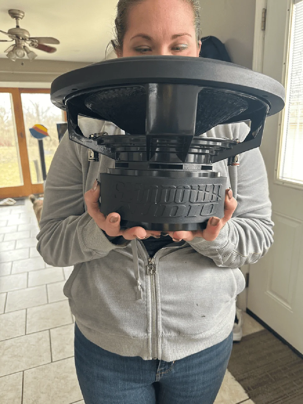

Sundown SA12 classic 2 ohm on a D4S JP8.
I am REALLY excited…
Edit…. Sub just showed up…

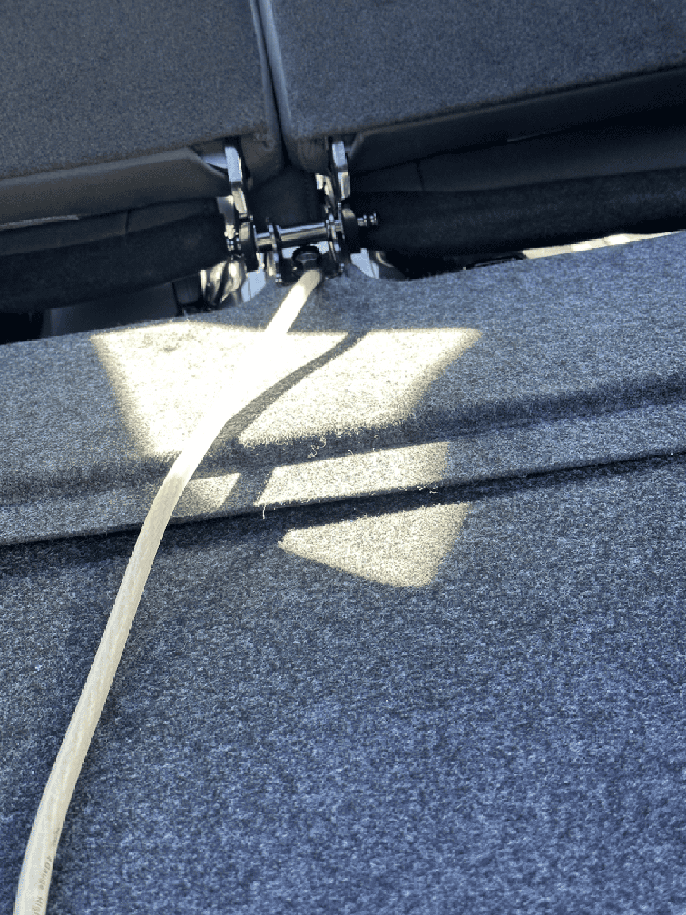

Got a little more tinkering in before work today, put battery and tray back in… connected power wire (no fuse for now)
pulled half of back seat, used a wire wheel to get a clean fresh ground.
Then my box showed up, test fit sub into box, which looked too small but it fit fine( not sure how it will perform being so close on depth)
If needed I can always add a 1” spacer for more room.
Test fit box in the car, it goes through the trunk.
still need to finalize wire runs, pick a spot for amp and LC2i and wire that in as well.

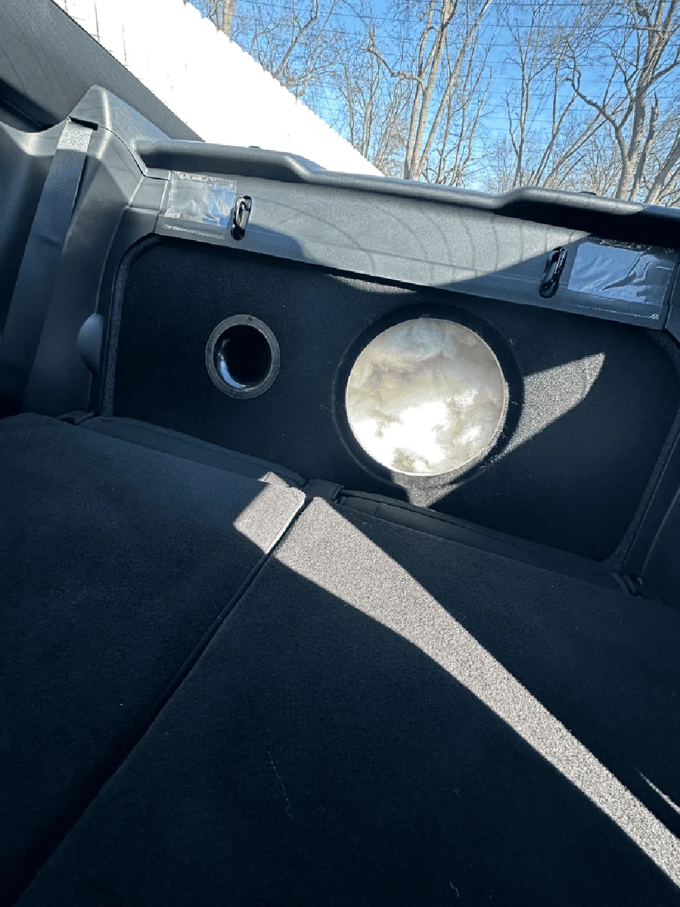

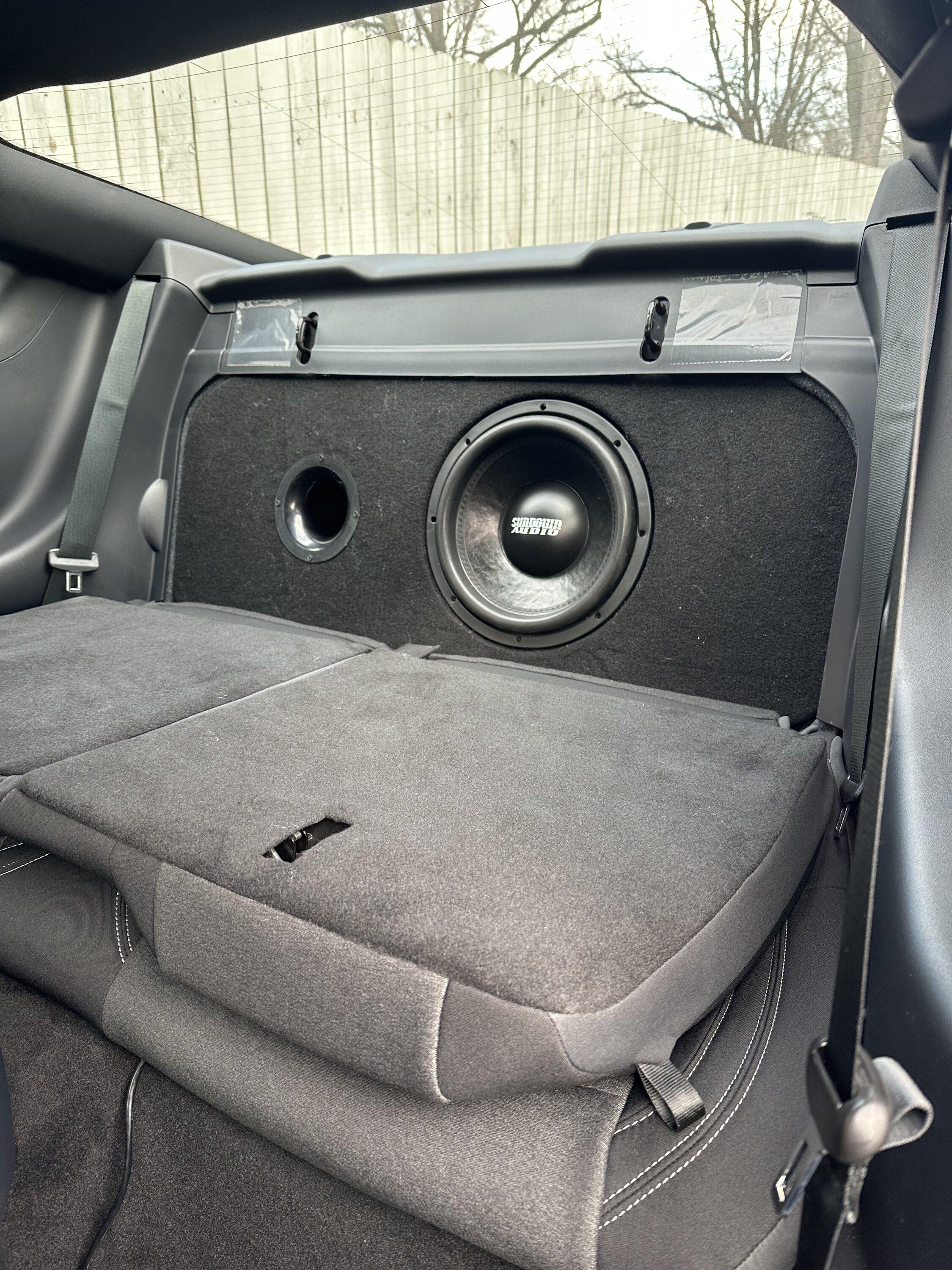

Sub is mounted and in place, major wires done… just need to finish wiring up LOC and amp.
S650 Mustang Base Budget Bass Build! IMG_1475
S650 Mustang Base Budget Bass Build! IMG_1473
Q6543
Q6543
Dec 11, 2022
2,291
3,026
Detroit
1993 fox

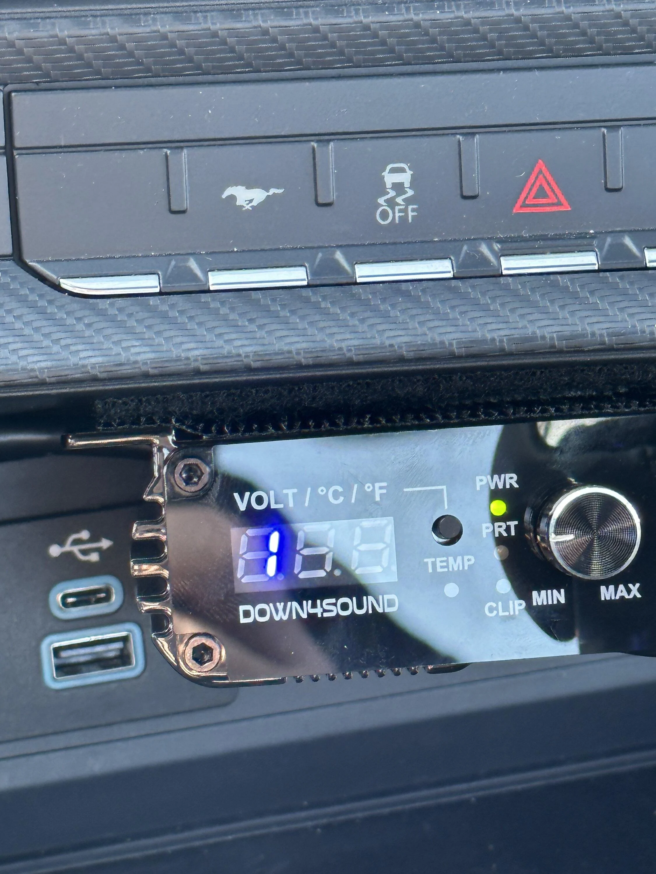

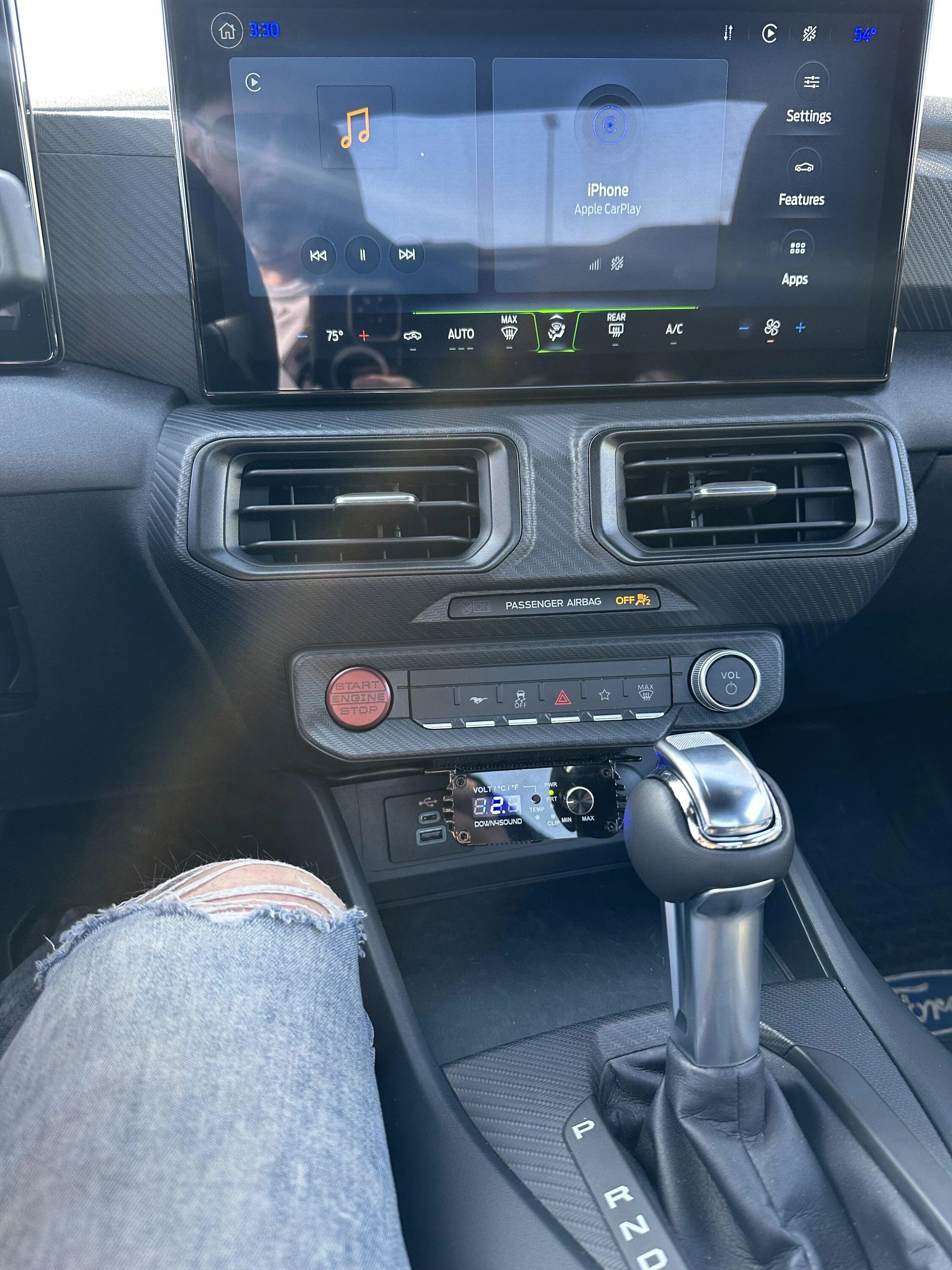

Finished running and tightening things up in the car, need to definitely add a capacitor, also need to add some poly batting to the enclosure.
system tunrned out pretty insane for 1 12”, I need to stuff a little more acoustic fill as the box is just a tad small and certain higher frequencies have a “peaky punchy” sound… need to slow the air some.
the lows are exactly what I was looking for… and with this orientation… from outside you don’t really comprehend just how low and nasty this thing is getting.
I’ll also need to add the capacitor as when I go to really push the gain I can see the voltage drop on the remote.
also it took a day of bumping fro the sub to break in… but… you’d really have to hear it.
