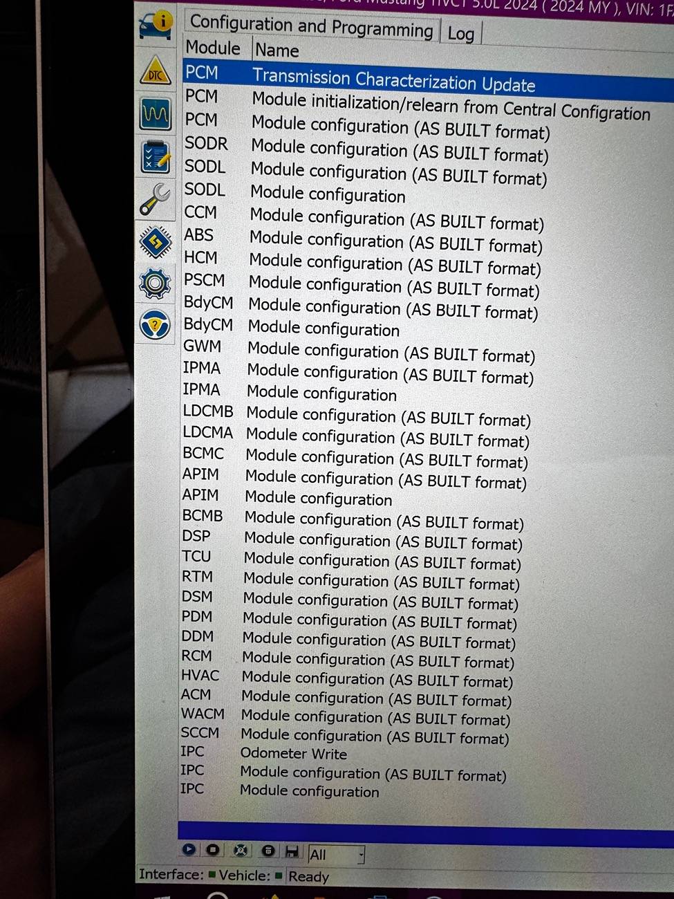

I couldn't find the the BCM in forscan im on version .65

I think for MEA it’s not connected just reflecting , you need to check the wires.
Yep, this could be the case indeed. Unless Ford was lazy and kept all wires as they are.
I know for a fact that Ford kept wires more universal on the S650 than on the S550, so that's a good thing.

i just tried it didn't work looks like it is not connected
