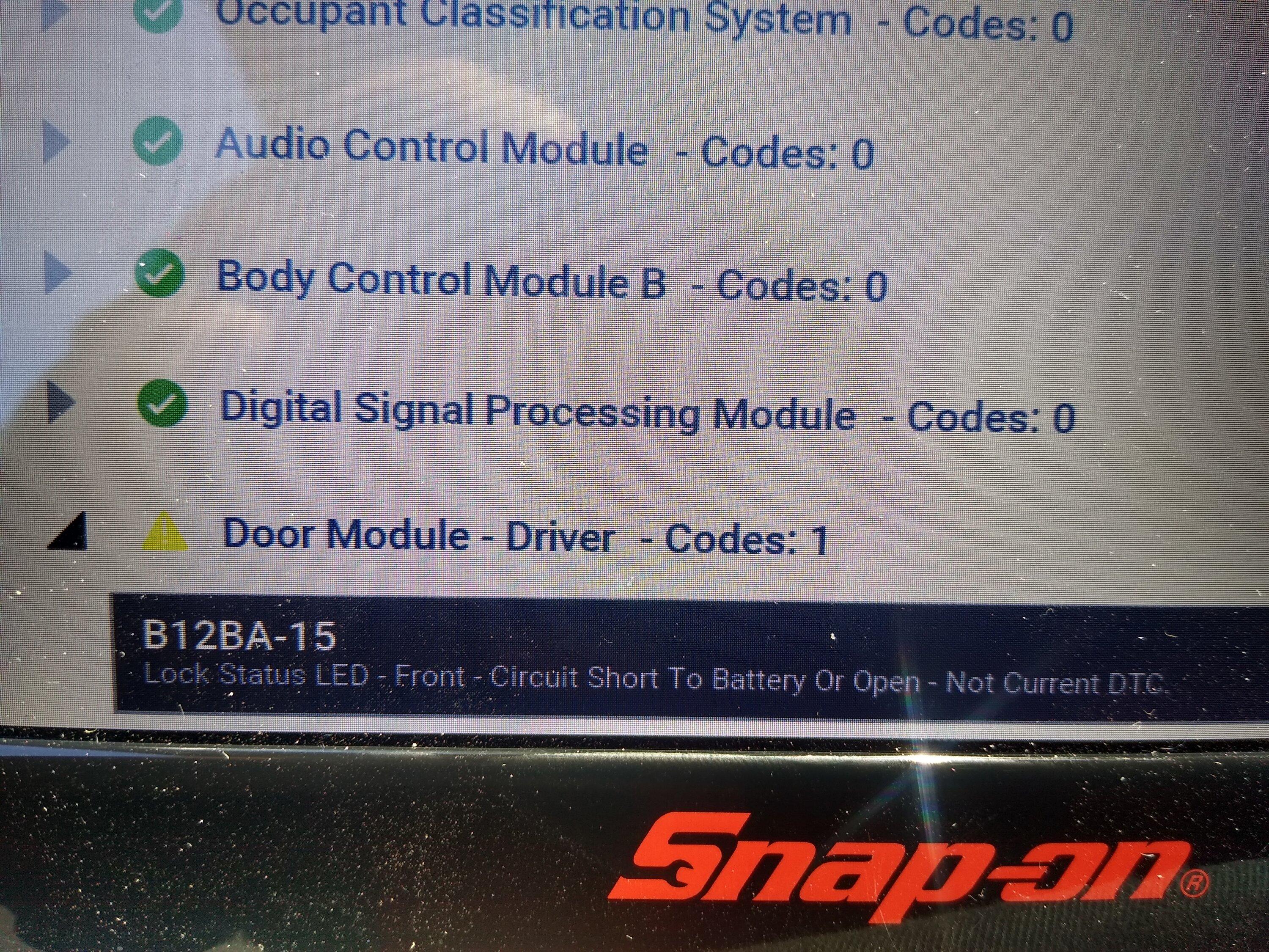

Taking Mrs Neg out to lunch Wednesday and the airbag light comes on
Won't reset after cycling the car
Took it to work yesterday, my Snap On Scanner has the latest software (24.2) but not everything to peek around in the computer, but it can pull the codes.
One is for a LED on the drivers door showing lock status, the second code is for the drivers side curtain airbag deployment module being wonky.
So off to the dealer it goes, the Monday after the 4th of July.
They said they could look at it on 7/3, but who the heck is going to be wanting to do this on the day before the holiday and if they get it apart and it needs a part it is going to sit waiting for it, so I'll drive it and give it to them on Monday 7/8 and hopefully I'll have it back for the weekend
S650 Mustang B12BA-15 and B1405-13 codes IMG_20240627_110914201

since I have a $3000 scan tool and the ability to clear stored and current codes, I chose to do what us professionals do and record the codes, erase, then see if they come back on
And it did come back, but after I had the roof down the code light went off, so if I go back in it is going to show as a stored code not an active one.
not knowing if having the roof down stops the deployment of the seat side airbags, I am going to leave it to someone who has access to Fords diagnostic trees to figure out if it is a glitch or a problem.
