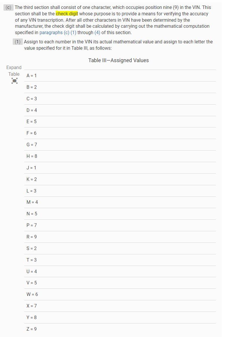

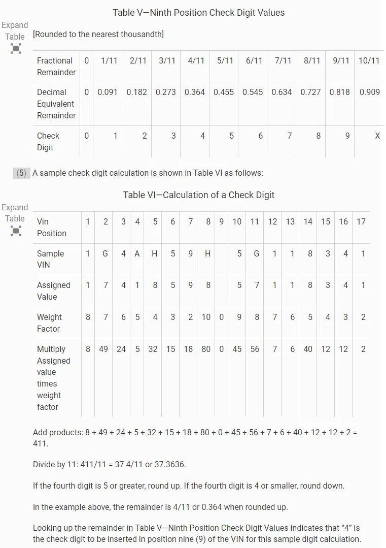

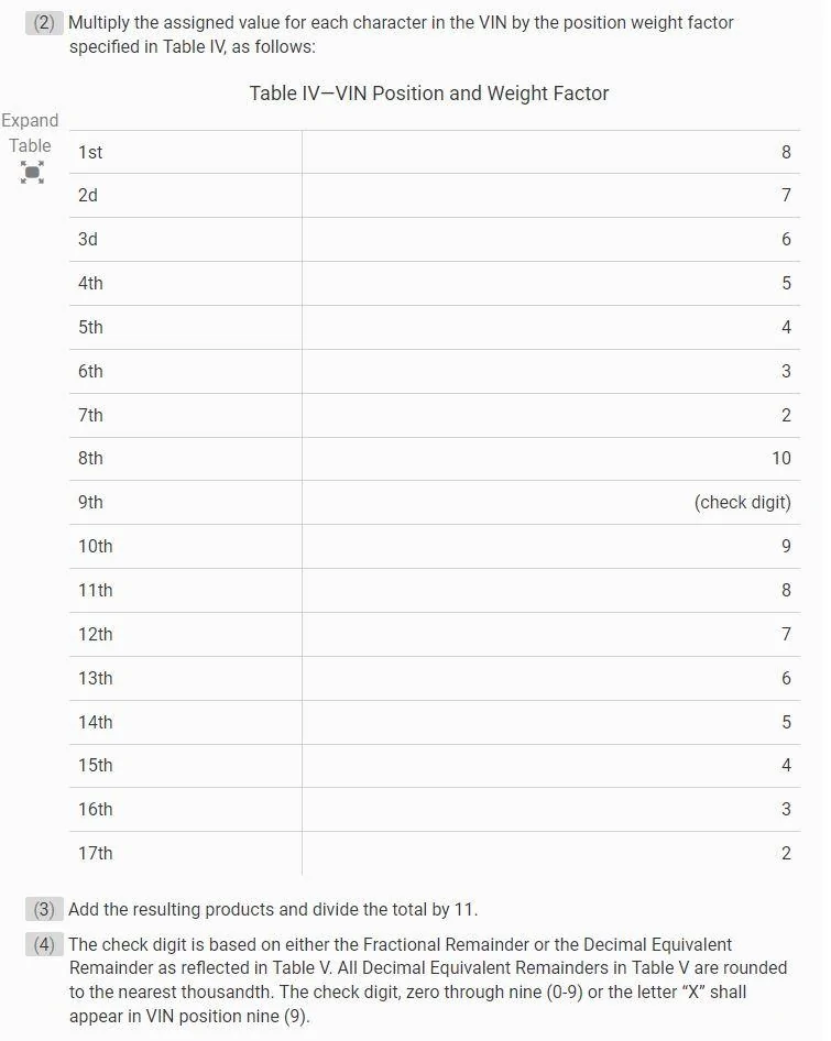

Thanks, that helps a be lot.
Our VIN had the extra “check digit” that was confusing me.
Btw, do you know what does the check digit stands for?
Mine is “8”
I wouldn't worry about the check digit, it gets involved in calculating it! :crazy:
S650 Mustang Australian Mustang VIN Decoder Captur
Part 565 says:
S650 Mustang Australian Mustang VIN Decoder Capture2
S650 Mustang Australian Mustang VIN Decoder Capture3
S650 Mustang Australian Mustang VIN Decoder Capture4
With all of that, I can't be bothered calculating mine!
