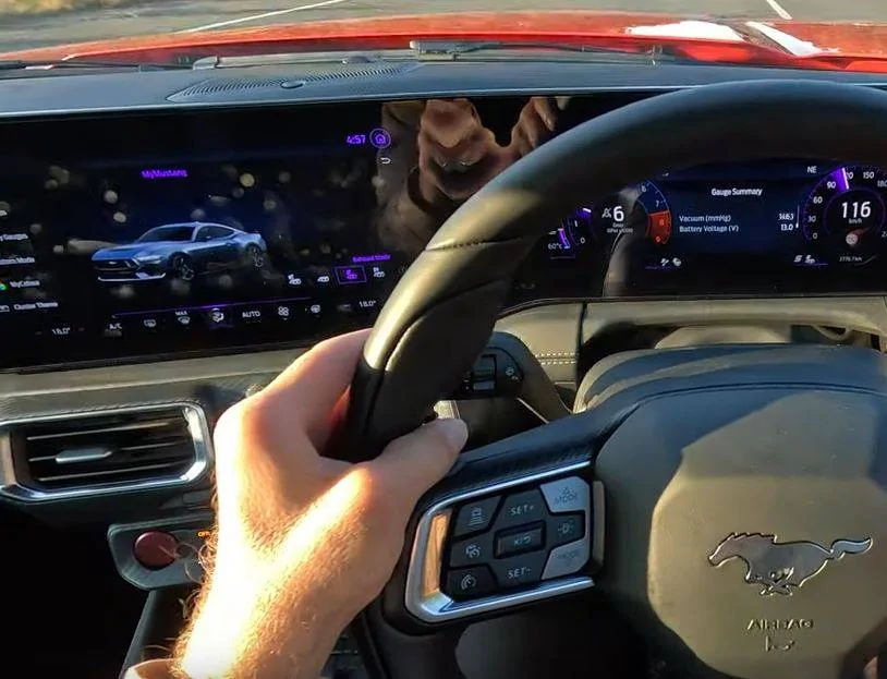

Australian 2024.50 Mustang reviews have recently appeared on Youtube.
In one of those videos, fingerprints on the 13.2" infotainment screen are very apparent.
S650 Mustang AUS - Touchscreen care and maintenance Captur
Time to consider how to clean the screens.

Not sure why there would be fingerprints on the left side of the glass. On the right side of the glass where there are touch screen icons, yes - which can be removed with a microfiber cloth wetted with clean water.

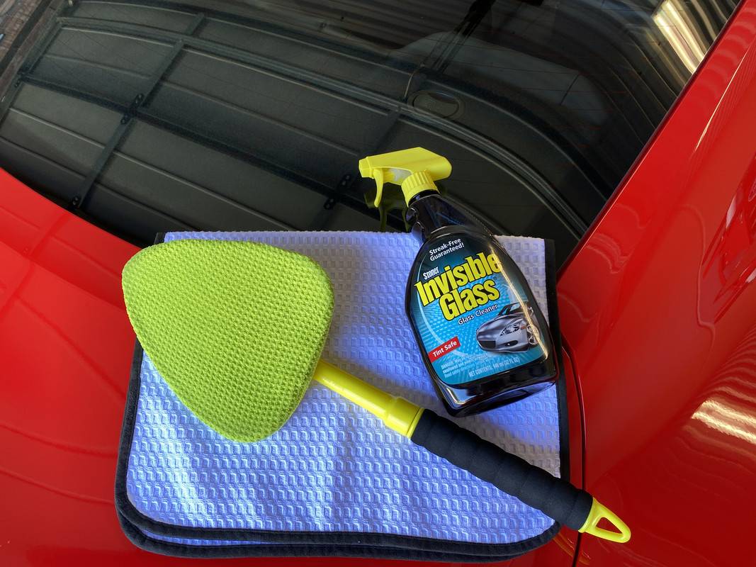

Glass Cleaner - probably the most obvious choice, just make sure that it is not ammonia-based like most Windex branded products are. For this application, and any automotive glass cleaning for the matter, you want something based on isopropyl alcohol. Stoner's Invisible Glass is a staple of mine and is readily available. I also really like P&S True Vue and Gyeon Q2M Glass Cleaner.

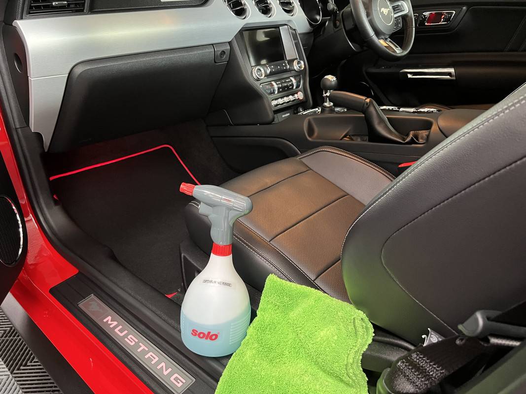

Rinse-less Wash - mixed at the standard dilution, these products are completely safe no matter how often you use them. I prefer the polymer-based products like Optimum No Rinse, P&S Absolute, in fact I would expect them to help limit fingerprints too. The surfactant-based McKee's N-914 and DIY Detail Rinse-less will also work. If you want something readily available, Bowden's have an option now as well.
S650 Mustang AUS - Touchscreen care and maintenance IMG-5480

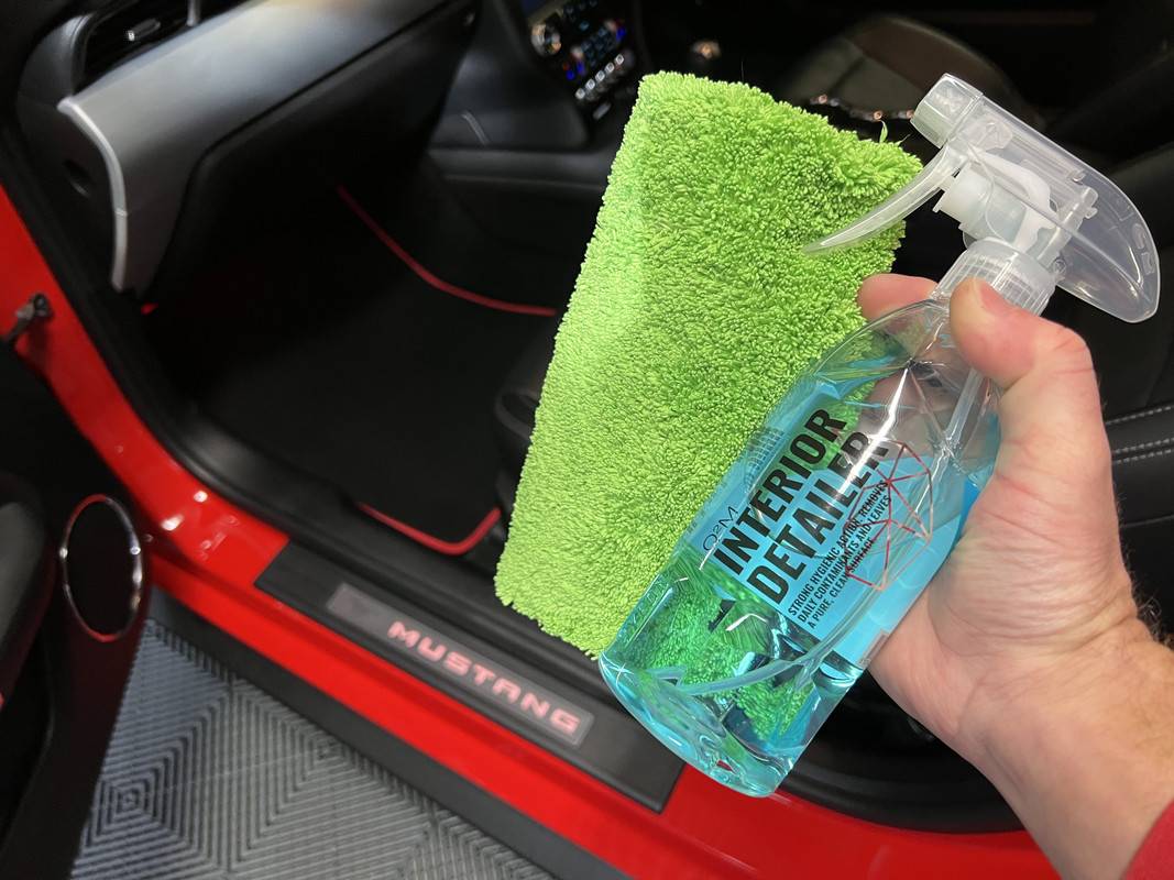

Interior Detailer - these products generally have an element of IPA in them, so they flash away to leave a streak free finish. For that reason, they work well on interior screens as well. I would say that some are better than others, I've found Carpro InnerQD, Koch Chemie ASC and Gyeon Interior Detailer have a higher IPA content and less "dressing" potential, so they don't leave streaks like, say, P&S Swift or Ethos Interior Detailer would.

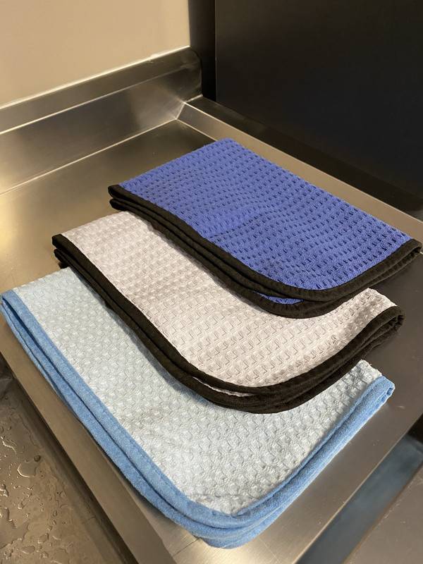

Towels - like any glass or glass-like surface, you want a low pile towel for this application to limit/prevent streaks. For glass, I'm a waffle weave sort of guy and favor the TRC Dry Me A River towels in small or medium size. But you could use any dedicated glass cleaning towel, or even the little suede coating applicators, which would be handy to stash in the center console.

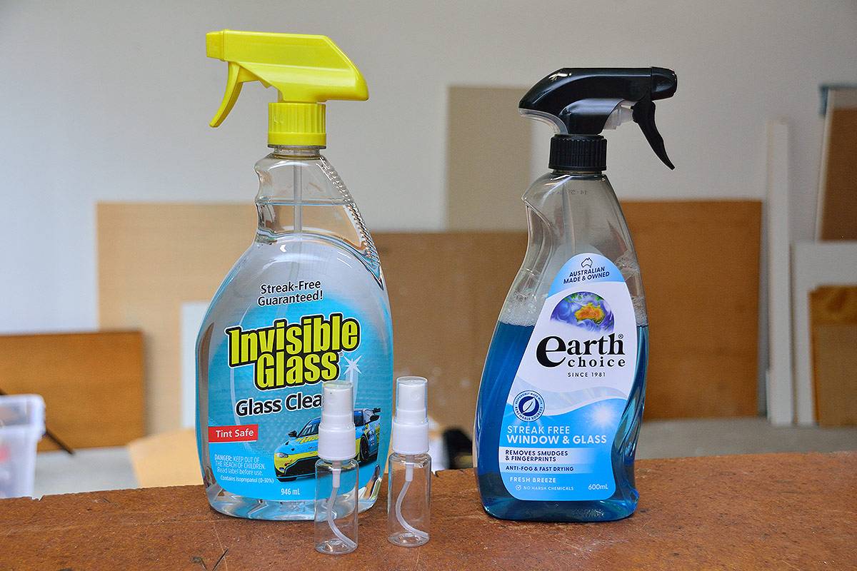

As per past advice, a bottle of Invisible Glass from SuperCheap (of all places!)
Nice to get decent things from a local big box store.
S650 Mustang AUS - Touchscreen care and maintenance _DSC1899_1200
Haven't had a chance to use it, as yet.

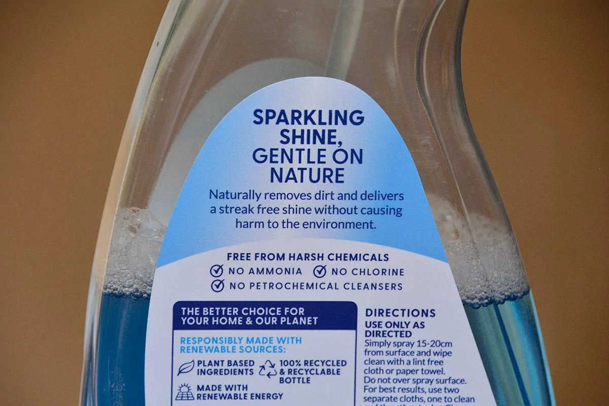

The Earth Choice window cleaner (Woolies and Coles) was tried on the RAV's windows, but produced disappointing results with regard to smearing and streaking.
Moving away from Windex, the appeal of this one was being ammonia free, inexpensive and readily available.
S650 Mustang AUS - Touchscreen care and maintenance _DSC1902_1200
I'll give this one last chance on the touchscreens, but otherwise it will be relegated back to doing house windows and mirrors only.

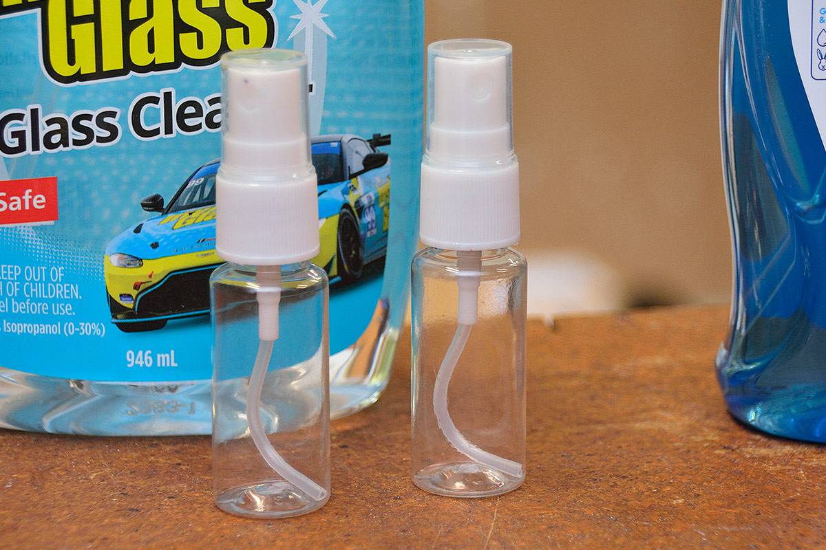

You'll also note the 20mL spray bottles from Amazon, one specifically to keep in the glovebox for the touchscreens, as per your suggestion.
Obviously from Aussie stock, because they were on my doorstep two days later!

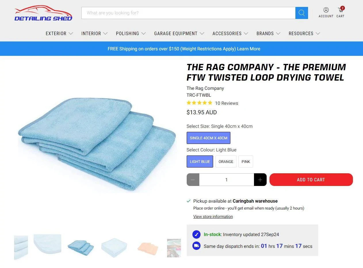

Edit:
Looks like, as of today, TRC FTW towel is back in stock.

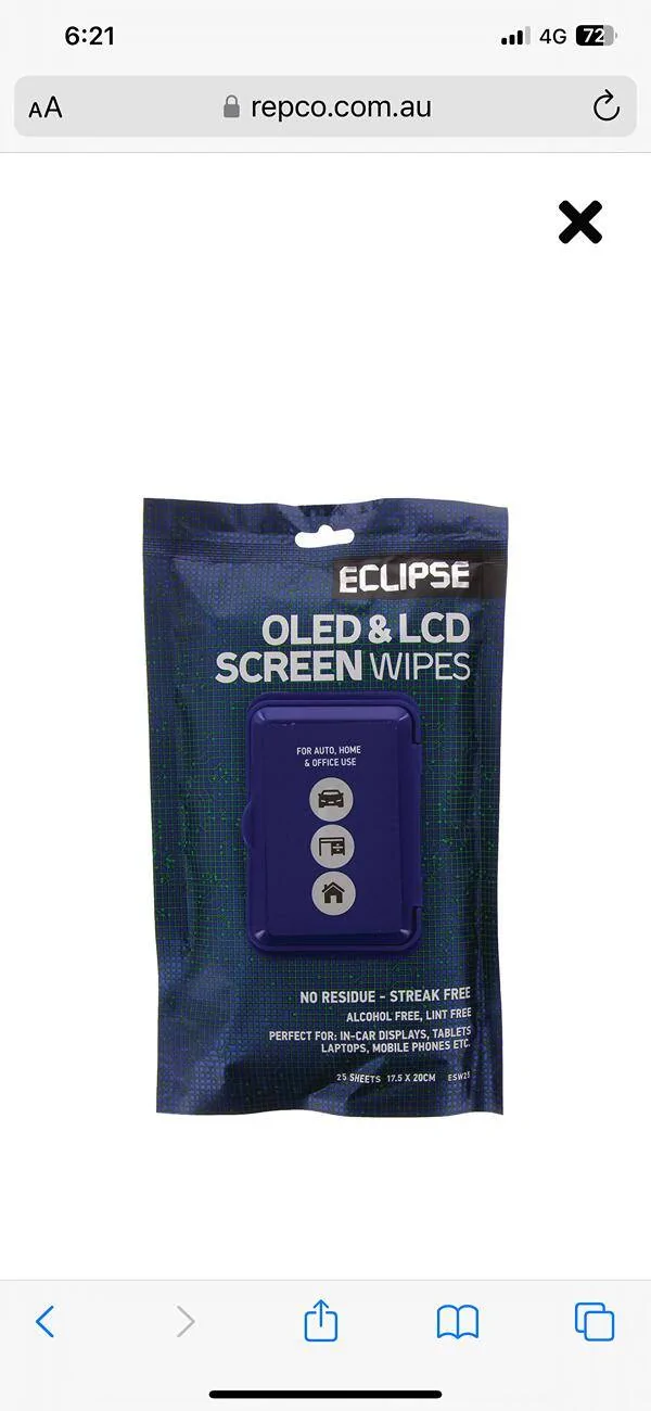

Try these tech and screen wipes
They work great on my laptop and s550 screen
