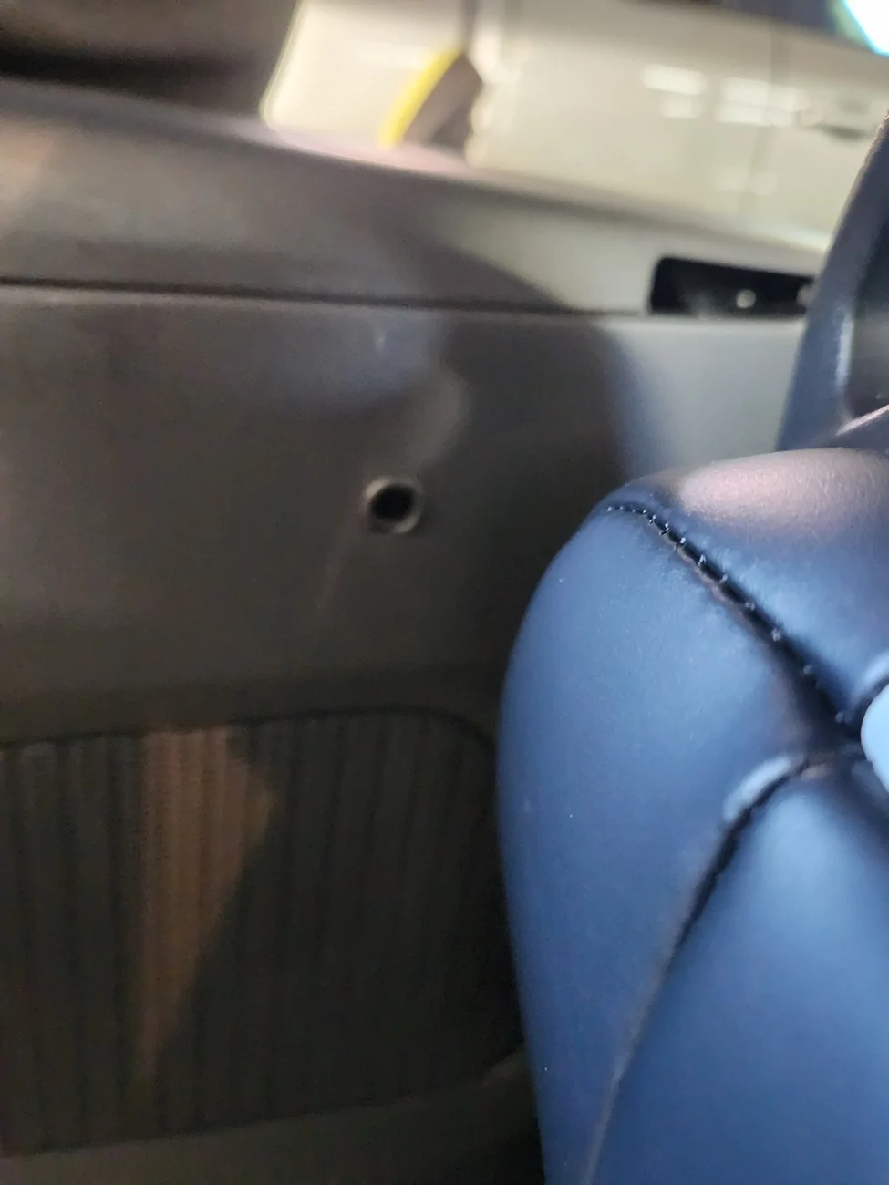

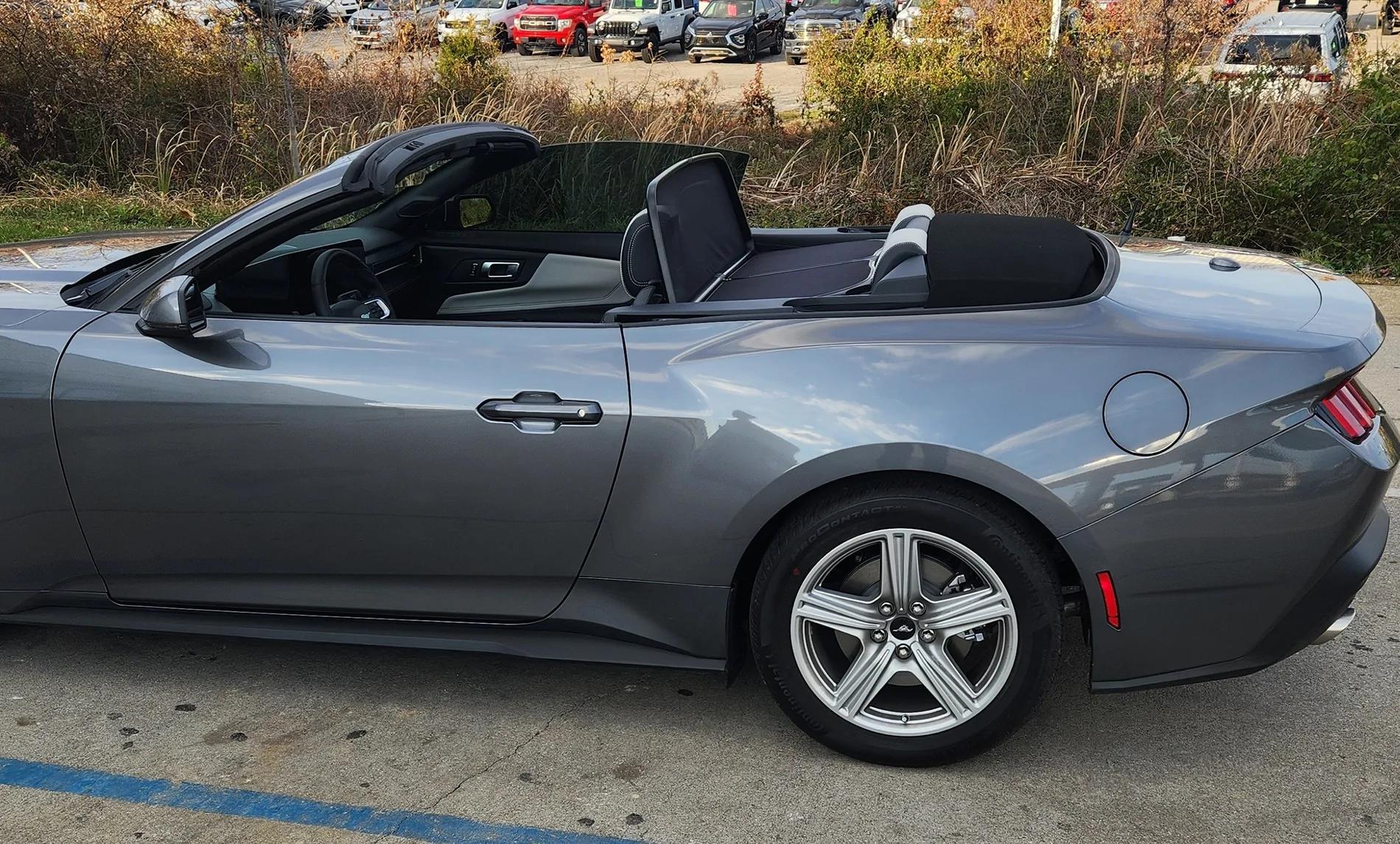

I mounted an A-4 wind screen on my 2026 ... I removed the trim covers to insure that I had clearance behind my mounting holes. After drilling the holes I installed rubber grommets. There was no interference behind my mounting hole locations.
Since I have 'memory' seats, I located the mounting holes to accomdate the seats all the way back.

Your holes are about where I had marked to drill mine. When I popped the top piece off for a look, the area I would have drilled into was full of electronics. Yikes! Maybe our cars are optioned differently. I didn't have the electronic stuff there on my '19.
Your install looks great! Thanks.
