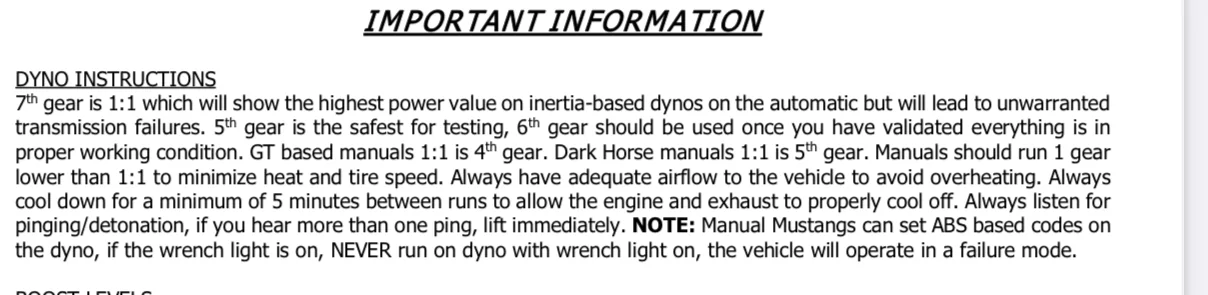

Also dynoing in 7th gear is a no-no
Yep, that is one reason why I emphasized that fact in my post. The other was that seventh gear should show the highest horsepower and torque numbers, as the first line shows, which makes the 629 hp figure even worse.
