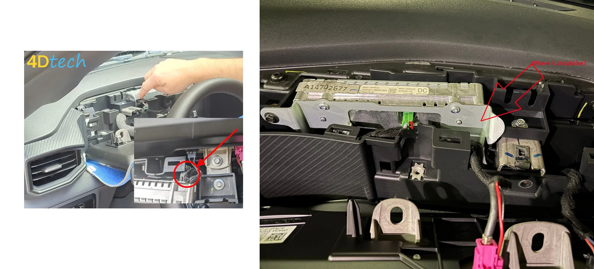

Hello, took delivery of my GT a few weeks ago and wanted to install the 4D Tech Auto stop/start Eliminator.
Was wanting to see if any RHD owners have installed it?

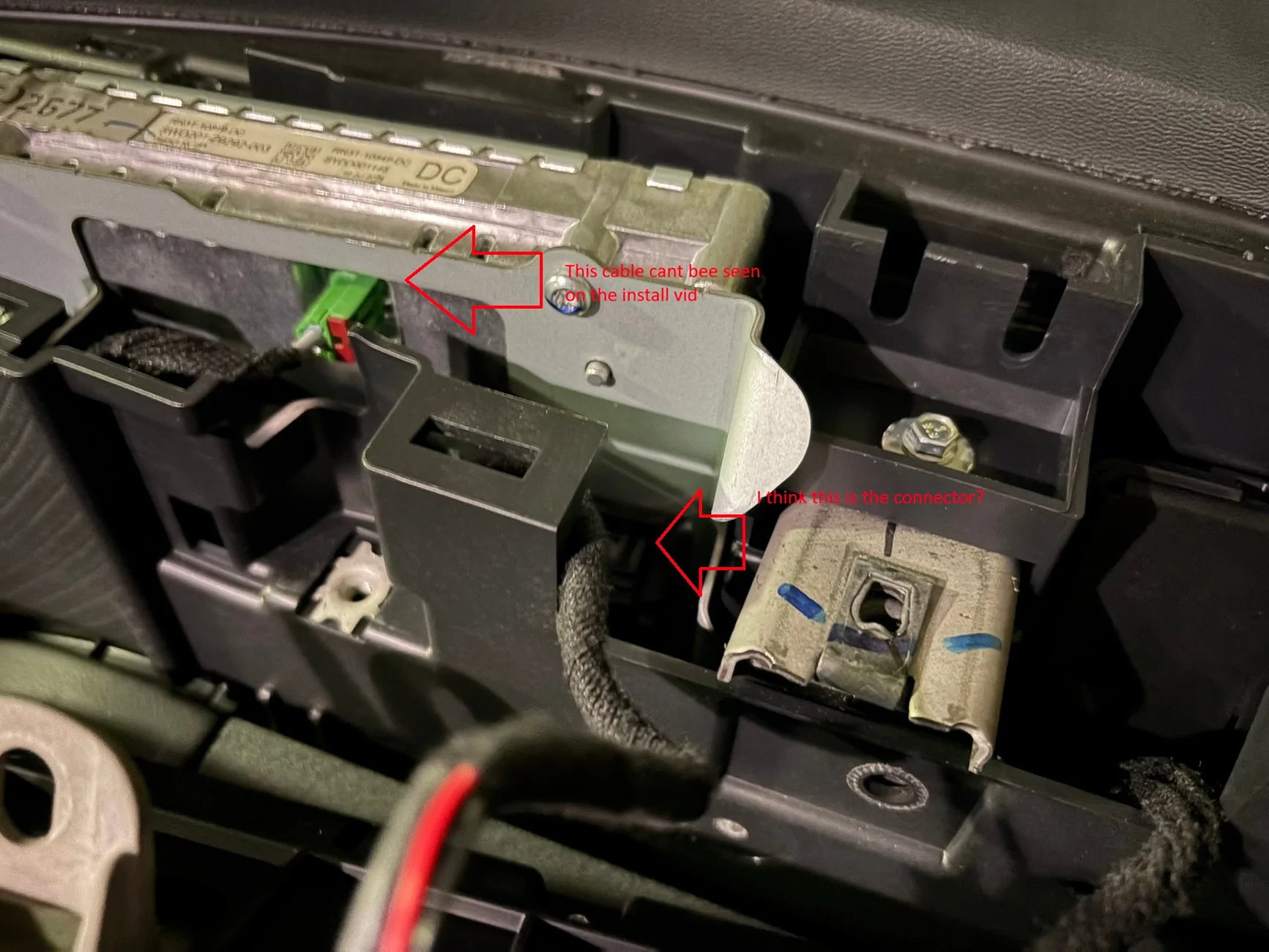

I tried to install it this morning, took all the trim and screens off but wasn't able to locate the cable required for the harness to connect into.
I compared my disassembled dash to the 4D Tech install video and think what's happened is in the conversion from LHD to RHD, the module the cable connects to has been rotated, causing the cable to be on the bottom right instead of the top left, making it much more difficult to access the cable, and more than I'm willing to do (requires a lot more disassembly of the dash internals to reach). I can see a connector in the bottom right marked in the attached pic that I think is the cable, but the green connector isn't even present in the install video, if it has indeed been rotated then it would be on the bottom in the LHD version explaining why I cant see it in their video.
Before I try to get a refund, wanted to see if anyone else has encountered this?

I would contact them and ask about this to confirm. That might very well be the issue. Make sure the assembly process works with your vehicle.

The supplier got back to me and is going to issue a refund which I'm happy with. They haven't heard about this issue, but the amount of RHD owners buying the item is probably very small so that makes sense. Thought this might help any RHD owners if they were thinking of getting it for their Mustang.
