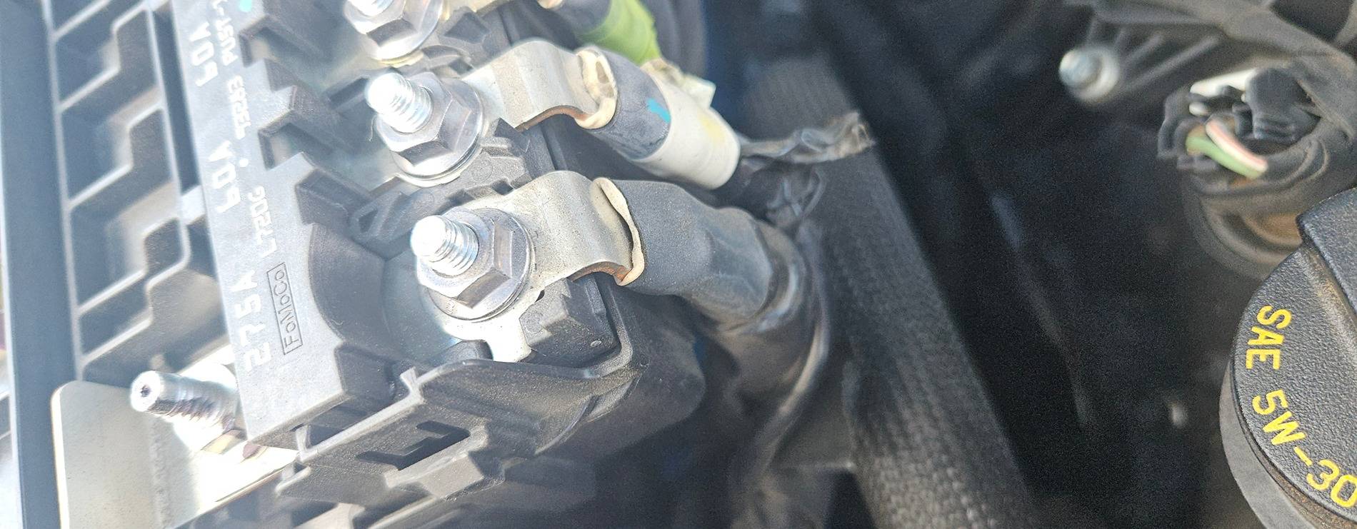

i checked on my Mustang and the alternator fuse is rated for 275A, so logic dictates that the cable itself can handle more than that; after all, there is no use in putting such a high amperage fuse if the cable it's attached to fails sooner than that
I'm wondering if the DarkHorse alternator isn't 275 Amps. I had read very few comments online that suggested that the PP or DH alternators were at that mark. Could be wrong.
I agree though with what you said.
