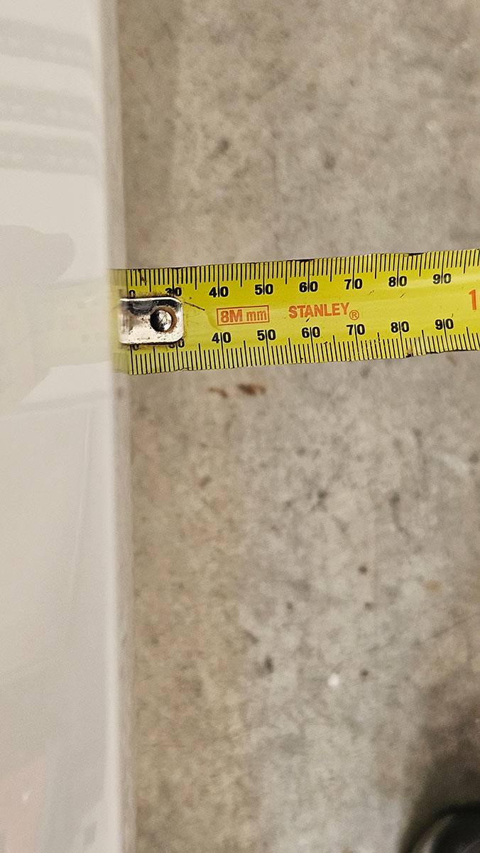

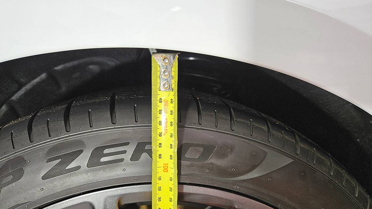

Are these images useful to you Deano?
Rear ~20mm
S650 Mustang 2024 Mustang Australia (AU) Pricing and Timing Schedule 20241021_155649_1200

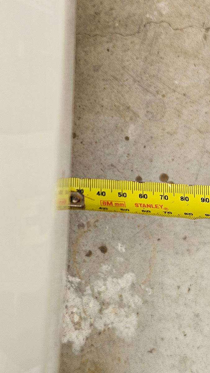

Front ~25mm
S650 Mustang 2024 Mustang Australia (AU) Pricing and Timing Schedule 20241021_155832_1200
Gotta love ALM's concrete slab in the garage. :blush:
Method: Tape measure straight out, and camera looking straight down at 90°.
S650 Mustang 2024 Mustang Australia (AU) Pricing and Timing Schedule 20241021_155737_1200

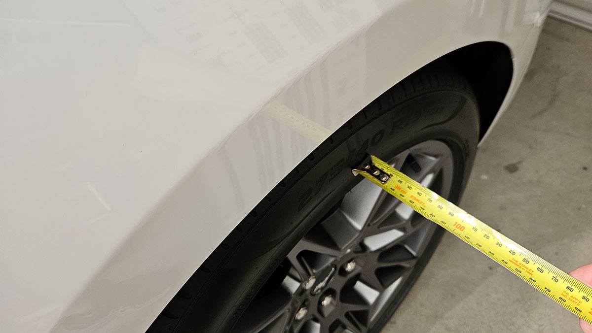

Vertical clearance at front:
S650 Mustang 2024 Mustang Australia (AU) Pricing and Timing Schedule 20241021_160025_1200

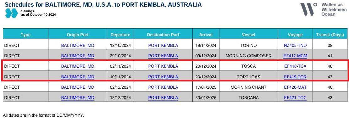

The ETA is just an estimate but it's hovered around 21st to 24th Dec since June and I'm hoping it'll be on one of these two vessels (preferably the Tosca)
S650 Mustang 2024 Mustang Australia (AU) Pricing and Timing Schedule 1729495811654-bx
Edit: ETA is to the dealer, it'll take them a few days to prep it

Brilliant, thank you ALM reckon 15mm is prob the way to go to avoid scrubbing on the inside lip
Just be careful and do your research. With the S550's, the studs were different between the Magneride cars and the standard cars. I think you had to use at least a 1 inch spacer if you wanted to avoid cutting the studs.
Also spacers are illegal in Australia. I know many people that use them and none that I know off have ever had a problem, but better to be aware of it.

Thanks bfets will keep an eye out for it. Sounds like I should take it somewhere and check it instead of ordering online and doing it myself.
