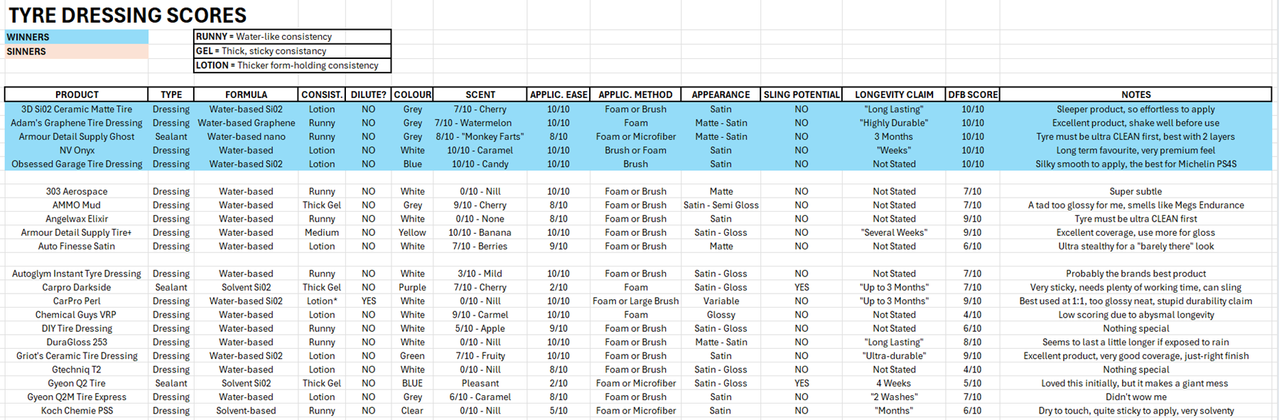

Following the same formula as the soap spreadsheet, this is a collation of every tyre dressing I've used since 2003. Again, this is a condensed version of my thread on the topic -
The Tyre Dressing Form Guide | 2015+ S550 Mustang Forum (GT, EcoBoost, GT350, GT500, Bullitt, Mach 1) - Mustang6G.com
Just keep in mind that tyre dressing appearance is subjective. From my point of view, I don't want that super glossy "wet look" for cosmetic reasons, but also because gloss typically translates to sling. Having said that, I want to see a before and after, so a completely matte finish doesn't win me over either. My preference therefore is somewhere in between, a satin finish. So, my overall rating number probably reflect that view. Having said that, the spreadsheet provides a wide range of attributes, and hopefully you can get something out of it no matter your preference.
S650 Mustang DFB's Tire Dressing Spreadsheet T1TD
S650 Mustang DFB's Tire Dressing Spreadsheet T2TD

listen, you do you, but i'm mildly concerned about the scent of "monkey farts" getting an 8/10 rating

Great list, I’ll definitely be picking from it for my next purchase. Though kind of hard to test and would probably take a while, my (and I’m sure many others) biggest concerned with is the durability of the product. So it would great if there was a proper durability rating rather than just taking the manufacturer’s word for it. Even if you just do the rating for your favorite ones, it would be useful info. With that being said, was there one (or a few) that stood out for being more durable than the rest?

I was wondering when someone would notice that. :giggle:
"Monkey Farts" is the official name of the scent according to the company owner. Doesn't sound very appealing does it. 🤔

I seriously considered having a separate column for real world durability, but I decided to leave it out for a couple of reasons -
1. I apply dressing after each wash, because I can, and because I love this step of the process. Because of that, I simply can't comment on longevity.
2. Apart from the daily driver, my cars are garage queens, and they are never driven on wet in the rain or even on wet roads. Providing a figure on longevity under this use-case scenario would be of limited value.
I instead provided the manufacturers claim or wording on the subject, then made not if I observed below average durability in the comments section.
Finally, and I may ruffle feathers with this, but......................
There seems to be an expectation or need for a tire dressing to last a long time. But what does “a long time” mean? A few days, a week, months, a year?
I’m willing to bet that most detailing enthusiasts are applying a tire dressing after each wash. Just like using a drying aid, why does longevity even matter when you reapply every wash? I mention this because I often see people dismissing or complaining about xyz tire dressing not lasting long enough, often several weeks after application. What? Why?
To be realistic, most water-based tire dressings will not hold up to wet roads, let alone a wash. Solvent based dressings will hang on longer, but you end up with a tire covered in a greasy, dirty residue that is harder to remove and stains your brushes. Tire coatings are the happy middle ground, but again, you are at the mercy of mother nature and the harsh conditions a tire is subjected to.
So, that's my thinking/reasoning behind leaving observed longevity out of it.

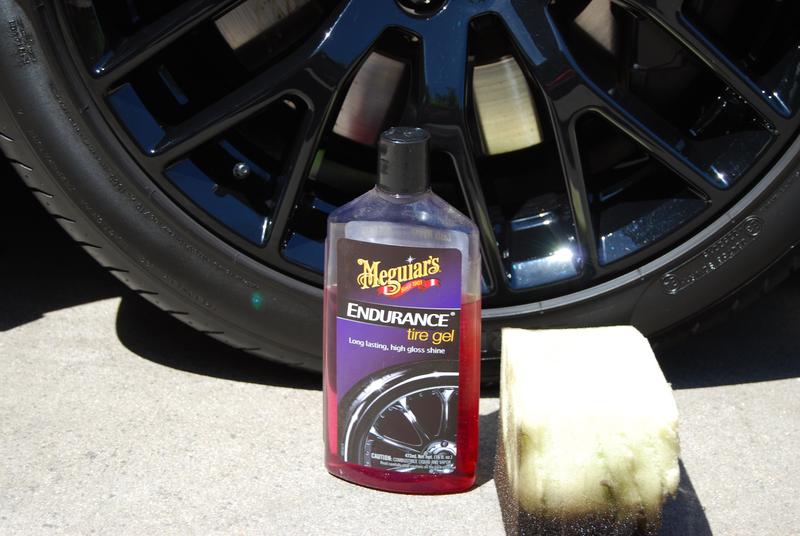

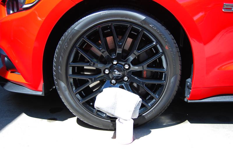

Meguiar's Endurance -
S650 Mustang DFB's Tire Dressing Spreadsheet DSC-0103
S650 Mustang DFB's Tire Dressing Spreadsheet DSC-0101

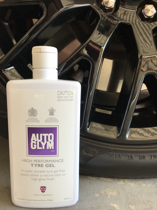

Autoglym High Performance Tyre Gel -
S650 Mustang DFB's Tire Dressing Spreadsheet IMG-E2060
S650 Mustang DFB's Tire Dressing Spreadsheet IMG-E2064

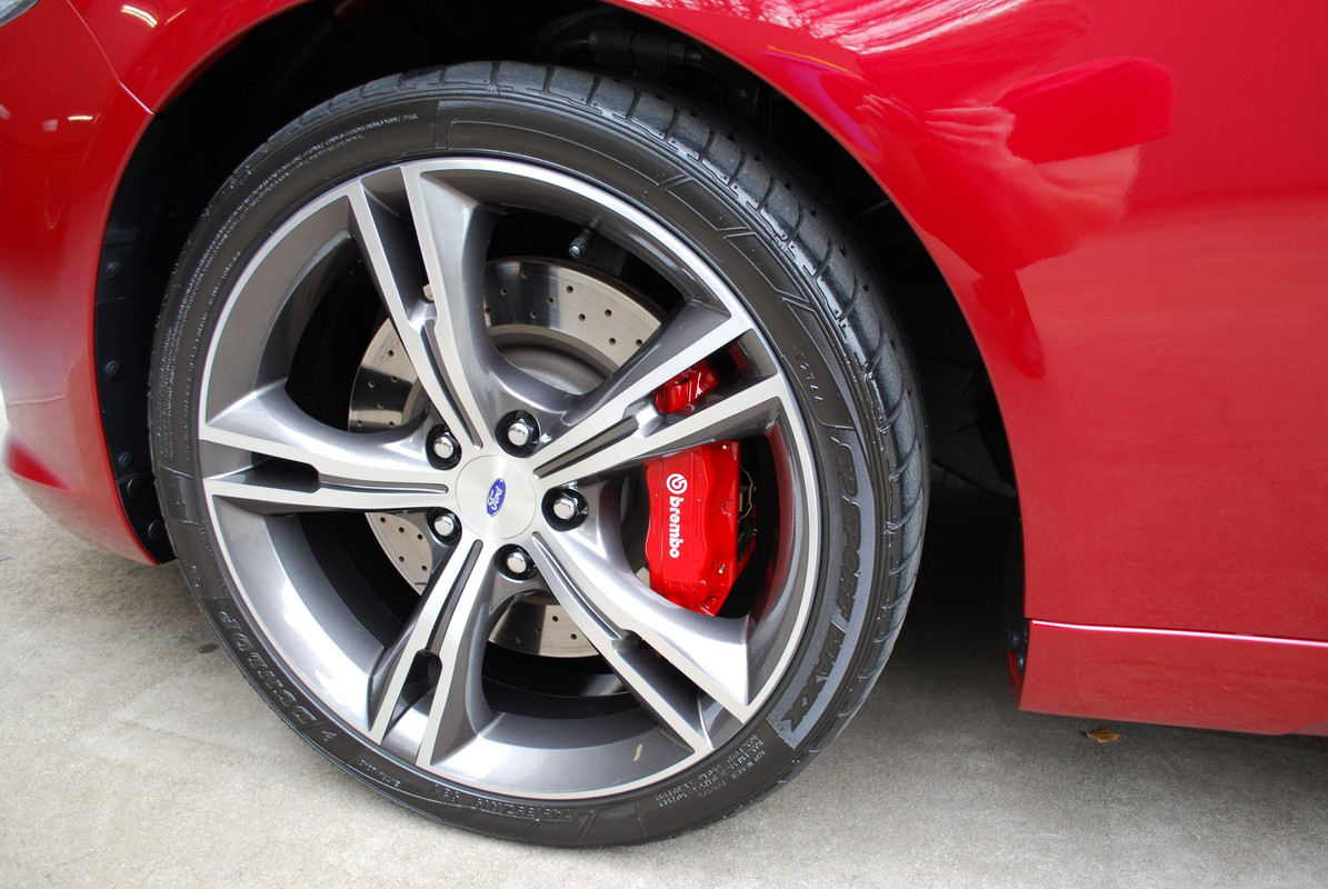

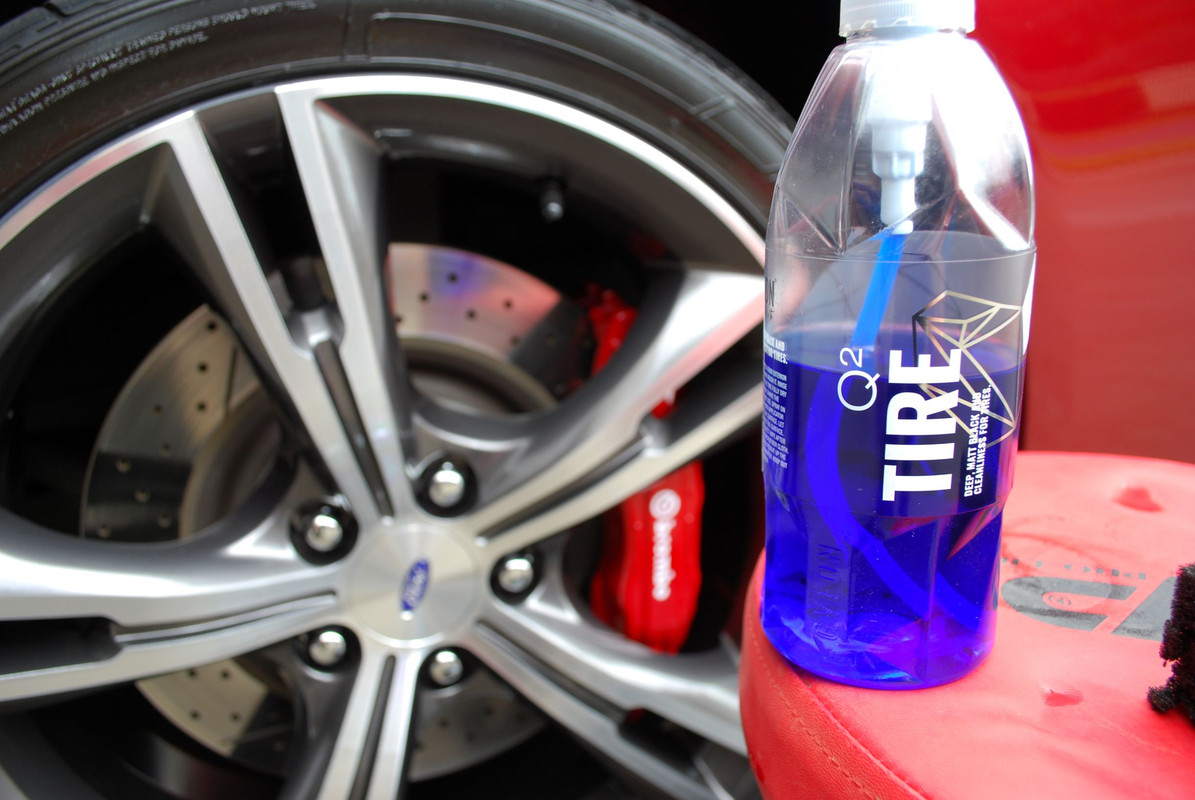

Gyeon Q2 Tire -
S650 Mustang DFB's Tire Dressing Spreadsheet x333333333
While a solvent-based dressing like Endurance can look amazing right after application, it only goes downhill from there. I'm talking about the fact they don't fully dry, so the hold onto dust and road grime, which causes a discoloured brown appearance. The funk gets all over your wheel and tire cleaning tools, and gunks up applicators. Then there is the sling potential, and leaving marks on my car covers. The final straw was brushing past a tire with my favourite jeans on, which promptly transferred black stains onto them. From then on, solvent based dressings have been (mostly) outlawed in my cabinet.
