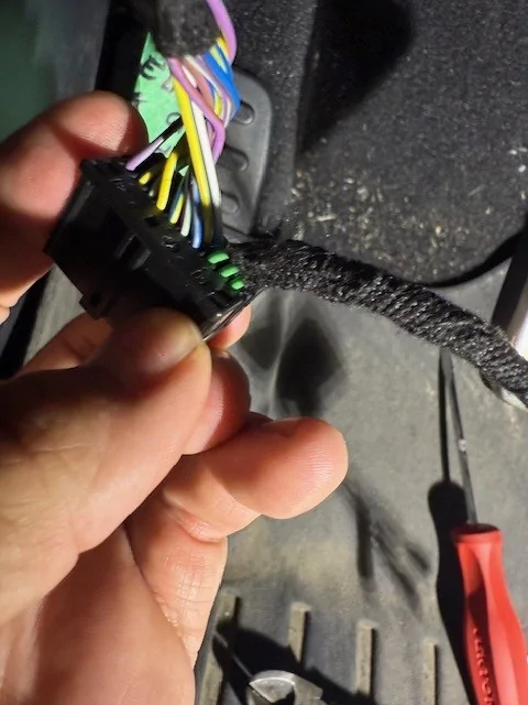

Do wiring, when looking at the IPMA from the foot well it’s the second connecter from the top. PIN 9 FRONT radar Ground
PIN 18 FRONT radar positive power
PIN 19 RADAR CAN BUS LOW
PIN 20 RADAR CAN BUS HIGH
Unclip the lock and insert the terminals in as in the instructions for the TYCO electronics Generation Y Connecter instruction sheet 408-10372 (google that)
The Radar pigtail I just searched on eBay and found a knock off, seems to work just fine!
Pin 1 Positive Power (Pin 18 from IPMA)
Pin 2 CAN LOW (Pin 19 from IPMA)
Pin 3 CAN HIGH (Pin 20 from IPMA)
Pin 4 Ground (Pin 9 from IPMA)
I ran the wires through the firewall just above the gas pedal.

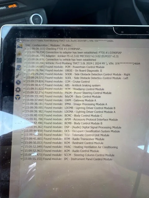

Go into IPMA module configuration and search for “cruise” change radar to “present” and cruise to “radar fusion”.
Restart FORSCAN do not load a profile, objective here is to get the “CCM” module to show up. If your wiring is not correct you will have no “CCM” module and IPMA DTCs like “CCM” short or open, and other related to communication errors under IPMA. When your wiring is correct, you should see the CCM pop up with 2 DTC’s 1 DTC will read invalid VIN number, second DTC should be alignment and configuration missing. You may see other DTC’s in IPMA and ABS (ABS DTCs did not pop up for me until later).
Open the CCM module ASBUILT data and replace the numbers with your VIN data (nothing else to change in here). Clear all DTC’s restart FORSCAN. You now should have 1 DTC in the CCM, Alignment / no configuration present.

Restart FORSCAN you should see your BLISS (Blind spot information system) warning light come on, LKAS (Lane keep Assist System) warning light and now, maybe an adaptive cruise control not available warning. New DTCs under (BLISS sensors) SODL and SODR about VIN mismatch.
Open ASBUILT data for ABS replace the Premium VIN data with your VIN you wrote down at the start. Open ASBUILT data for IPMA replace the Premium VIN data with the IPMA data you wrote down at the start. Next Open module configuration IPMA, search for BLIND you should see 2 items for the BLISS select them and change them from network to HARDWIRE. I have no idea why Ford did this.
Open your GWM module and restore the ASBUILT data. Not sure why the premium VIN was transferred to this module. I only found this out when my Ford Pass app was not working.
Restart FORSCAN the BLISS warning light should now be gone, the BLISS DTCs should be gone! The last DTC you should see is the CCM alignment / configuration; however, you still have 1 warning light on saying forward collision is not working.
