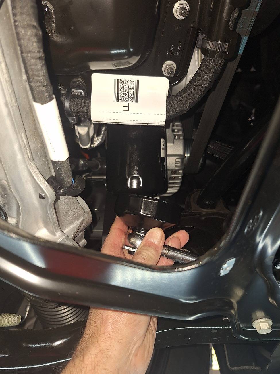

Changed the oil this weekend...10 qts Royal Purple HPS (High Performance Street) along with Fram XG10575 Oil Filter. And yes, I changed the oil life setting.
Lots of 7mm screws to remove to get to the filter but it didn't take long at all. I learned from a YT poster to cover the old filter with the open end of a plastic bag to remove the filter and not spill any oil on anything.

Been changing my own oil for 45 years and tried the bag trick for the first time and it leaked down the outside if the bag and then onto my wrist and part of the cars framework. Had great access with th car up on my lift too. As I turned the filter the bag did not stay close enough to the housing. I have always used a piece of tinfoil to cover what ever I might make a mess on and will not be doing the bag trick in the future. Glad it worked for you.
