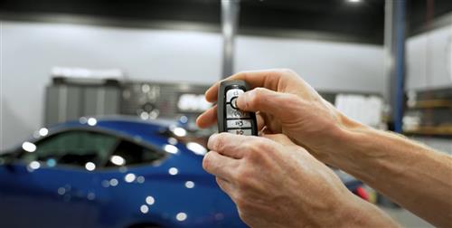

  2. Press the unlock button on the remote control.
    S650 Mustang How To Use 2024 Mustang Remote Rev ow-to-use-2024-mustang-remote-rev-feature_2a4f454f

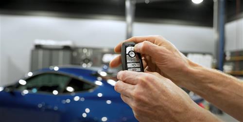

  3. Within 3 seconds, press the lock button on the remote control. (Engine RPM quickly increases to confirm that the feature is enabled)
    S650 Mustang How To Use 2024 Mustang Remote Rev ow-to-use-2024-mustang-remote-rev-feature_c6b9bba5
