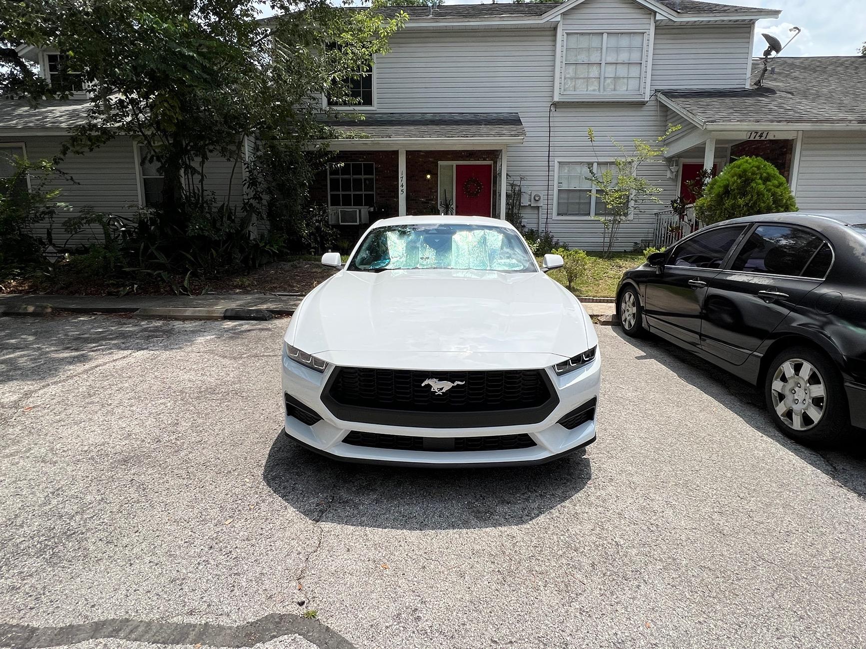

My OCD locked in on my front gaps after seeing that video on how "easy" the fix is (it isn't). After settling for the 11th version, I learned what the main engineering problem is: the front bumper/hood cone.
Lowering the front hood hinge about 2mm solved 99% of that wacky front misalignment, but then you're left with this:
S650 Mustang 1 year further and still bad panels IMG_6332
Perfectly aligned/flush at each edge (and nearly flush at hood center) but the cone doesn't follow the curve of the hood at the other locations.
The front looked great, but I moved on from version 7 because couldn't stand that "ledge".

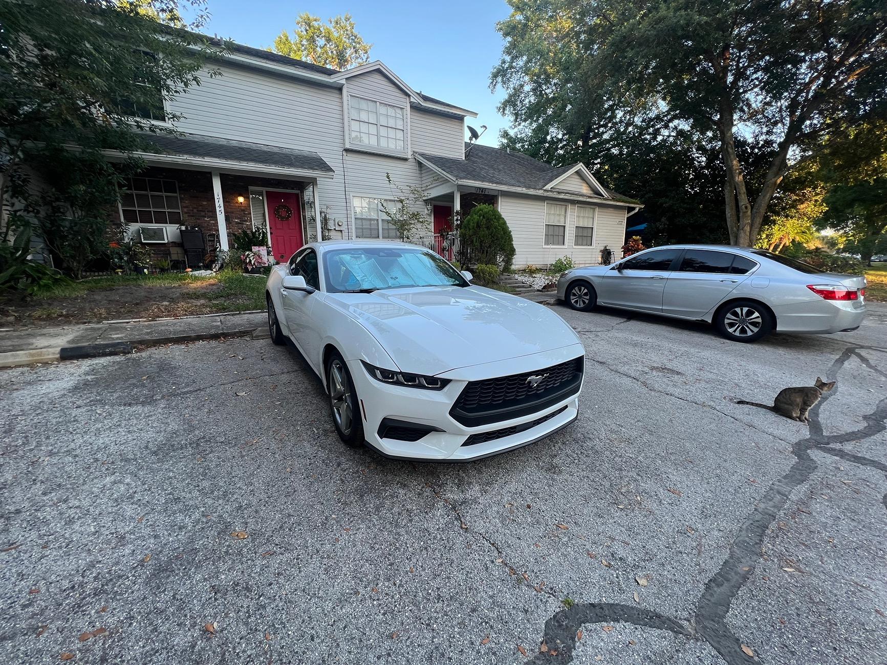

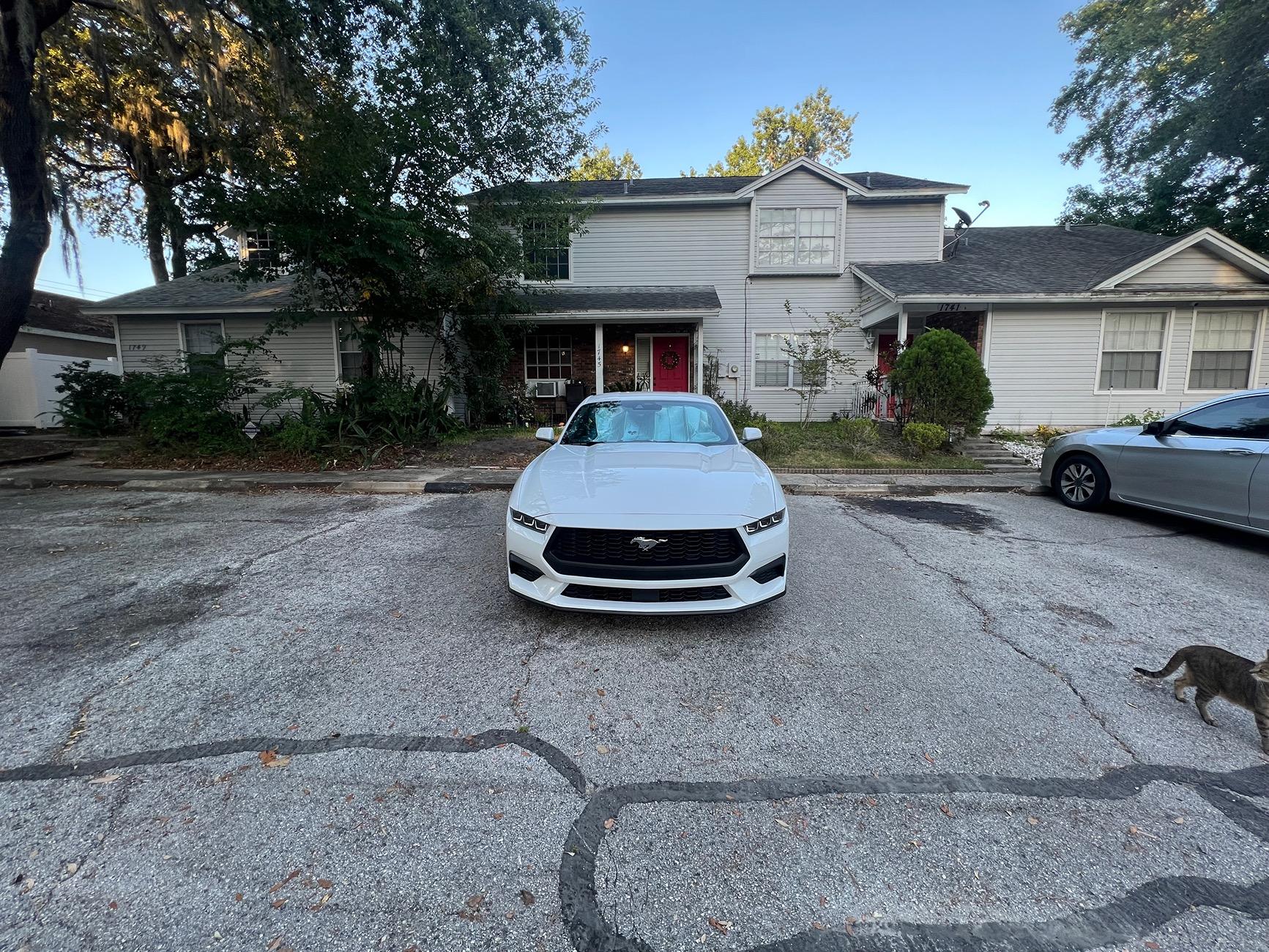

The front after lowering the hood hinge. If you can stand the ledge from the other angle this adjustment will solve most of the issues from the frontal view.

This looks more acceptable, but there is an issue with the hoodcone or the bumper. As you said, the lines don't follow each other correctly. It's something you can adjust to make it look acceptable, but it isn't hiw it should be. This is something Ford will never fix because otherwise they have to remodel the whole thing, cancel all the bumpers that are already made and produce new ones.

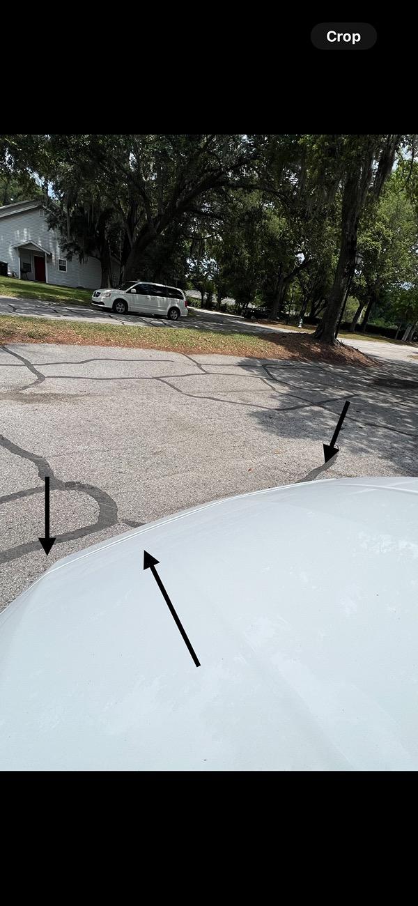

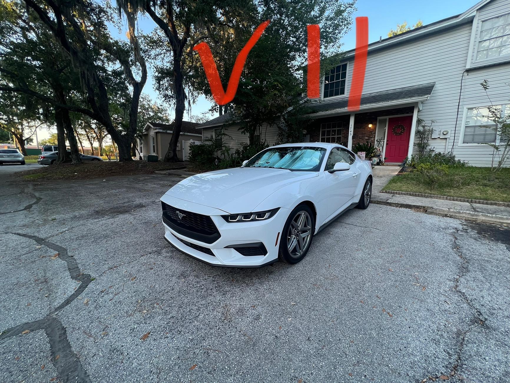

Agree on all points, trying to reach perfection was a hilarious exercise that reached the perfect level of compromise after 11 versions.
But it sucks we're in a position to even have to make that compromise. Here is V11 after I did the multiple adjustments available along with some creative improvised fixes.

This is the best fix I've seen so far. Happy that you managed to do so. A white car showed the gaps even more because of the black lines. This should be fixed by the dealer. I really would be ashamed to show my car to friends with crazy panel gaps especially if others have the same eye as mine and ask me about what happend to my car because of the gaps. Those gaps occur when you have an accident and they try to fit a new bumper on your car, but a brand new car that comes like this is really CRAZY!
