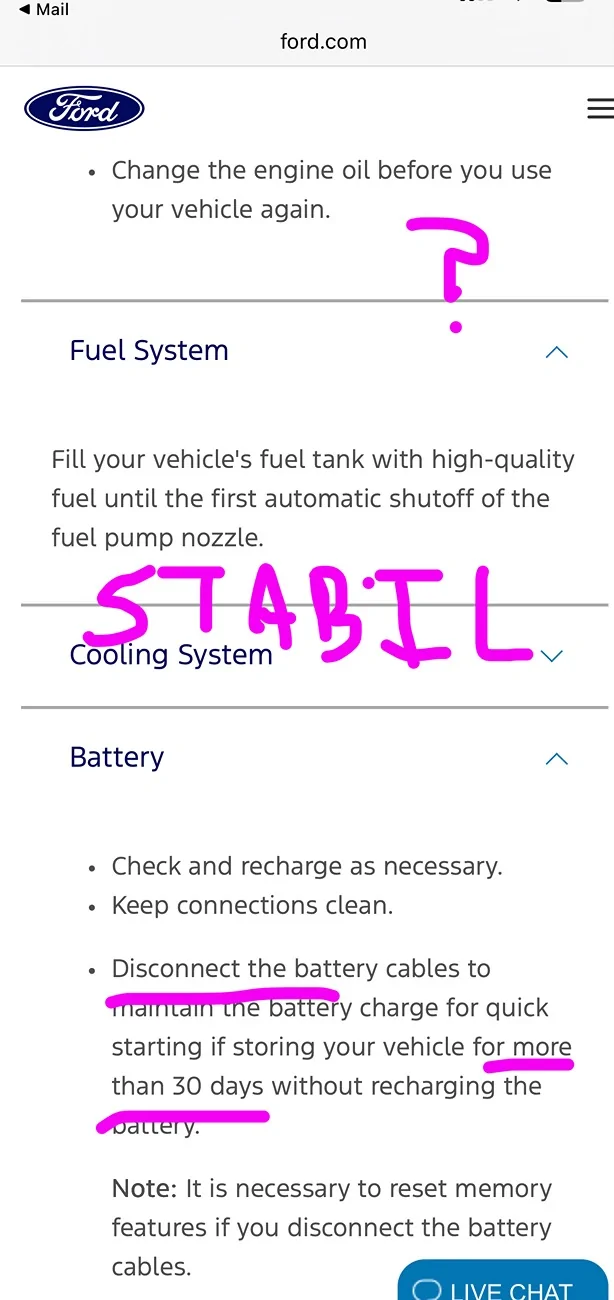

If you're parking it for 3-6 months (depends how long your winter is) just disconnect the battery
They tell you to disconnect the battery in their instructions as well. It just makes zero sense to start it every two weeks.
They also don't mention fuel stabilizer at all.
If your car isn't driven every day in the summer and you haven't driven it in two weeks, would you go start it just to run it for 15 minutes, just because you have not driven it? (maybe it's a convertible and weather has been bad, or you were on vacation, or just busy...)
They also want you to change the oil afterwards? These directions are storing for 30 days or more.
