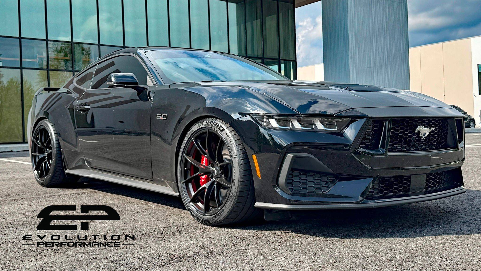

19x10" ET40 all around is a nice day to day setup, works with a number of different tire sizes, with plenty of tire models to choose from in those sizes.
If you plan on making some more power, a staggered 19x10/11" combo helps with straight line traction.
The S650 really works well with 20" wheels too, but ride quality isn't as nice compared to 19s or even 18s. Evolution Performance puts together a really sweet package for these cars, pictured below.
S650 Mustang What size rim can I change too? 7b5377f5fbd15ac53e3f6f2076cf4a1f39ebd469-2048x1154
