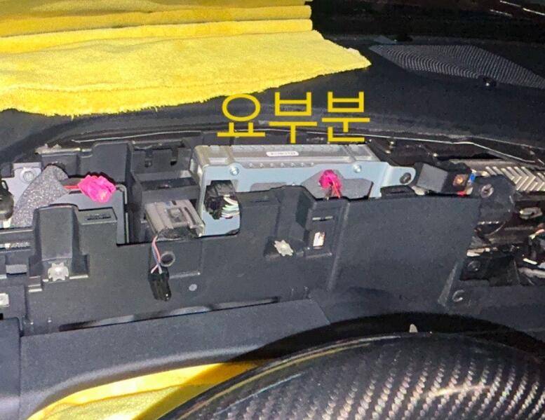

kyeom
Nov 4, 2024
s korea
mustang2024
S650 Mustang Weird rattling noise unable to pin point 1742525228149-k4
The marked product and the three pins that hold the display make a sound. It can be solved with sound absorption.
Words can be strange because I use a translator.
