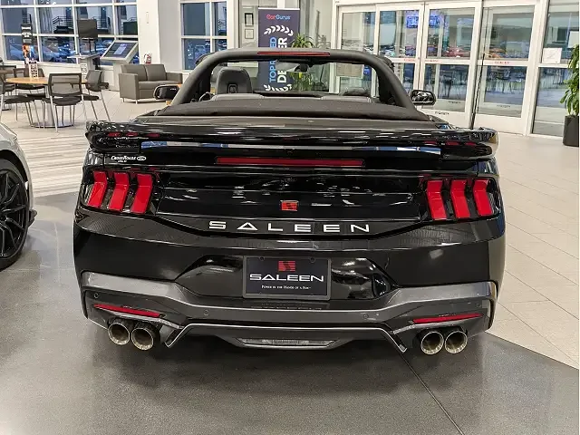

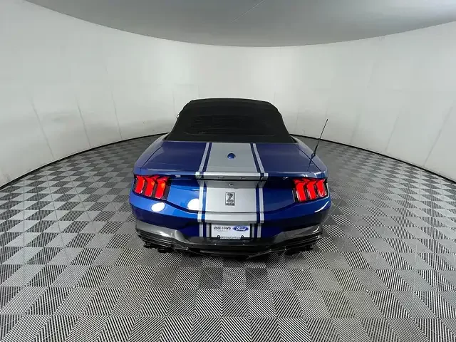

There is a post (27) Thoughts on moving Convertible 3rd brake light? | Mustang7G - 2024+ S650 Mustang Forum (Dark Horse, GT, EcoBoost, GT500, GT350, Mach 1) on this.
you cannot in USA move the brake light down. I actually saw a convertible with duckbill spoiler Shelby is hard to see it but there is one on it (the one I saw was white cannot find it now)
