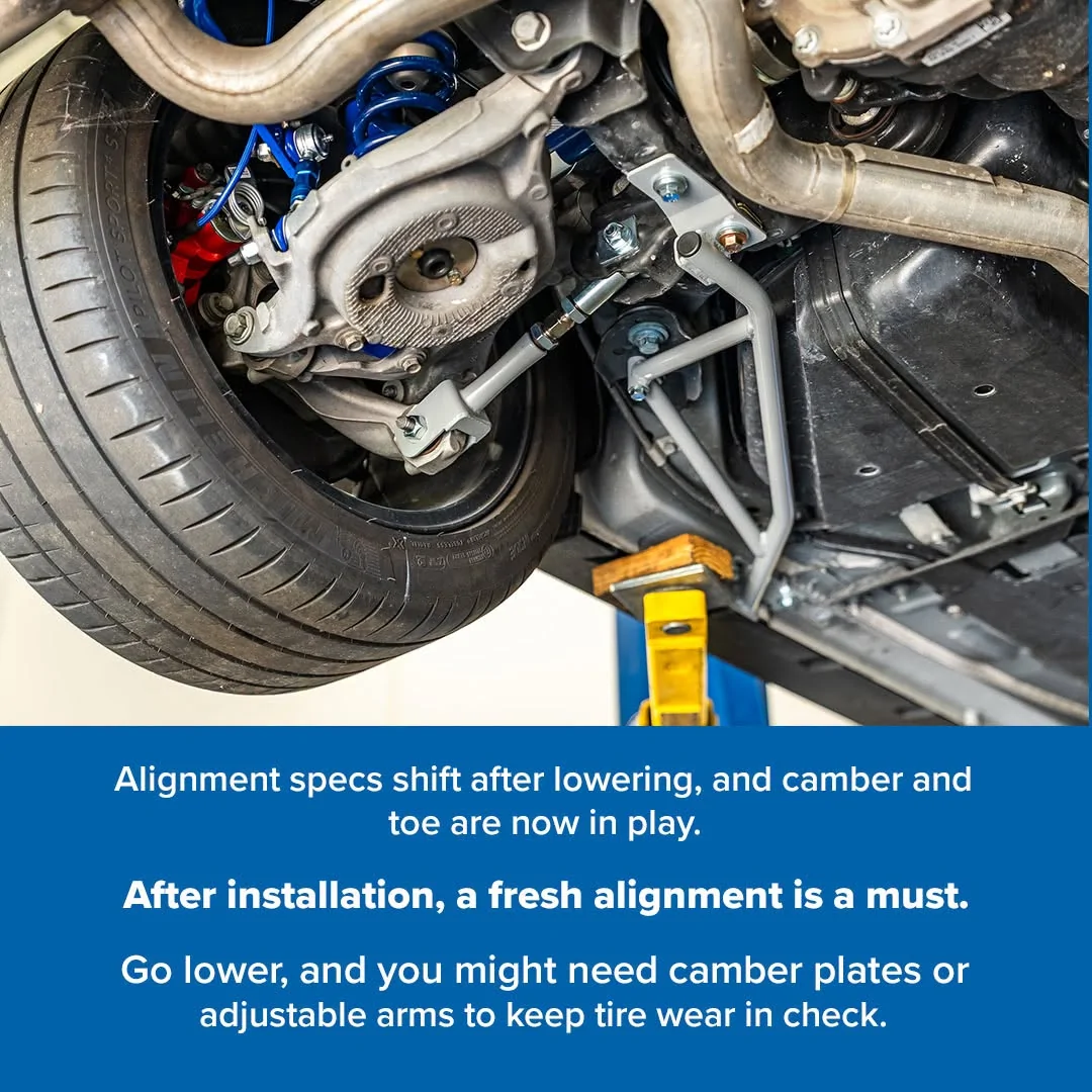

Lowering your Mustang involves more than choosing how much wheel gap you want to eliminate.

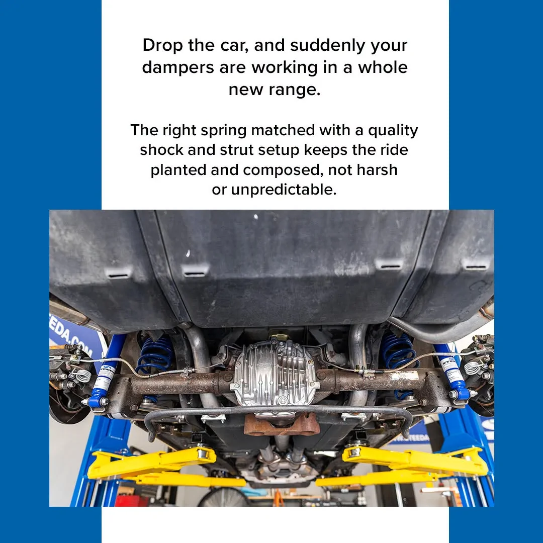

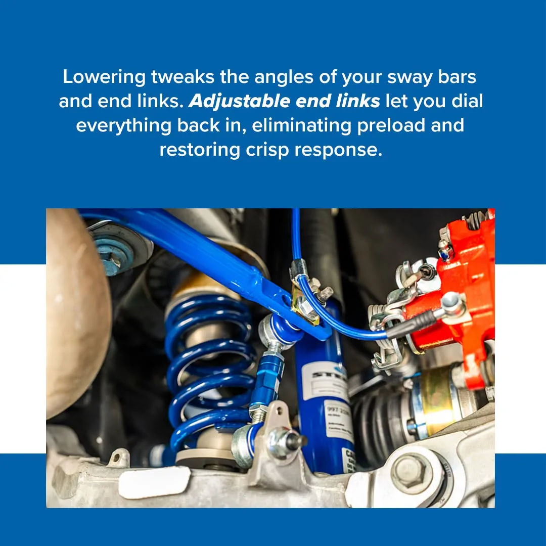

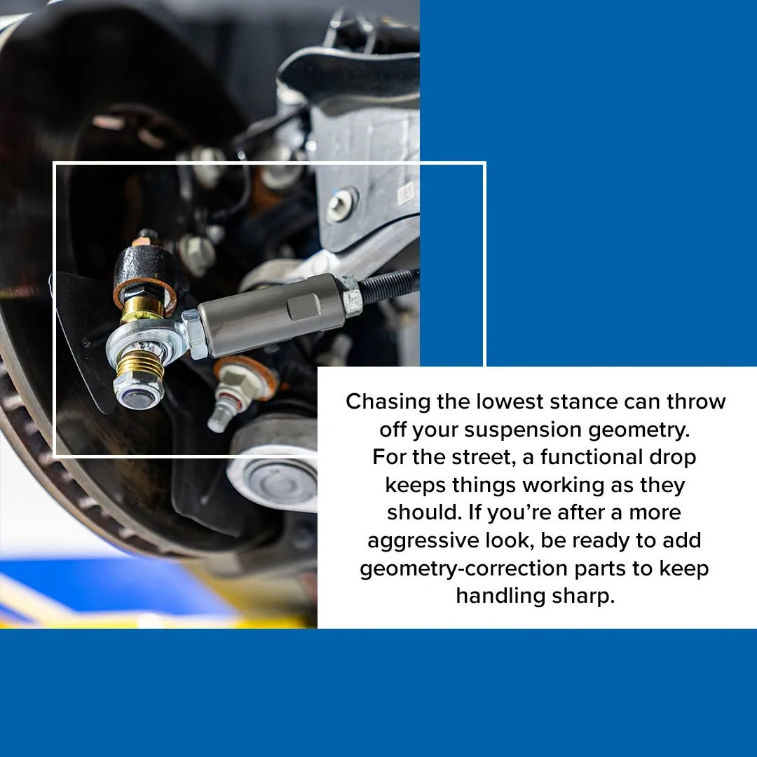

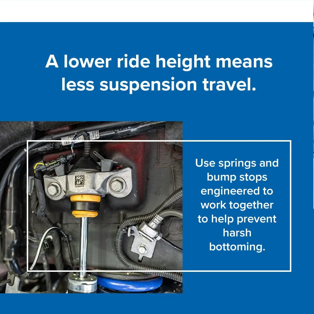

Ride height changes everything from shock and strut control to suspension travel, alignment, geometry, sway-bar function, tire wear, and ride quality.
The good news is, with the right springs, dampers, alignment, and supporting parts, you can dial in each of these areas for a Mustang that works as good as it looks.
