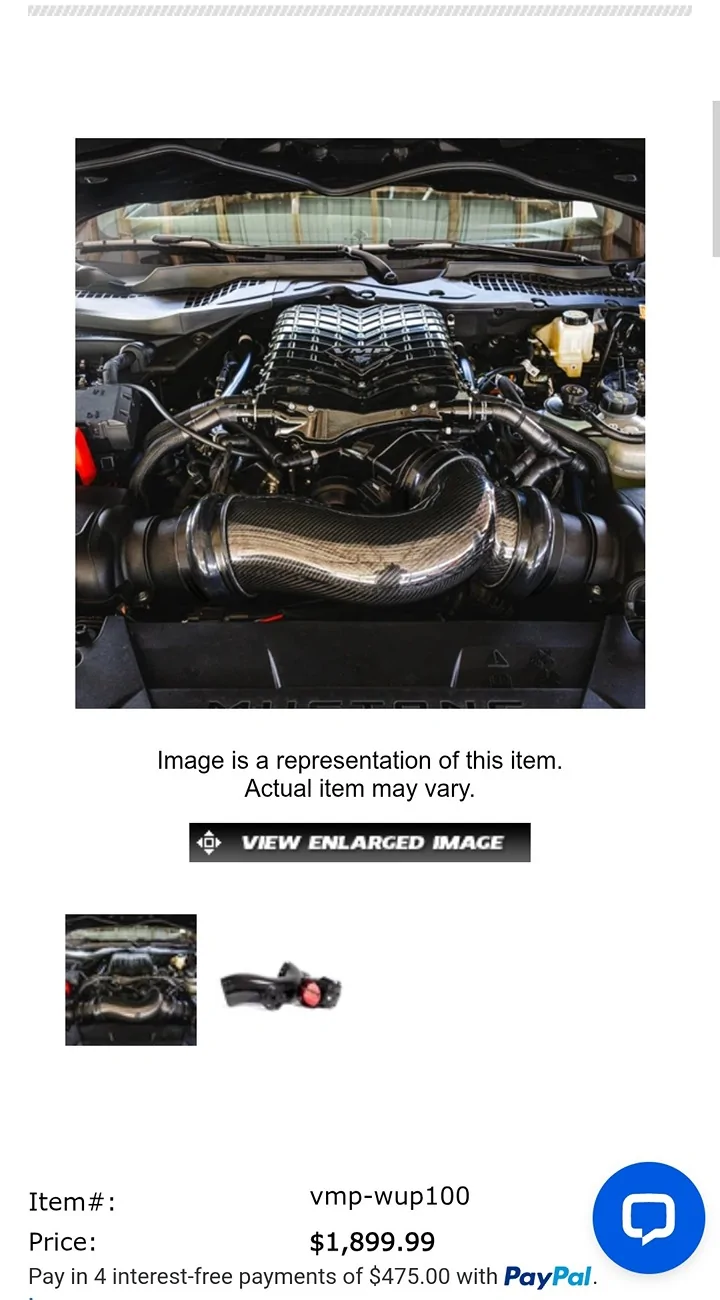

I'm wanting to get the stage 2 upgrade for the whipple. My question is, how is the whipple stage 2 tune vs a custom remote tune from Wengred, PBD etc?
It looks like buying the parts seperate and then getting a custom tune will be as expensive as just buying the stage 2 upgrade and getting the custom tune. At that pont, is it worth getting a custom tune or will the whipple tune be good?
Main thing I want is the TCM tuned. I know whipple does rpm increase but is it good compared to a custom TCM tune.
S650 Mustang S650 Whipple Stage 2 Upgrade Tune Screenshot_20260502_235021_Chrom
