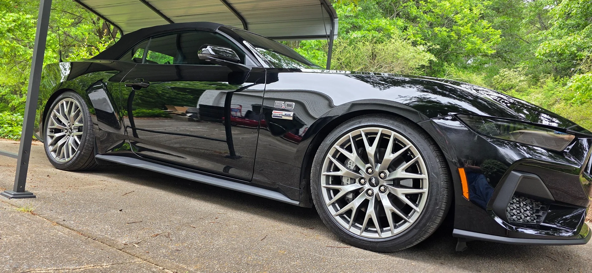

For anyone on the fence: there is absolutely nothing like it—the experience is almost indescribable. I could have bought a performance model out of the gate, but I wanted the convertible and wouldn't settle.
The rumors that you have to rebuild the entire structure are incorrect. Most speed shops will quote you in the high $20k or even high $30k range, but by working with a Ford Performance certified shop at my dealership, the costs were much more reasonable. Including the mandatory (in my opinion) 1-inch drop, the structural changes I expected to cost $5,000+ ended up being around $1,000, and my total build cost was around $17k. I kept my 60,000-mile drivetrain warranty and even the extended warranty coverage.
Ford has spent countless resources engineering this chassis to handle this power. Unless you’re building a race car, it’s not as complicated as people make it out to be. Talk to the Ford Performance team and follow their lead. This build is possible, it is solid, and the result is incredible.
