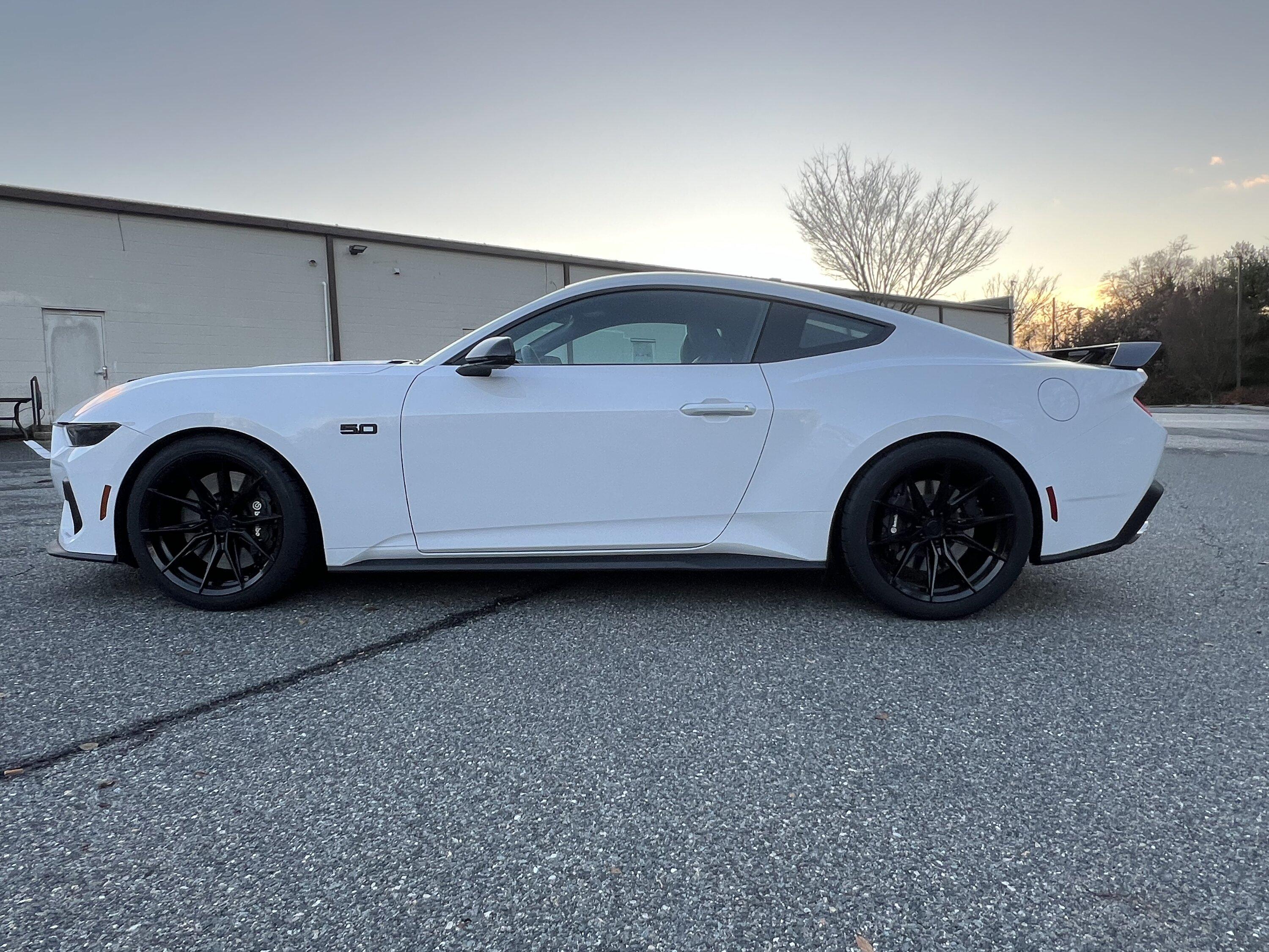

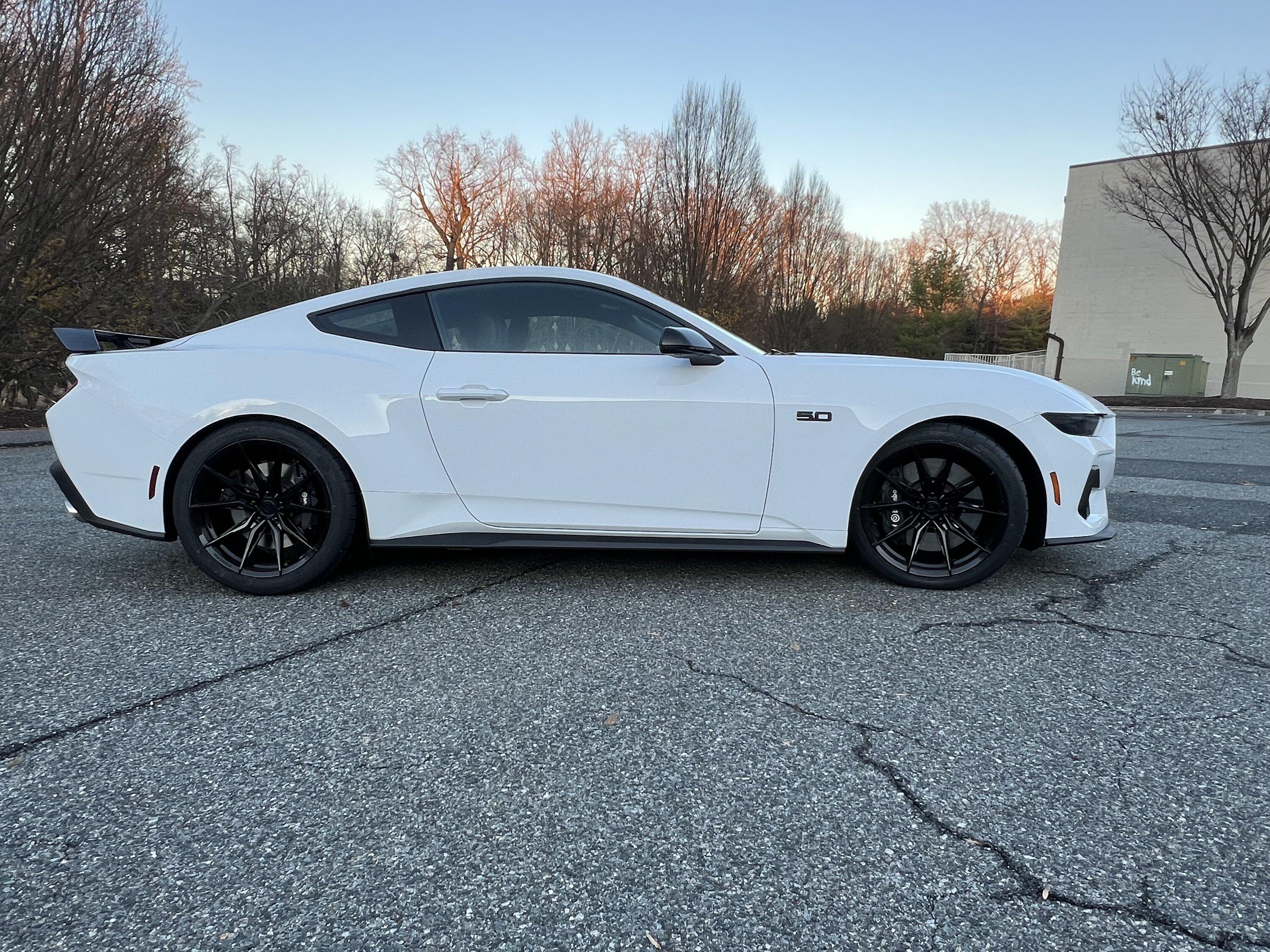

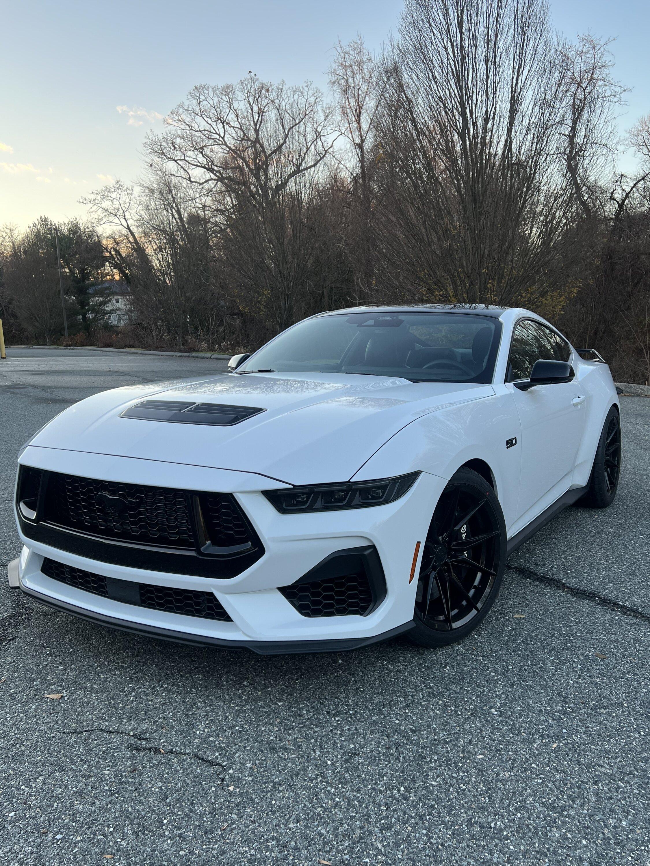

Rohana RFX13’s. 20x10 up front, 20x11 in the rear. Had to run a 3MM spacer up front to clear the brakes. No rear spacer. Went with Mickey Thompson Street Comps (P275/35R20 and 305/35R20)
For suspension+, went with a bunch of Steeda gear, love it all…
Stop the hop' handling ultimate kit (P/N 555 2129 H)
Steeda Mustang MagneRide Dual Rate Ultimate Handling Lowering Springs (2015-2024) (P/N 555-8243)
Steeda Mustang Camber Plates All (2015-2024) (P/N 555-8139)
Steeda Mustang Coupe Low-Profile Jacking Rails (2015-2024) (P/N 555 5205)
Steeda Mustang Strut Tower Brace GT/EcoBoost (2015-2024) (P/N 555-5731)
Steeda Mustang Adjustable Front and Rear Sway Bar Kit (2015-2024) (P/N 555 1017)
Steeda Mustang Adjustable Swaybar Endlinks (2015-2024) (P/N 555-1042)
Went with the Steeda X pipe also, sounds great! Haven’t driven the car too much since the upgrades, but already launches a hell of a lot better with a stock 5.0.
