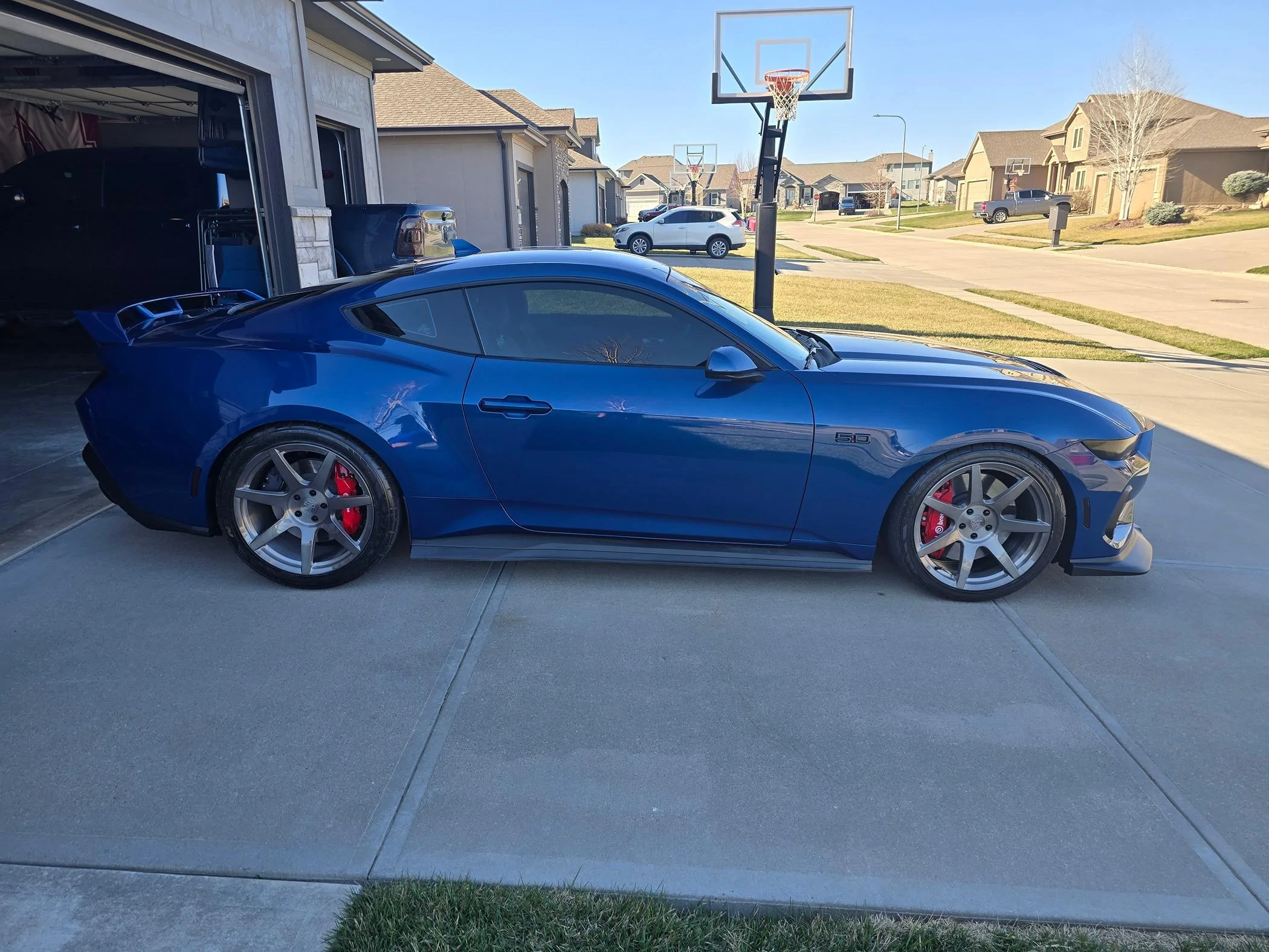

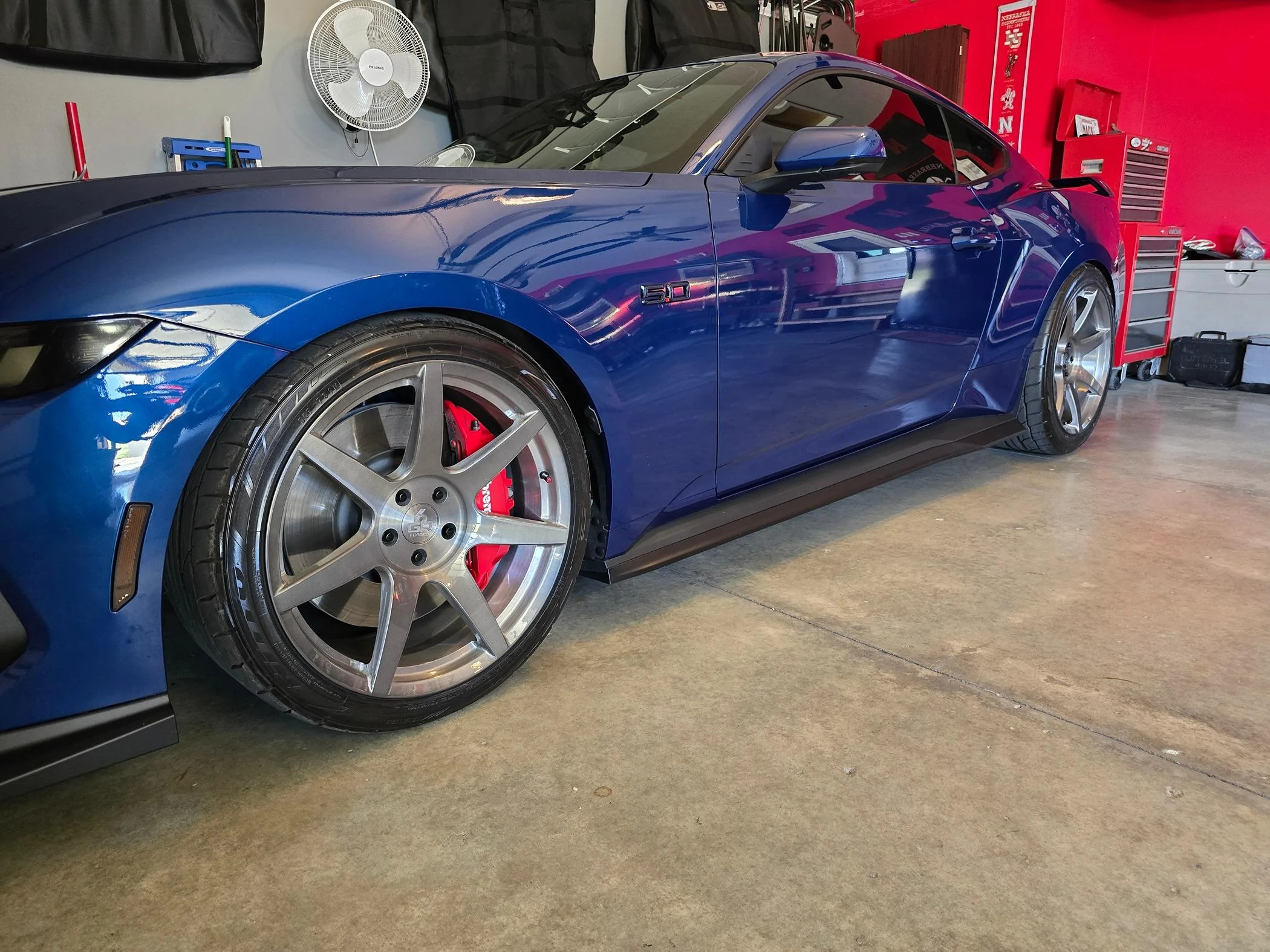

I've got the steeda magneride lowering springs, don't think the ride has been changed much. They drop about .84" all the way around. Just drove 600 miles yesterday, and the ride was very enjoyable.

Thank you. Steeda has a few options though, drag, progressive and a few others. Which ones did you get?

Thanks. Those are the ones I was looking at. Thank you for the info.
Any time! First time mustang owner going through the typical midlife crisis at 50. I'll help work whatever I can if I get to show off my car, haha.
You'll love them, I promise. Make sure you get it aligned same day or soon after. Some guys on here have stated they had some rubbing after they lowered it, but no alignment. I did not do the adjustable camber plates, I'll never hand it on a race track. Not a single rub anywhere.
Really nice setup!
What is your wheel/tire size?
