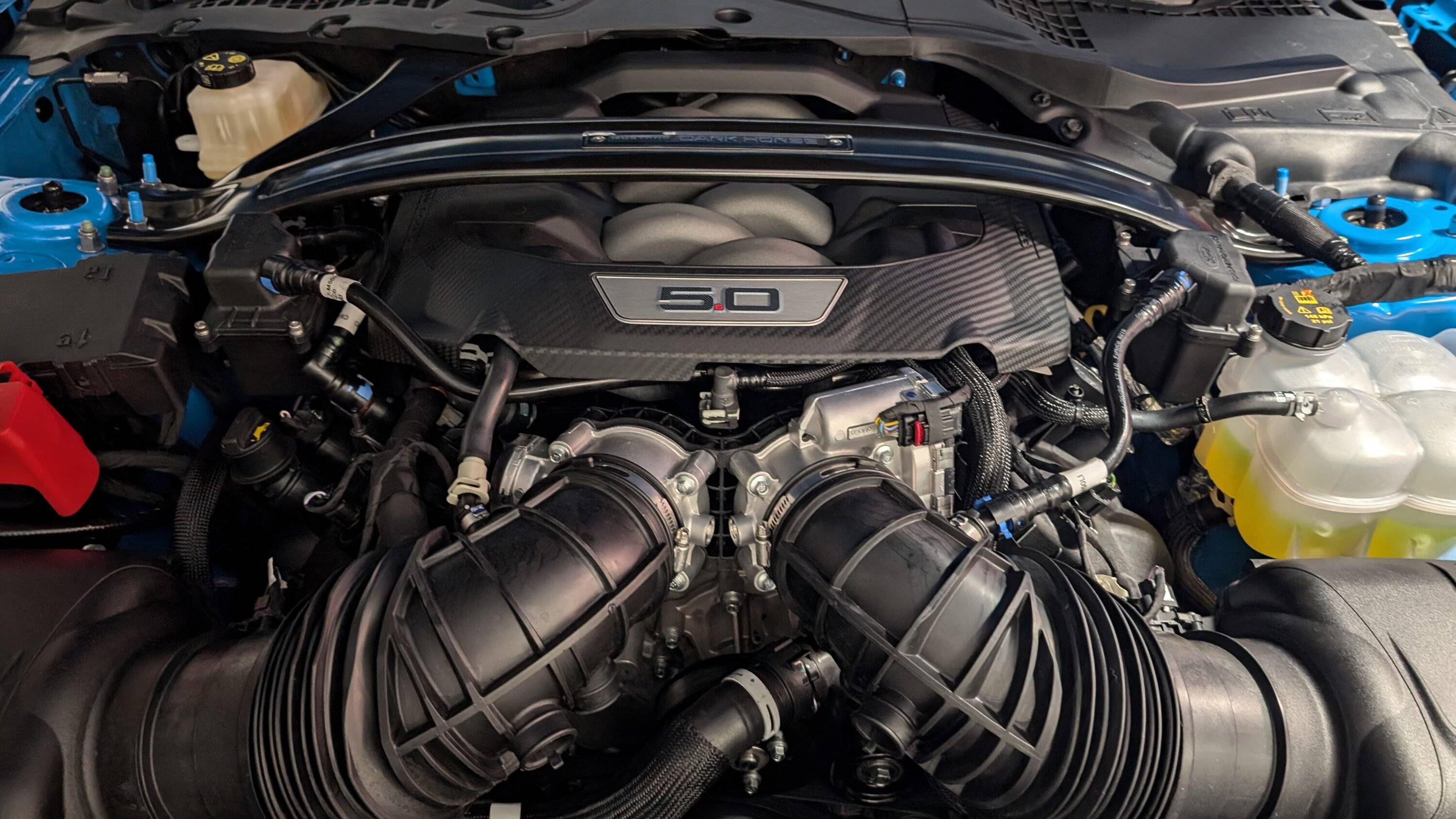

Found some time for my first mod (not counting the tint and failed puddle lamps). Installed the oil air separator kit from Ford Performance. Pretty straightforward install with a minor difference for us RHD folk with the battery cables getting in the way. Love the quality of the kit and as I expect from Ford Performance, it looks factory. Hardest part was just fiddly bolt locations and squeezing the drivers side bracket on.
So factory, that you have to know where to look in the first place, to see it!
It blends in so well. :like:
I'm on the fence about catch cans, but where did you get this from?
Link please. 🙏
Link please. 🙏
I got them through Levittown Ford Parts who are a sponsor on here. They are very good and usually look after you. Postage was quick took about a week once they got the part from FP.
https://www.levittownfordparts.com/sku/m-6766-a50d.html
I reckon you can't go wrong with catch cans. I had one on my s550 and whilst it didn't get heaps it's always better knowing it's not going back into the intake.
Whilst I think the double Ford kit is probably overkill I cant go past the factory fit and look.
