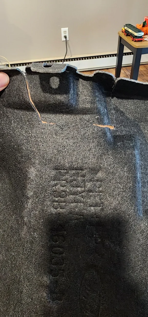

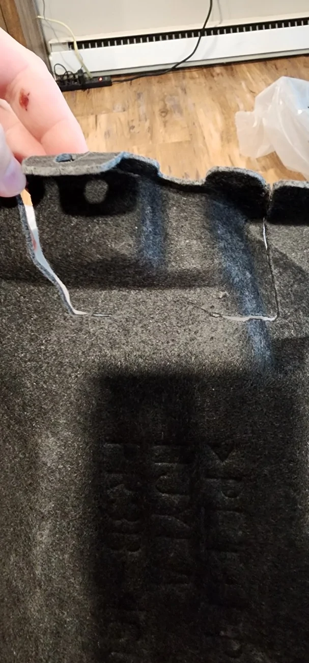

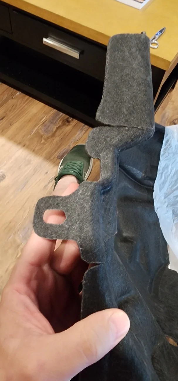

Hey Guys-

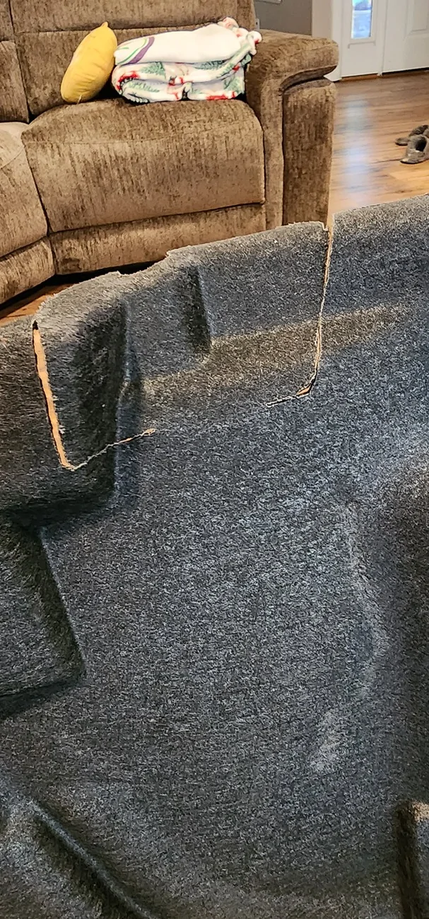

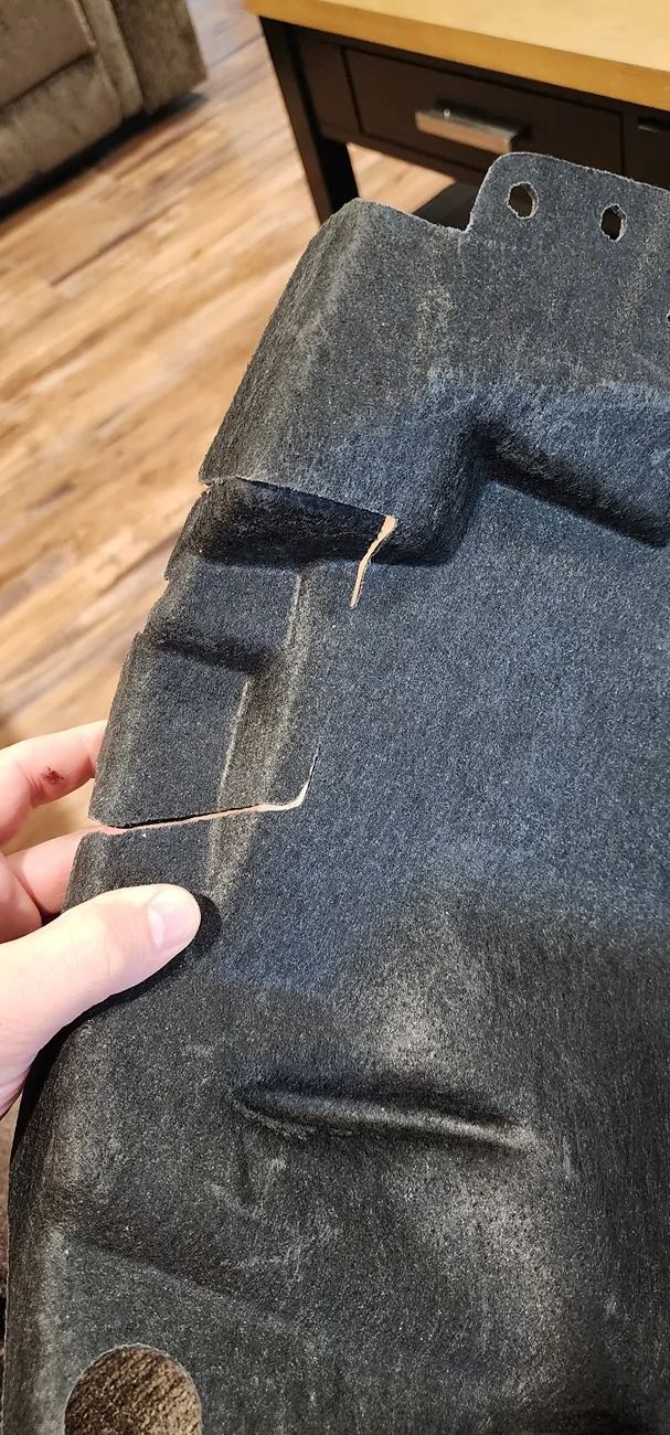

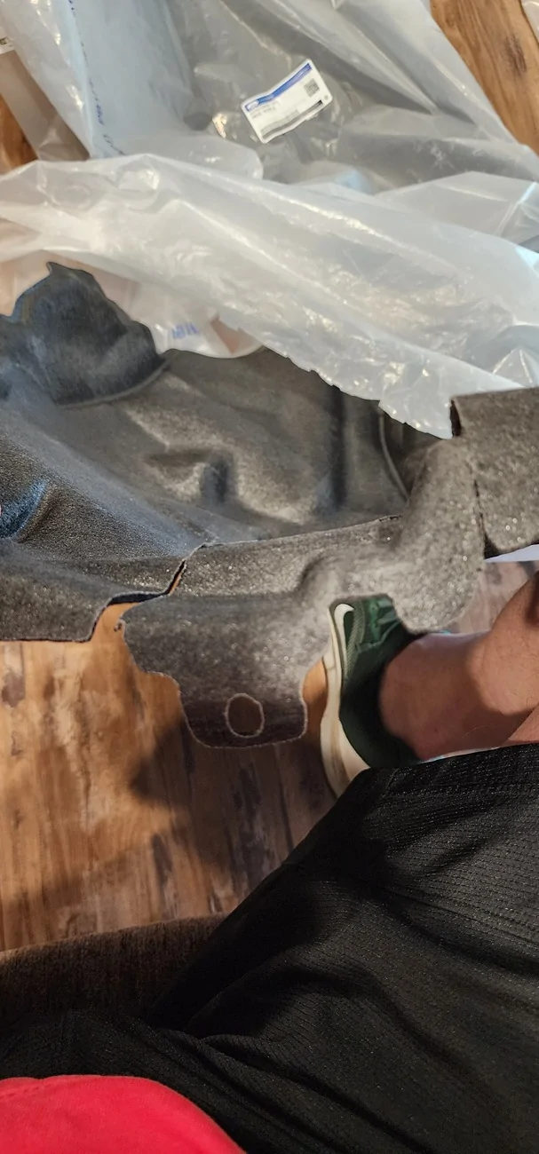

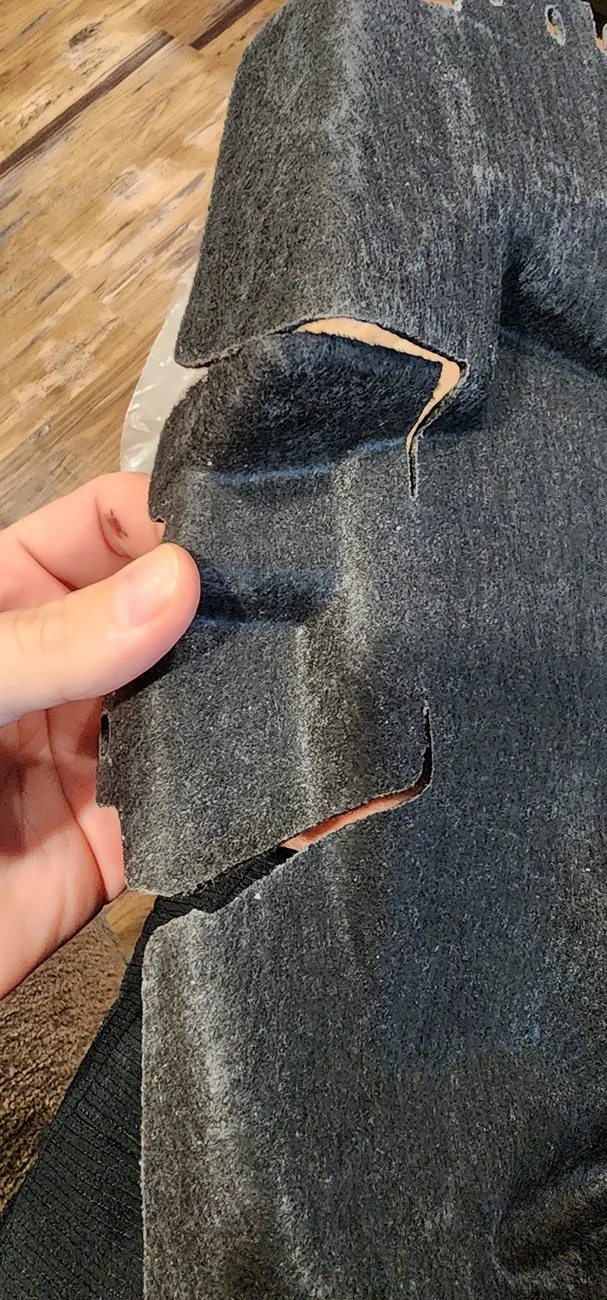

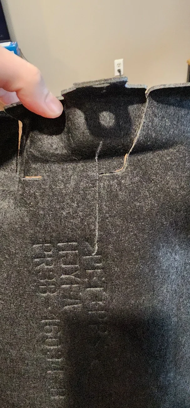

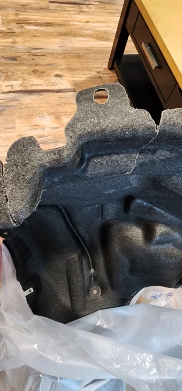

Just wanted to share this with you all, I ordered new Fender liners for my brake duct upgrade, PP bellypan & Splitter, lower grille from LEVITTOWN FORD via BENNY!!!!! and Vorshlag brake deflectors to tap and thread into Non PP front control arms. (The tap is M6 X1.0) and the bolts are M6X1.0 and 3/4 length. etc. I also ordered the 2024 fenderliner PATCH from Frank via Germany.(Still waiting on delivery). Low and behold, yesterday -> when i got the new fenderliners i noticed that they had break cut-out that were attached yet looked damaged on both. THEY WERE NOT, this is the way the come from factory like this. Ford finally fixed the mistake they made in 2024 fenderliners, Kudos!!!!!!!! They are held in place from a bolt on the bottom. This is NORMAL, in case anyone orders new fender liners, they are not damaged. Take a look at pics on both sides and get a visual.. Hope this helps someone also doing upgrade. THANK YOU FOR YOUR HELP!!! BENNY from LEVITTOWNFORD, as always My GOTO GUY!!!!!!!!!!
Thanks Anthony
P.S. I will be removing the AGS system as well at time of bumper removal, Keeping the rubber frame and eliminating the shades, keeping the motor attached to eliminate any CEL... I did same with a 2016 Ford Fusion back in the day and never had an issue w CEL's.

Thanks. What is the pictured PR3B-16034-? part number?

I dont know, All #s listed are on napkin. The parts were wrapped in sealed bag with those part#s on napkin. Not on part itself. It is different, not sure why... But when i placed order it was off napkin. Hope this helps.

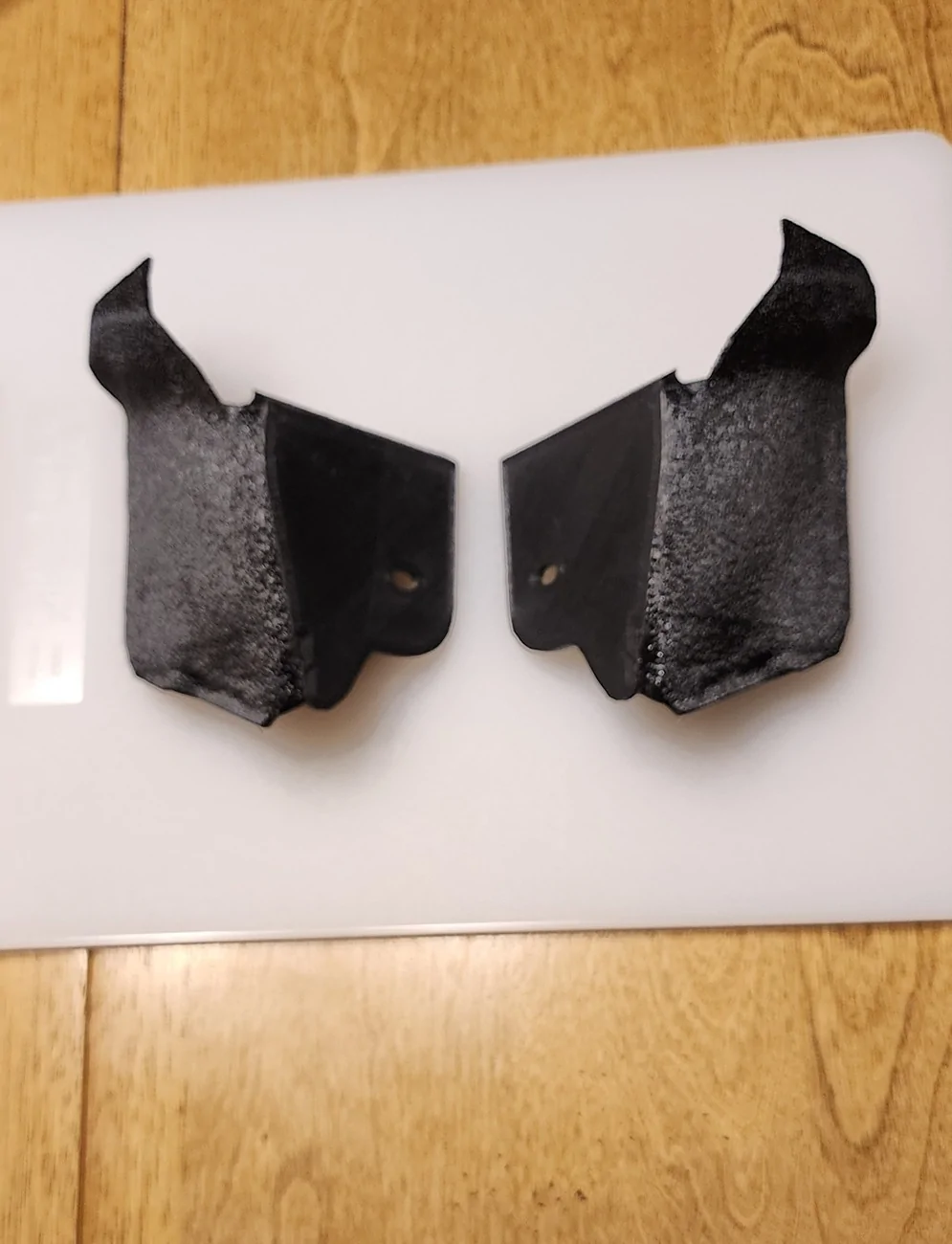

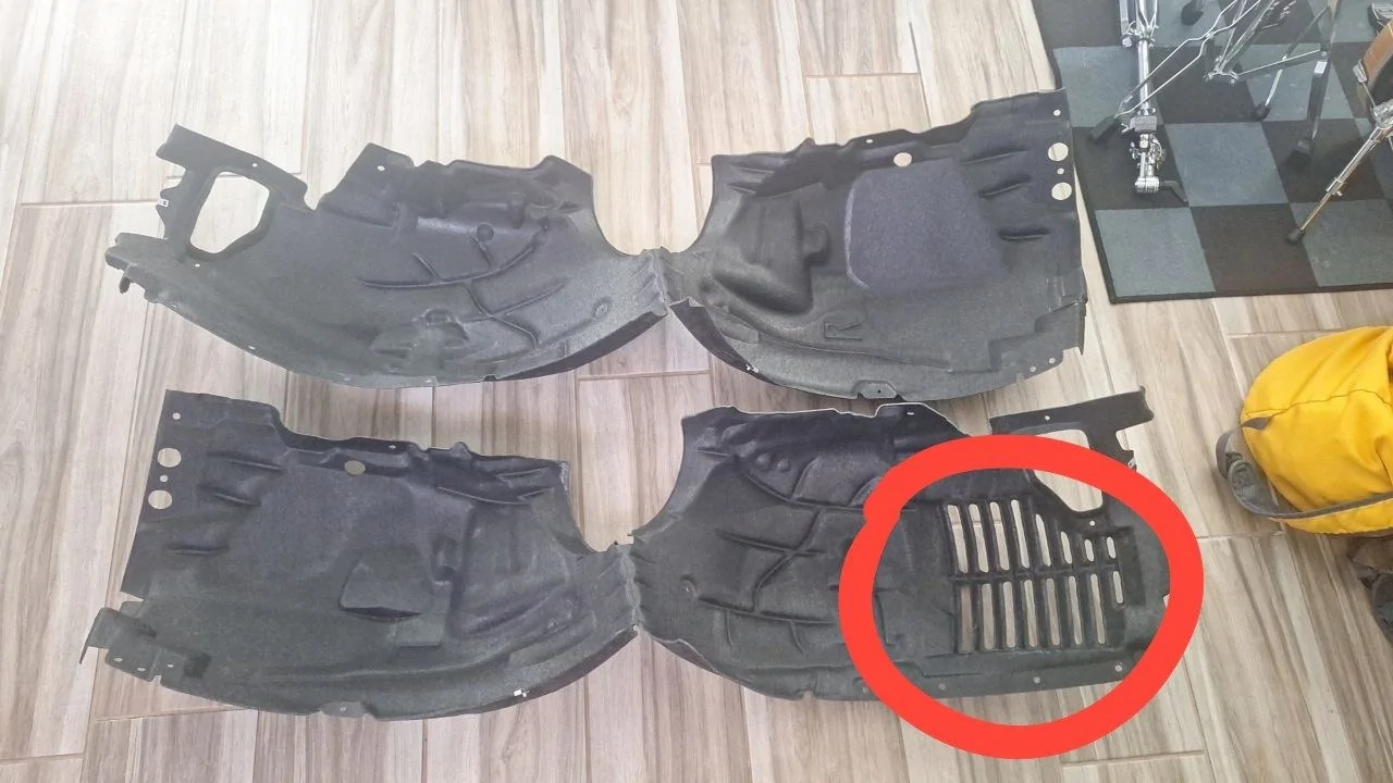

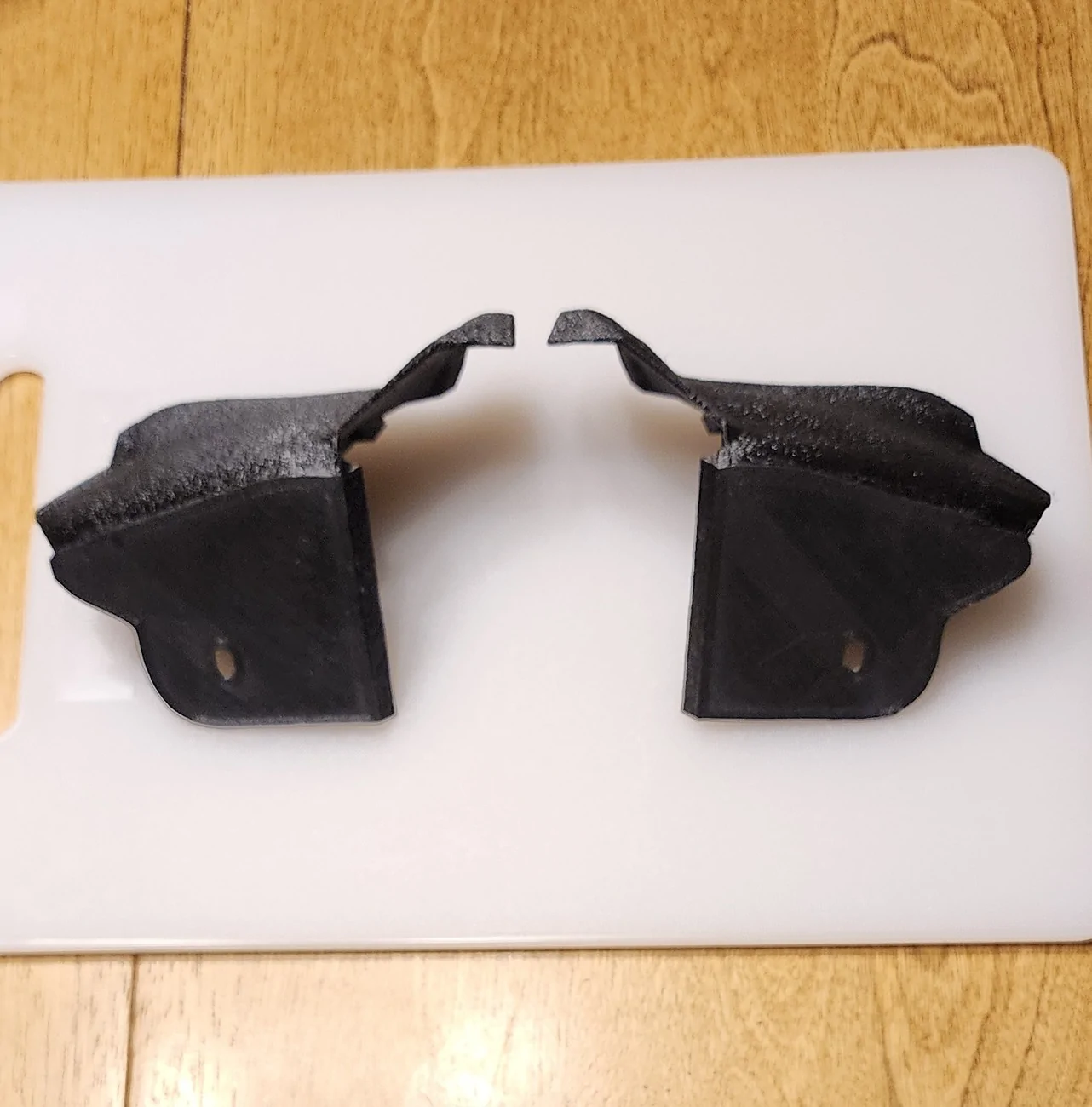

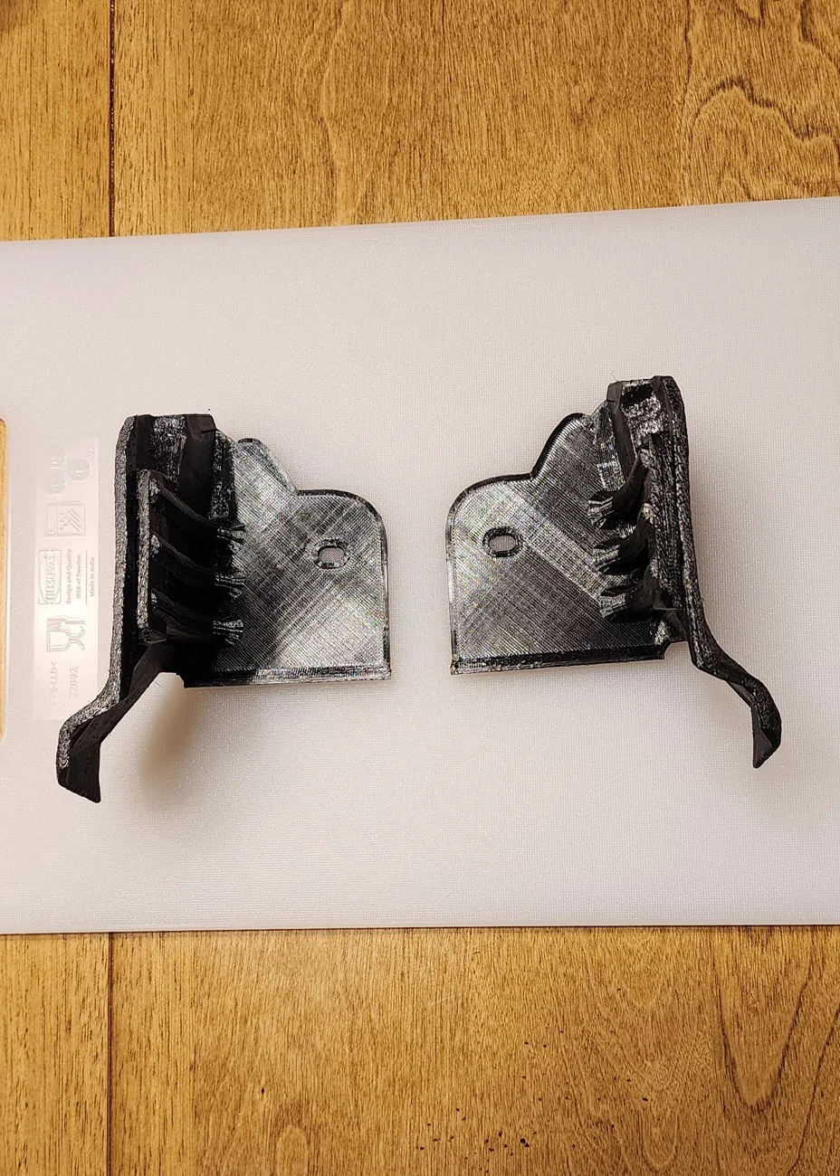

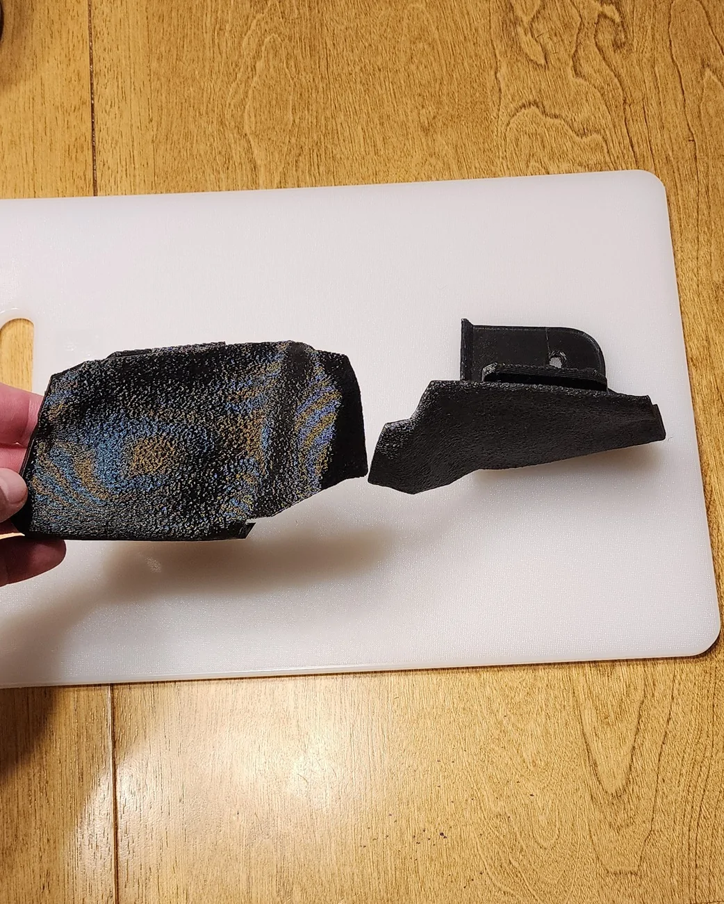

Your welcome, happy to help. Its funny, now that I have new corrected/updated liners didnt ever think they would be fixed via factory, the parts from GERMANY from Frank just arrived. Lmaoo wtf!!!!! Very nice pieces... worth the $85 bucks. I may sell them,. ..
