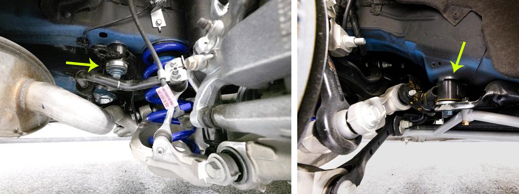

SUBFRAME ALIGNMENT KIT
From the factory, the bolt holes for the rear subframe bolts are rather large compared to the size of the bolts themselves (think hot dog in a hallway...). These large gaps result in your S550 or S650 rear subframe being out of alignment by up to 1/2 an inch. Steeda found the answer to these gaps by way of CNC-machined Delrin sleeves in their Steeda IRS Subframe Alignment Kit (SDA-555-4438). These dowels get inserted into your factory bolt holes and then your bolts will slide through them. The sleeves fill any gaps around the bolts and ensure a perfectly aligned installation every time, centering and squaring up your rear subframe to the chassis.

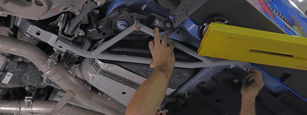

IRS SUBFRAME SUPPORT BRACES
The last piece of the puzzle in the Steeda Stop The Hop Starter Kit is their Steeda IRS Subframe Support Braces (SDA-555-5754). These braces are made in-house from 4130 chrome moly and finished with a silver powdercoat. These braces are STRONG and ultimately 'brace' together 3 important points on the rear of the Mustang, triangulating the subframe to the chassis. Steeda "utilized existing threaded holes in the rocker panel (the strongest part of the body) and connected that to the front mounting location of the IRS subframe and the rear mount of the lower control arm and toe link. Connecting these 3 points together not only adds rigidity that was lacking in the rear, but also more control of the whole car." The subframe braces utilize all factory bolt locations so there is no need to drill or modify anything for installation AND does not add any NVH after install.

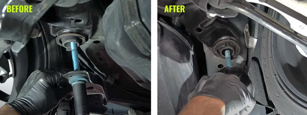

STEEDA LINEAR DRAG SPRINGS
While still offering excellent street manners, Steeda's Linear Drag Springs (SKU: SDA-555-8231) were designed with the drag racer in mind. The rates on the springs were designed for the best weight transfer and most traction when launching a the drag strip. The Steeda Drag springs lower your S550 / S650 Mustang roughly 1" in the front and 0.75" in the rear while maintaining optimal rates of 150lb/in. in the front and 800lb/in. in the rear.
