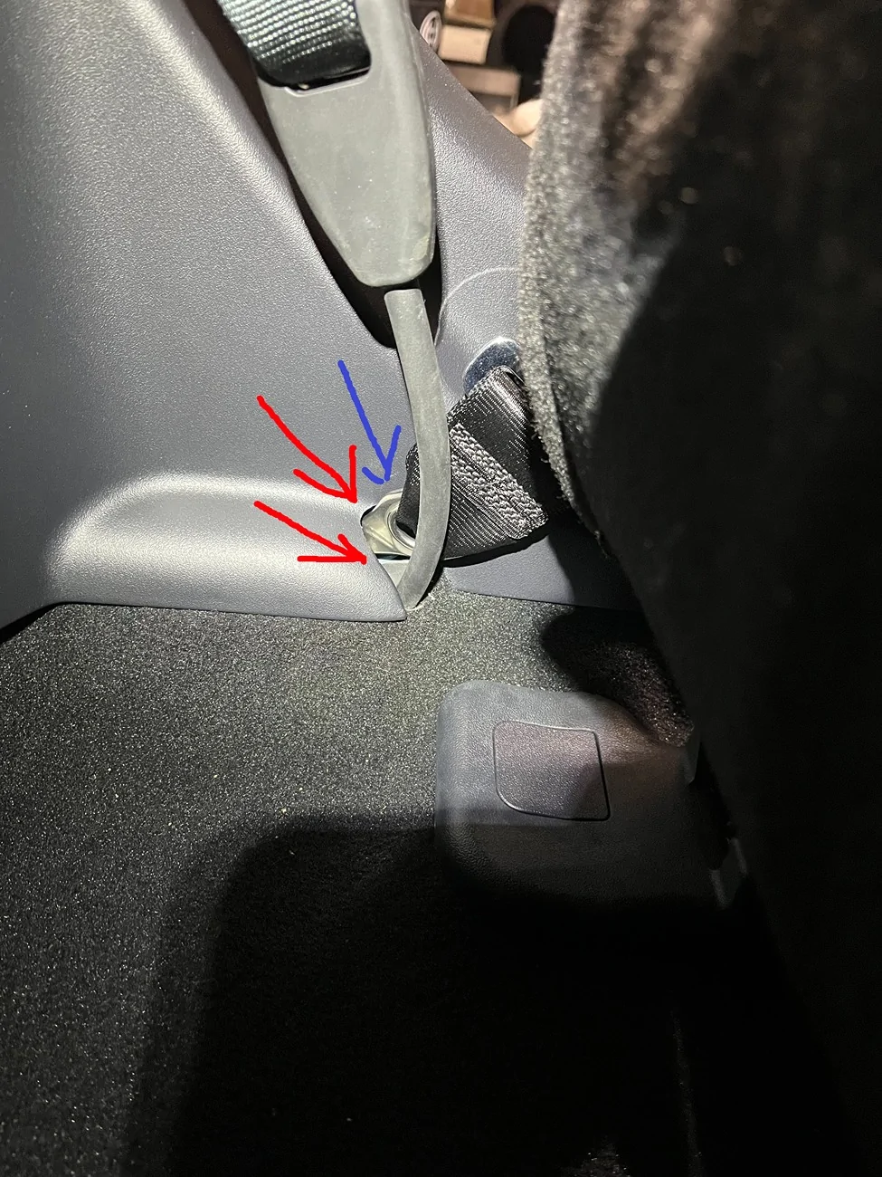

I forgot to mention one thing in my previous post. If you've completed the install you more than likely discovered the B-Pillar panels must be trimmed to allow the harness to exit toward the front of the vehicle.
If you've completed the installation disregard the info below. If not you may find the info below helpful.
See photo below. The view in the photo is backseat looking toward the drivers side B-Pillar. Photo left is rear and right is front of vehicle. The red arrows are pointing to the area I removed from the panel. The blue arrow shows the harness exiting the B-Pillar connection point angled toward the front of vehicle. Panel trimming is fairly easy with a Dremel tool. My process was remove a little material, test fit, repeat process etc.. until panel popped back in place without touching harness end/connector. Trimming the panel cannot be avoided.
