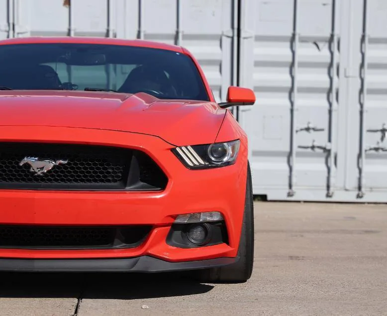

As you can see here, our S550 was set up with almost -3° camber for it's track setup for an HPDE event. This particular car is running a 305/30/19 Michelin Pilot Sport Cup 2 which has a unique sidewall that sort of "rolls" into the tread, making it easier to fit this aggressive size.
