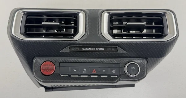

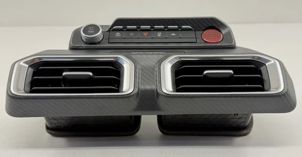

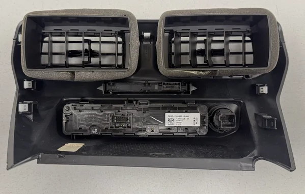

How does this interior piece (Front Center Dash Air Vent Grille Trim Bezel) come off?
SPANKY
Dec 5, 2025
Seneca, SC
2025 Dark Horse Premium S5806
It looks like it just clips in, is that it? Or does that small "lip" on the bottom mean the console has to be removed?
I could have sworn I remember someone saying the screen has to come out, I just can't see why it would need to.
Anyone taken this off before have any tips, warnings, or advice?

I have a '24 Dark Horse and I had to remove the screen to access to screws behind it in order to remove that panel.
Somewhere along the line, they've made a change and that no longer seems to be the case. I believe that now you can just pull on that panel to remove it.
This should give you and idea of what you're looking at.
https://www.mustang7g.com/forums/threads/interior-upgrades.161785/post-3479836
