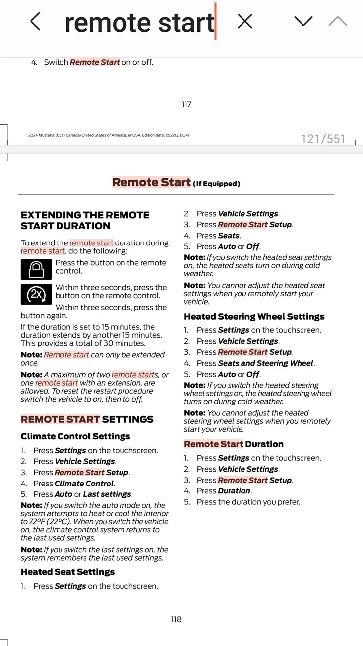

Heated seat and steering wheel automatically operate at a certian temp??
