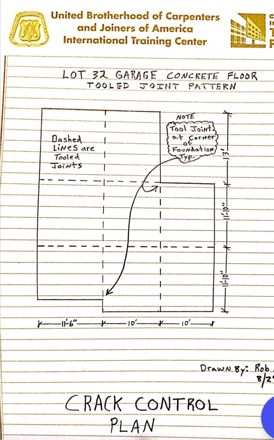

Years ago on another Forum that is no longer around I had a topic called "Grabbers Shop" for 10 years where I would post off topic stuff that I was doing. 9 years ago I downsized and moved. I had a small home with a 5 car garage built with a 10'-8" high ceiling. It has 2 tandem bays and 1 single bay. This photo shows the 1012 square foot lay out of the garage.

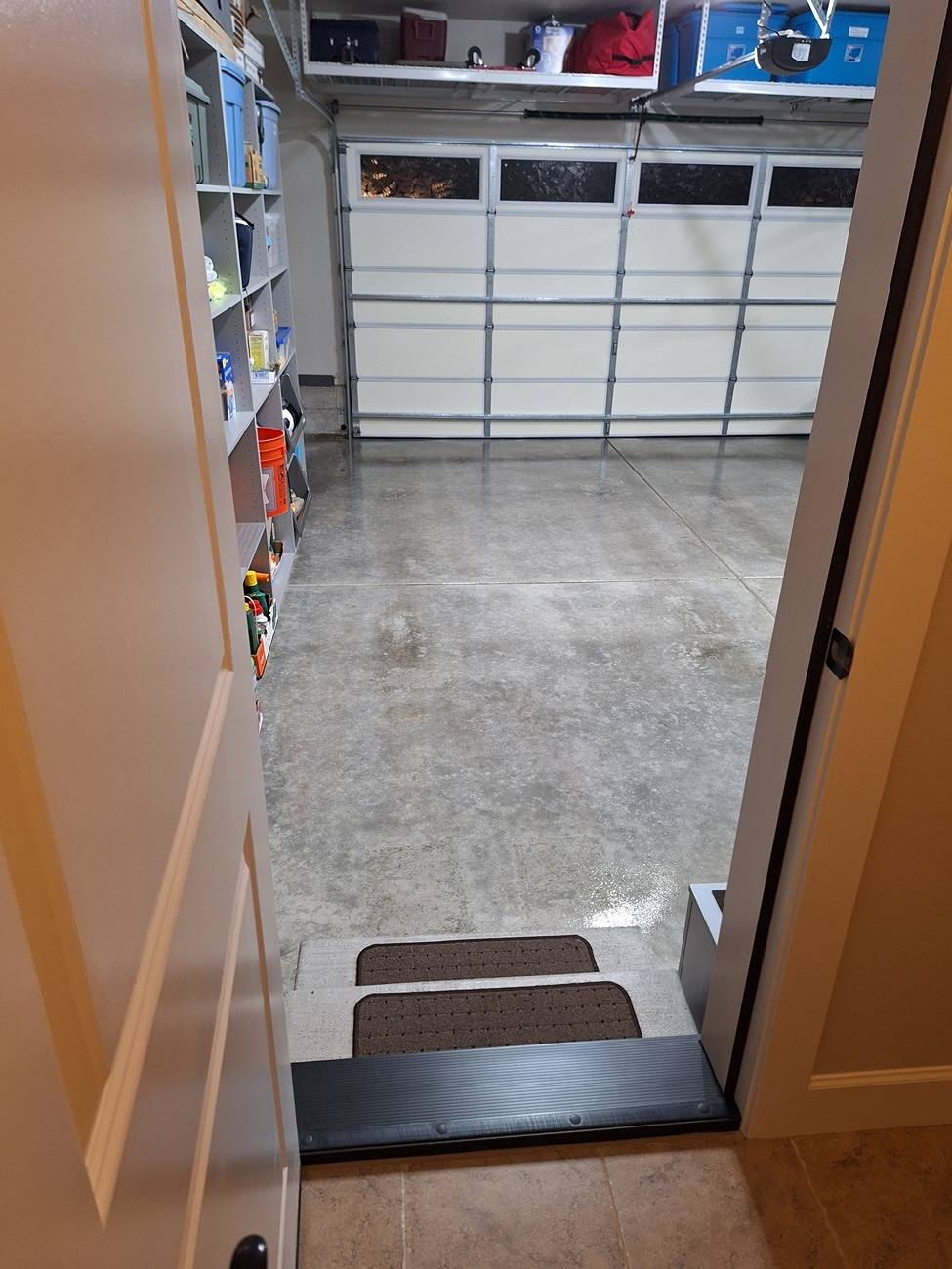

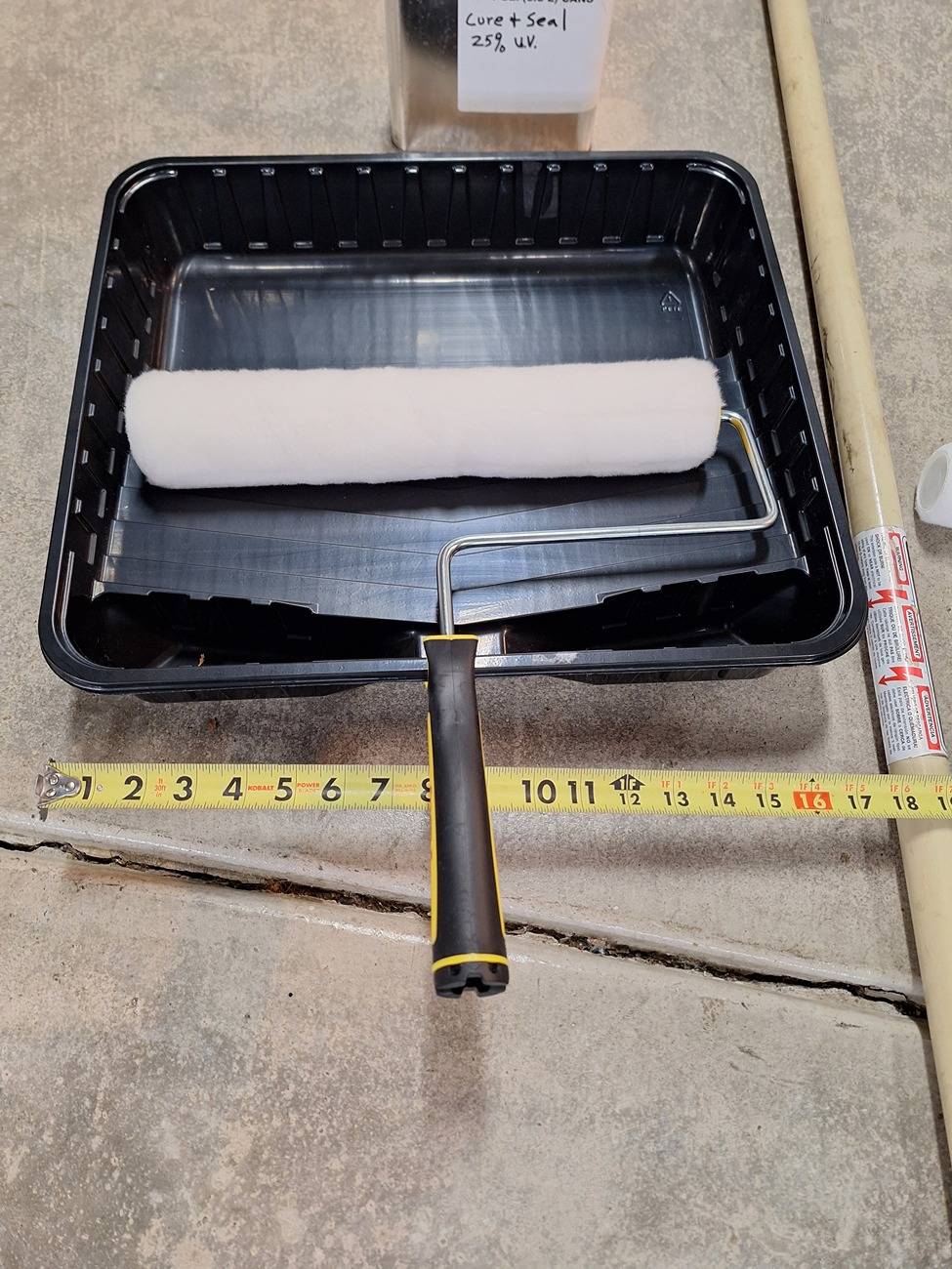

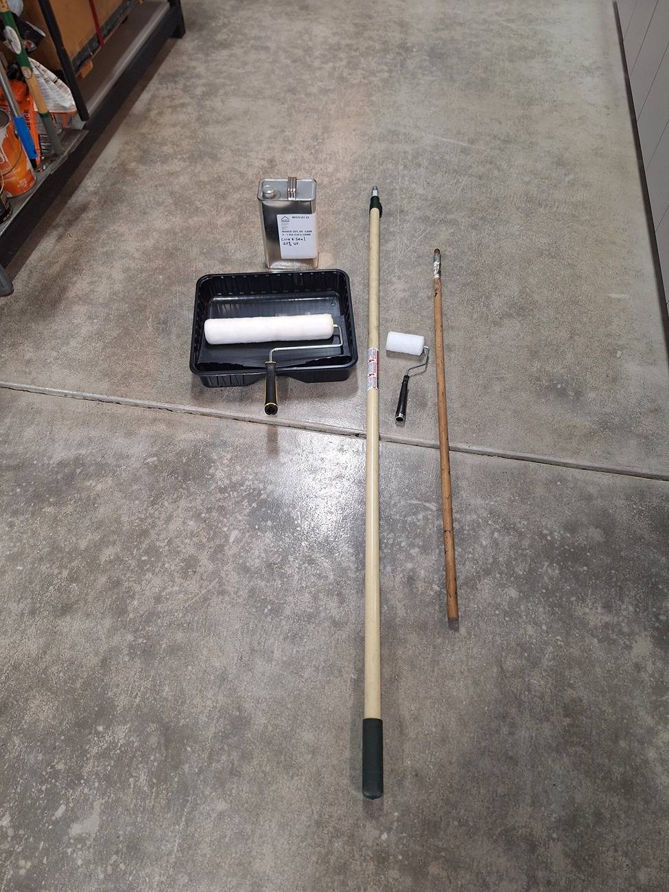

RAINY DAY INDOOR PROJECT

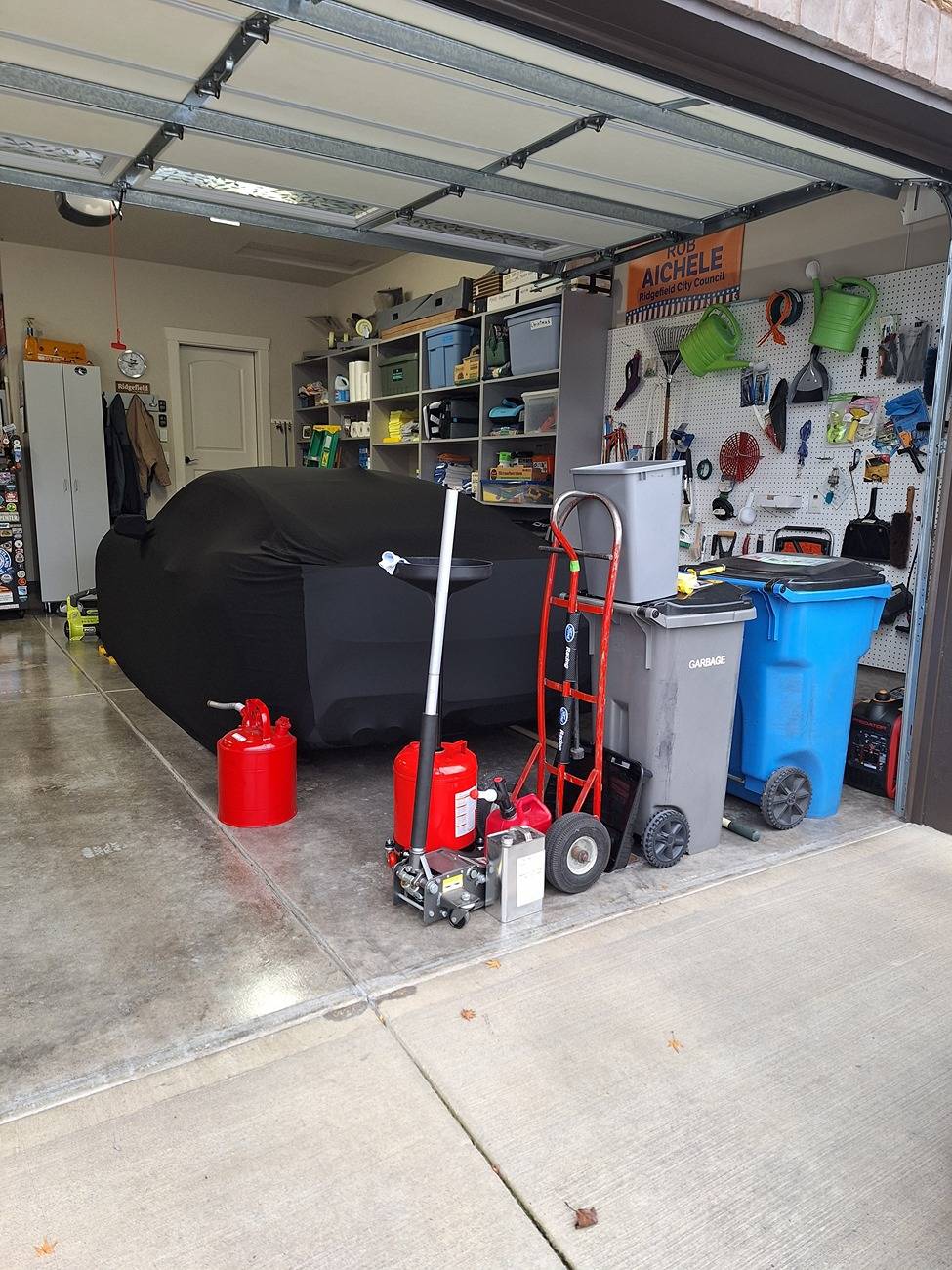

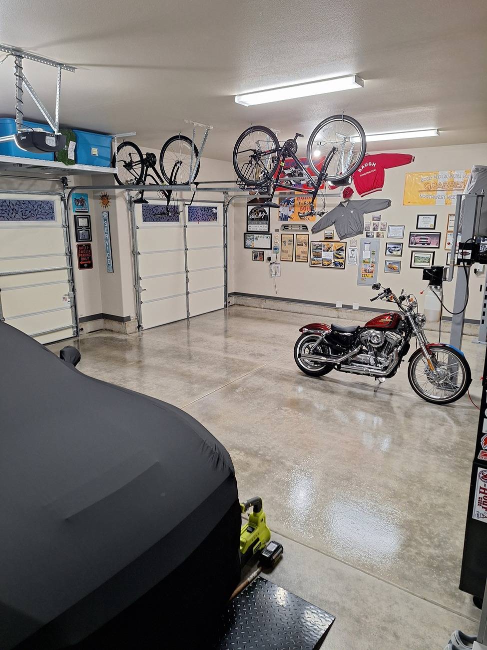

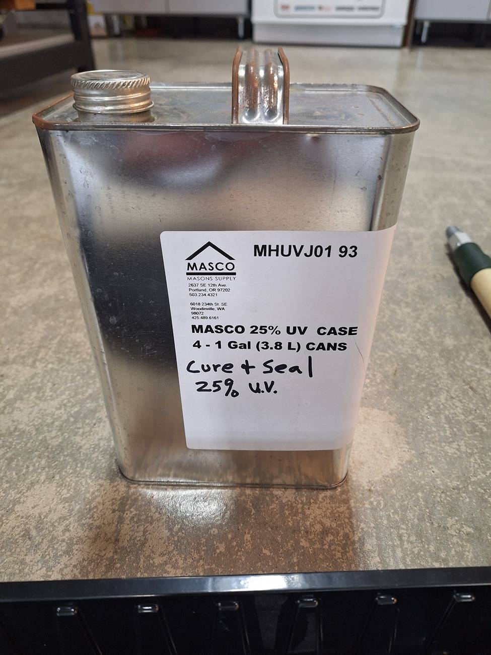

Cleaning and re-sealing the garage floor the last 2 days of the storm. It's a 5 car garage. 2 tandem bays and 1 single bay. 1012 square feet with a 10'-8" cealing. Moved my truck and wife's car outside and the GT to the single bay. Will work on that bay in 36 - 48 hrs after 1st area is cured. Left the Harley Davidson in place and worked around it. 1st I cleaned and blew out all cob webs, bugs, dried froggies and lizards. Scuff sanded existing seal coat surface with 60 grit sand paper to allow for proper adhesion. Scrubbed the floor with hot water mixed with dishsoap solution to remove grease residue from working on cars. Cleaned out the construction joints. Blew out the area again. Then used a 14 inch wide roller and long pole to apply 1.5 gallons of solvent based stinky industrial Cure & Seal 25% UV to the floor.

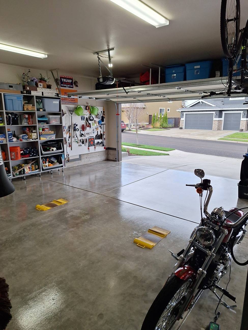

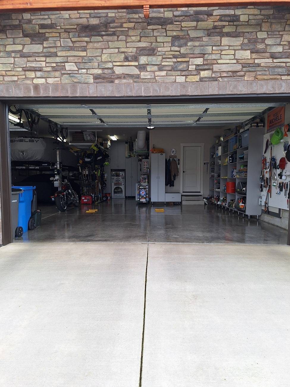

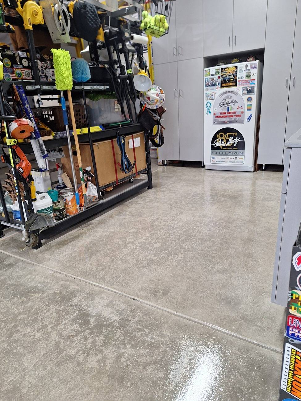

Finished my garage floor.

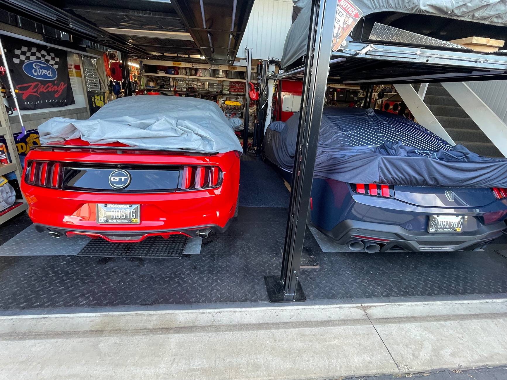

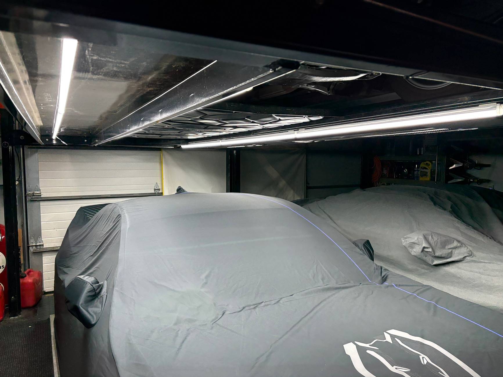

I went with 4’ LED fixtures and attached magnets to the backside. I then put a master switch at the front of the lift and attached the power cord to the hydraulic line to avoid issue with the lift going up and down. In the picture with the red car you can see the multiple rows of lights.

Your Magnets must be pretty strong. Looks very functional. My LED light strip has double sticky tape already installed on the back side of the light strip which made installation really easy.

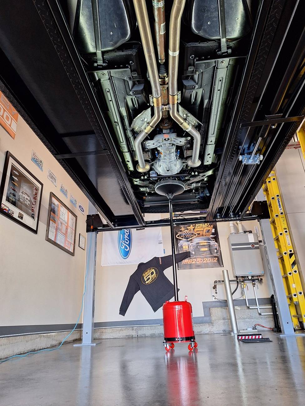

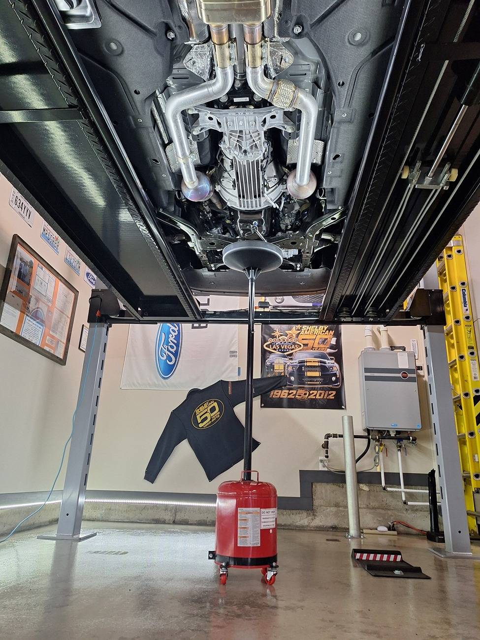

Changed the oil in the 24' and 09'
