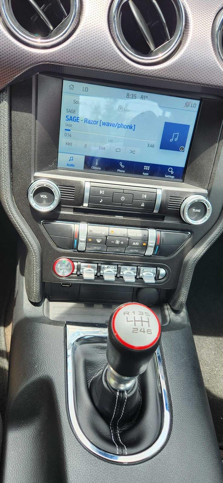

  2. Bought a 4dtech Sync 3 upgrade kit and replaced the base stereo with it - which also fixed my vent control issue. Added drive modes as a bonus.

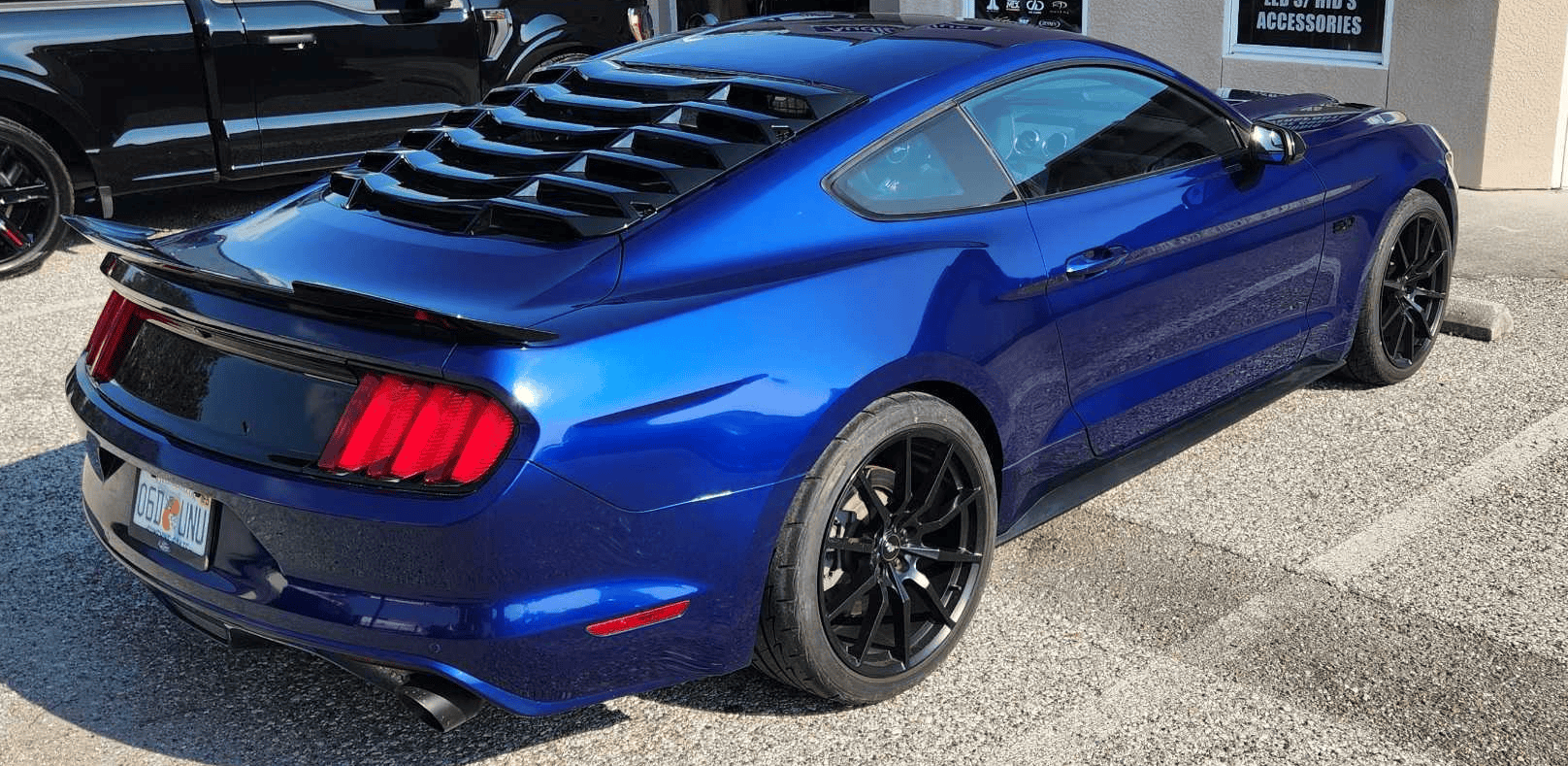

  7. New spoiler & heat extractors.
  8. Added rear window louvers.

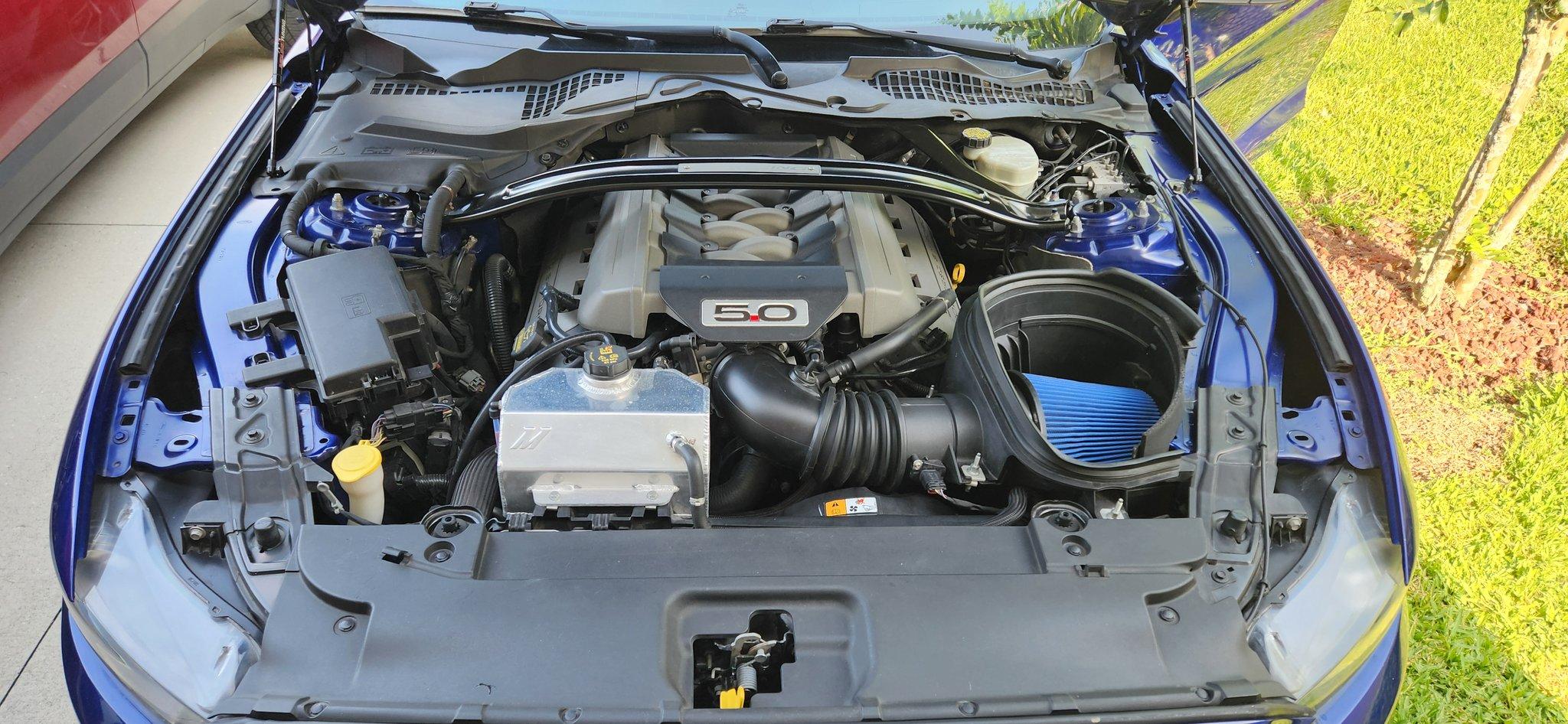

  12. New valve cover gaskets. This was a job and a half - getting to one of the bolts required disassembling what felt like a third of the damn engine.
  13. New catback exhaust with blacked out tips. MBRP.
  14. New shifter assembly and shift knob.
  15. New air filter.
