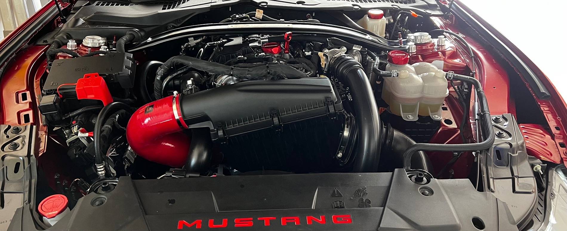

Yes, this was a self-install. I found it relatively easy, but I did have to slightly modify a couple of things and I am a former aircraft mechanic. It's not too hard, but if you have a friend with mechanical skills that would make it go easier.
Would those be modifications to the stock pieces or modifications to the EC part itself? That was also part of my hold up, I'd prefer to keep my mods as easily swappable as I can.

When I say modifications, I mean very very minor modifications. As in the tubes on the right side and the separator didn't exactly mount without chafing a tiny bit on an air conditioning hose. I would either move the location a little bit or just wrap it in some tape to ensure you're not chafing which can eventually damage a hose or tube. That's it.

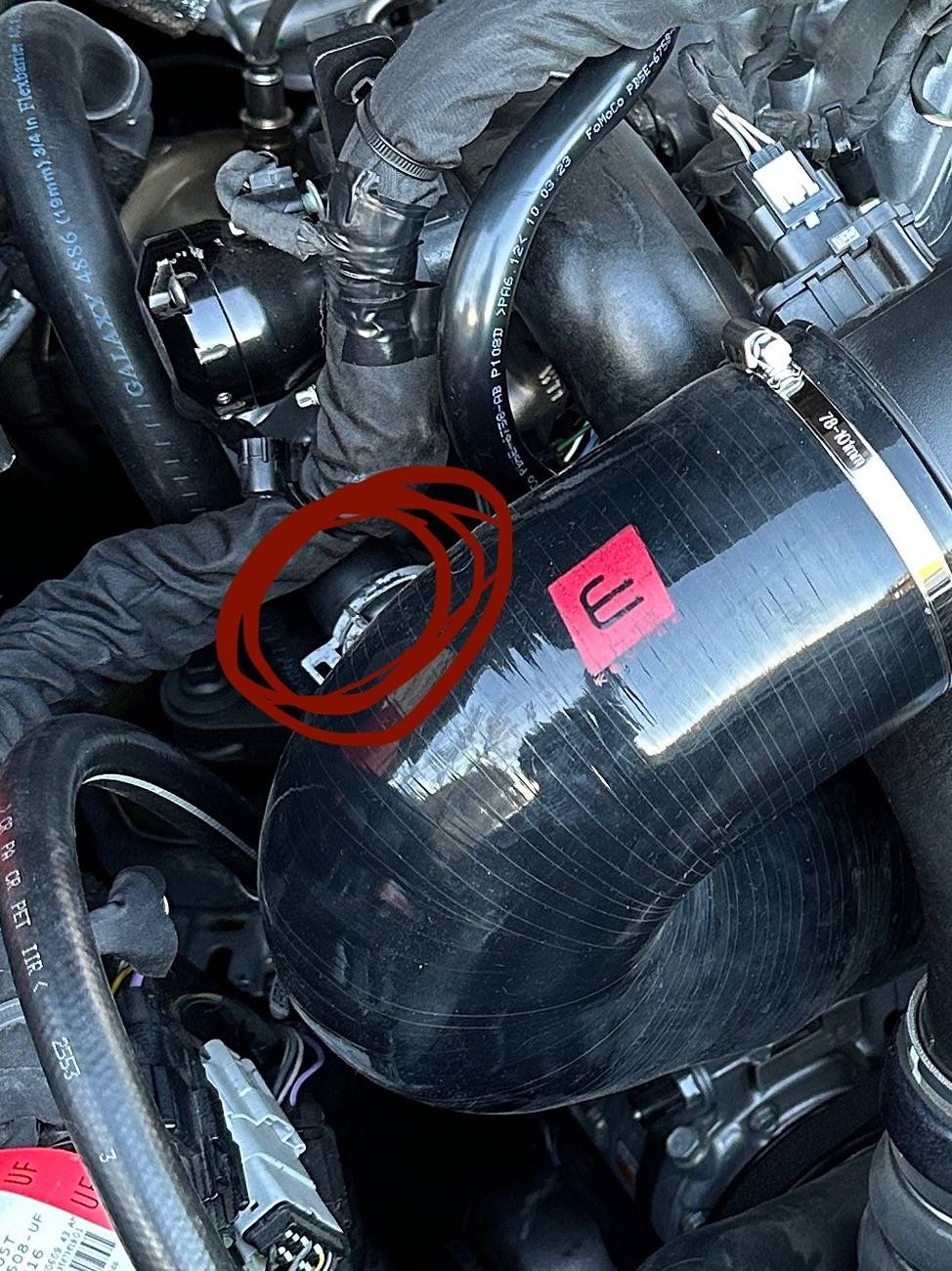

Was this a self-install, and if so how was the fitment? I want to try this myself but I'd say I am not very mechanically inclined, but I think attaching a hose wouldn't be too much of a challenge. My only worry is working it around the existing tubing and making sure not to lose anything when tightening it back down.
For me, the install was very easy, and i don’t have much mechanical experience at all, just modding various cars. It really is just as simple as loosening clamps, undoing hoses, etc. The hardest part was getting the circled (PCV?) hose off and back on. As long as u have some strong pliers and possibly a second set of hands, it’s no biggie.

I purchased the induction tube and (dry) high flow air filter from Eurocompulsion. The connecting points for the blow off valve and valve cover breathing tube were longer, requiring some adjustment to make it fit. The induction tube material and shape other appears to be high quality, very sturdy and has good insulating properties.
I didn't like the fit of the air filter so ended up using a K&N (they offer that option, too, when ordering).
I'm pleased that Eurocompulsion offers these performance products and hope they have a tune out in the near future.

Added the V1. As stated above, a little PITA with the BOV hose but otherwise an easy mod. Could definitely see the change in intake air temperature compared to the stock inlet.
