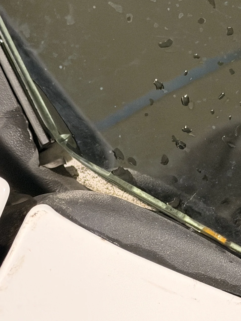

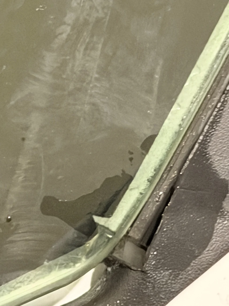

I just went to a ford dealer in ontario to get mine fixed.
After my visit for the BCM water intrusion recall, I noticed some gaps at the bottom corners of my windshield where the glass meets the cowl/trim. The cowl doesn’t look flush and the urethane is exposed, with water collecting there. I’ve attached a couple of photos.
Holly crap! Why did you even take the car back? I told my dealer I am not doing it anytime soon and certainly not before the Spring. If I were you I would have my lawyer drop the car off! Glenn
