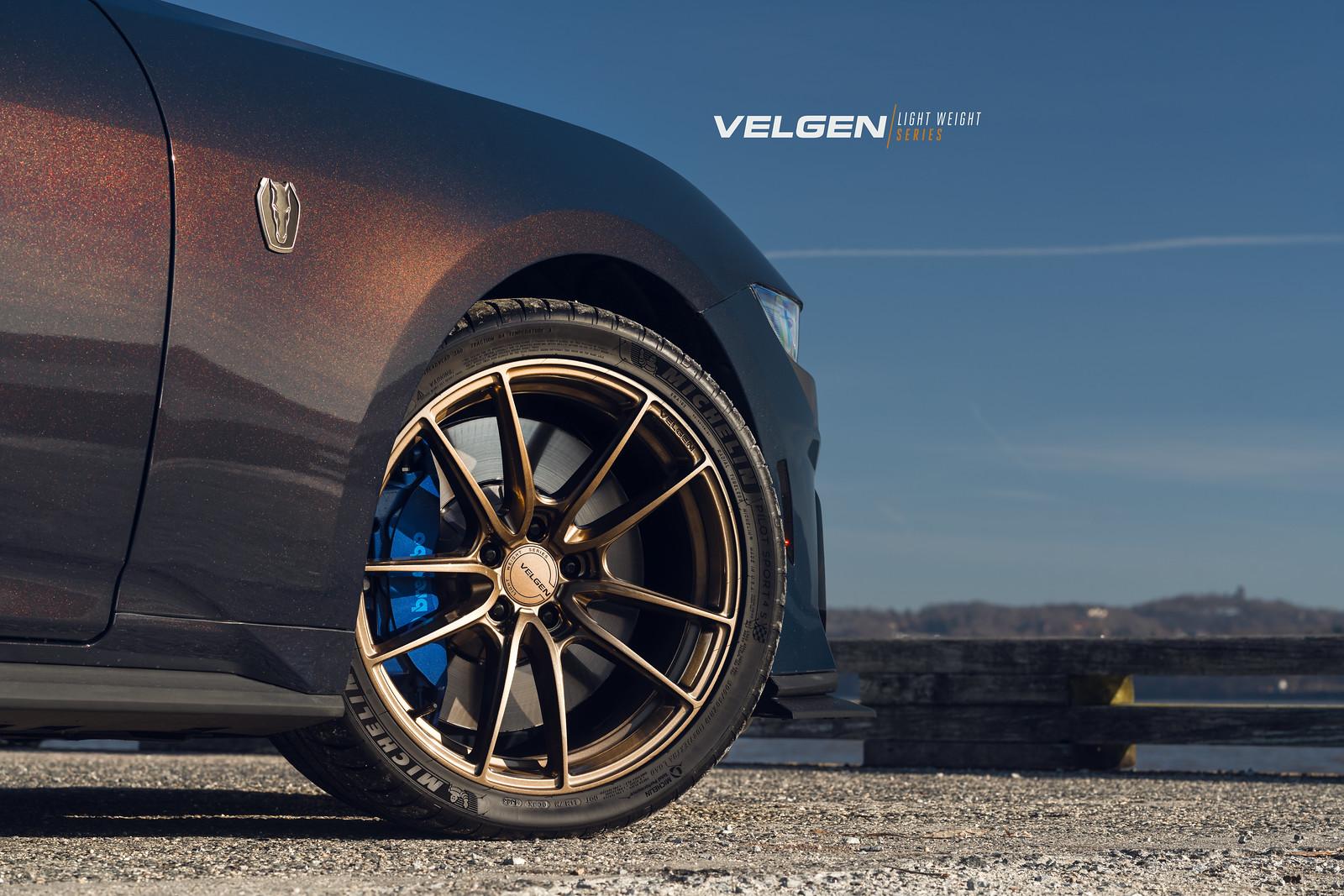

What’s the offset to get a 305 up front? Is it lowered? By the way it looks awesome

305s on a 10" rim?

I get ya...the wheels look great, not into the bulge on the front wheel. Michelin recommends a 10.5" minimum for a 305/30/19. Which I am pretty sure you knew.

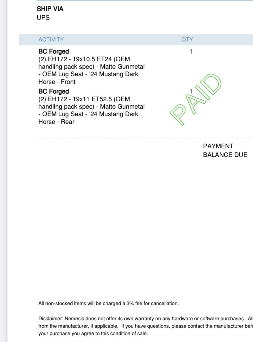

I wouldn’t necessarily say no one’s making OEM DH HP fitment. The companies making wheels for the masses usually use some off the shelf specs that fit several applications; better bang for the buck I guess. If someone wants OEM DH HP spec wheels from an aftermarket source, they would need to seek out companies offer custom offsets like BC Forged. I’ve got a set on order at this time.
Love how you blocked out the price!!! I cant wait to see it.
