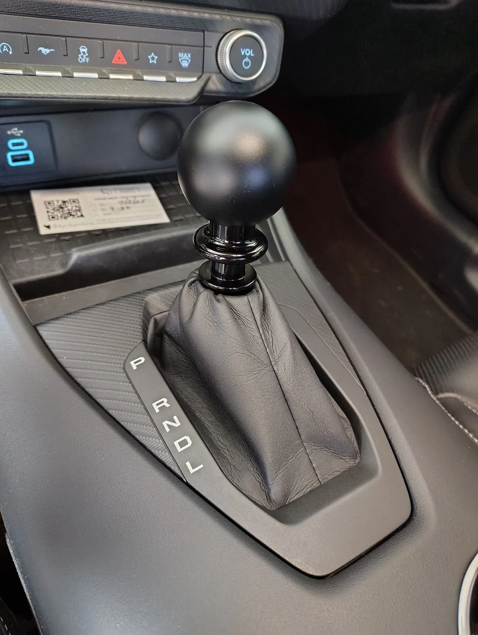

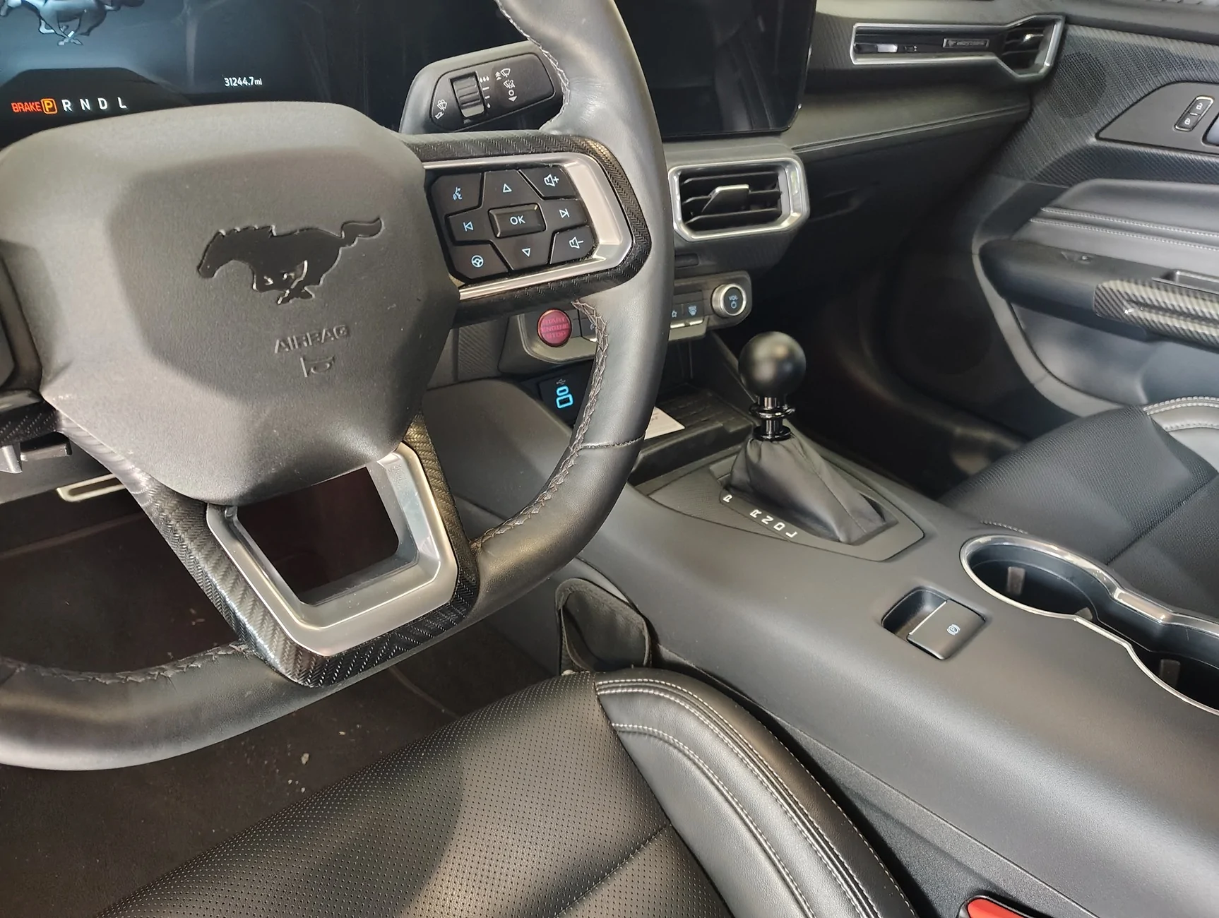

Billetworkz Matte Black Automatic Shifter
Value:
6/10 (bonus +1 for sale) - I paid $152.95 shipped. Shipping was decently quick given the holiday weekend. Excellent feel and shift experience. Heavier than expected in good way.
Ease of install:
9/10 - Very easy install. Worth reading advice of those that have done it on a S650 due to flimsy clips and easily lost screws. Making the stock shift boot sit properly on the retaining collar of the Billetworkz knob isn't the easiest, but not horrible. I didn't invest a lot of time on this round as I'm waiting on an OEM manual shift boot assembly. LOVE that it's set up to cause no irreversible damage and can be put back to stock easily.
Overall:
8/10 - This is much more of an aesthetic and quality of experience product than performance or maintenance. Obviously a well engineered and manufactured product. Very tight tolerances and good fit. Now that I have it, it would be one of the first interior mods I recommend to new A10 Mustang owners. Had concerns about knuckle shifting, but it's fairly natural once in hand.
S650 Mustang DannyJ7's Ecoboost IMG_20250903_110704391_HDR
S650 Mustang DannyJ7's Ecoboost IMG_20250903_110700066_HDR
Follow up after a few months of use and ownership. The shift collar tends to make some rattling against the center shaft while driving. A bit of grease applied with the shift ball off, both on top, and below the collar seems to have resolved the issue. Better done before instillation for future buyers.
