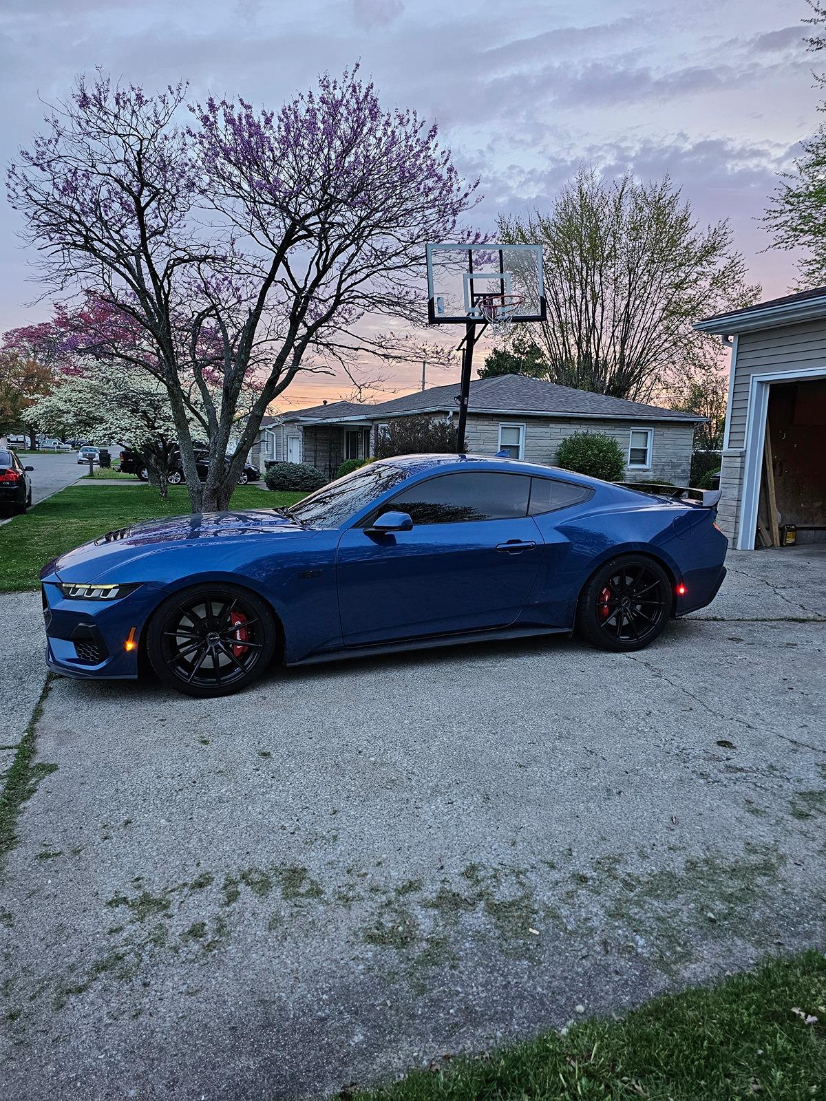

Shouldn't be an issue, that's about .5" shorter than the stock pp 275/40s. For reference here's my HRE setup on 285/35 and 315/35. About 1.5" taller than your proposed setup
S650 Mustang Correct tire width for s650 lowered 20240420_191218
Edit to add: stock magneride suspension

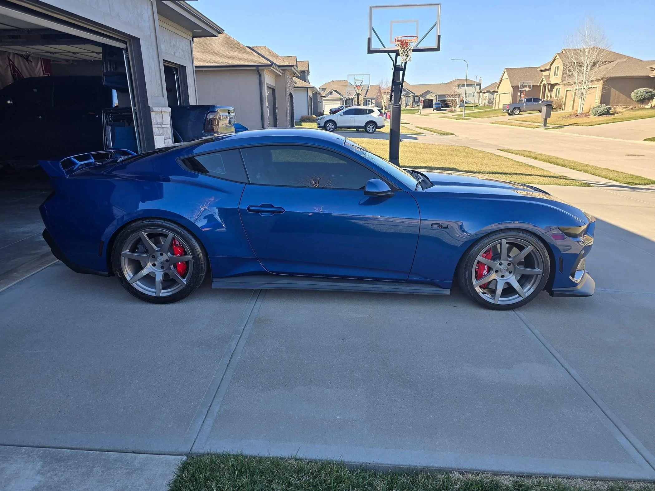

Here is mine with steeda magneride lowering springs.
275/35R20 20x10 35mm offset
305/35R20 20x11 50mm offset
S650 Mustang Correct tire width for s650 lowered 20240404_170603

Those look nice the finish looks good against the color. How’s the ride quality
Pretty decent, I went with this setup specifically because it was the same size tire wall as my 275s.
heart eye emoji!!!! this looks great !

How’s the alignment? Camber ?
I didn't keep the alignment printout because it was pretty close to being within the green on both sides for camber. I believe it was green on the driver's side and passenger side was 1/10th of a degree outside of green, so in the yellow. I've tested it numerous times driving it and it drive's perfectly straight. Good enough for me 😁
