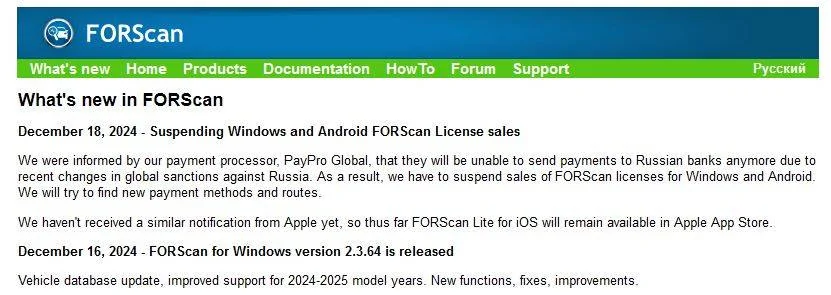

The cool folks at forscan took my debug log, tweaked, and forscan now works to write to the bodycm!
Tested a trial build yesterday, wrote about 20 times when trying to get around something, worked great.
Apparently .64 will "be out soon", with those changes. Good times.
